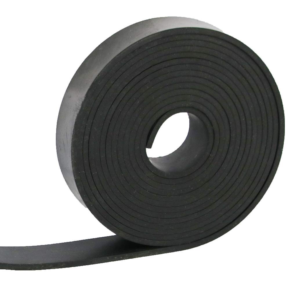

additionally, @b264 what do I look for to find the thin rubber you used? seems like the best way to avoid water soaking through the deck.
i do actually coat both of these with hot glue on on the inside of the enclosure. It will keep water ingress from shorting things.

I use this but it’d be better if you could find actual latex (not neoprene) that’s thinner than 1.6mm (1/16").
Might be even better if you could find a source for 0.8mm thick polyurethane sheets. @RipTideSports
Yes, same as this:
Except I use West System 650 epoxy or RTV silicone. On the inside of the enclosure.

McMaster has 40A durometer latex strips/sheets down to 0.006” thickness.
McMaster has this too. :slightly_smiling_face:
