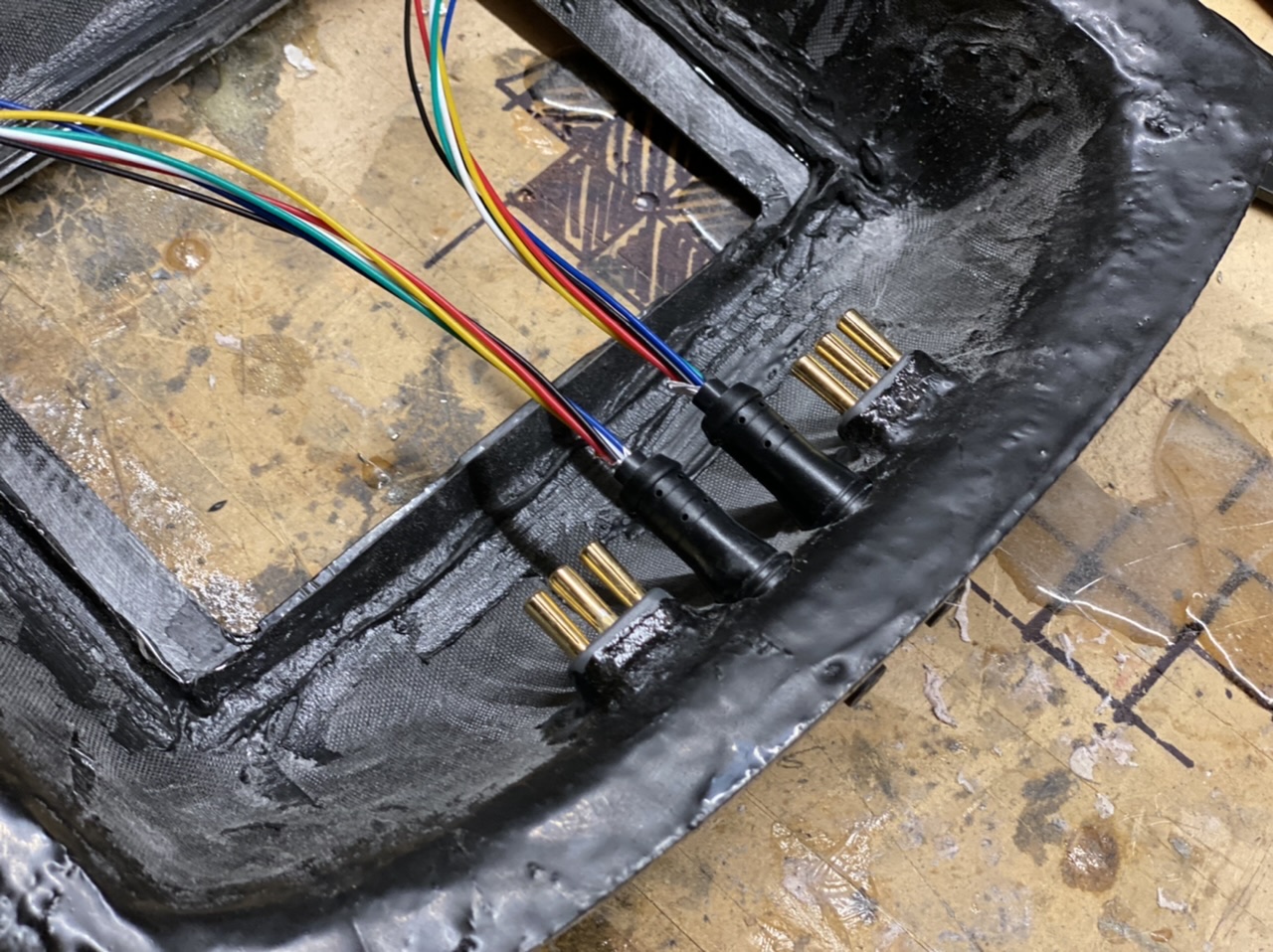

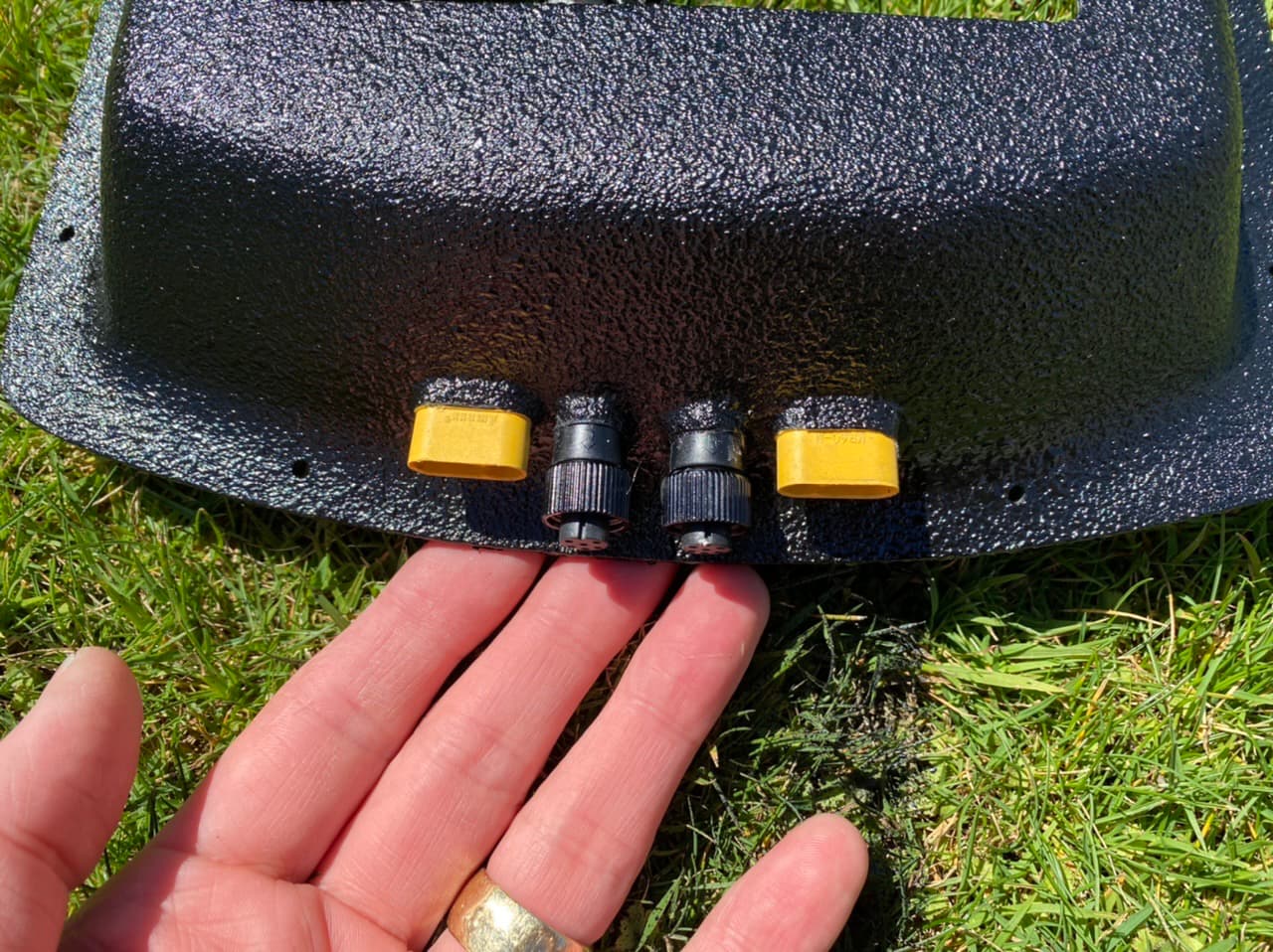

Did you use cable glands for your phase wires?
in the first pic yes, on the bottom 2 no
And they didn’t leak? I’ve never used them before and I’m thinking of adding them to my esc enclosure but not sure yet
They seem kind of bulky, and idk if I could run more than one wire through a single one. Maybe if you bind the bundle tightly with buytl or electrical tape it would work
I’m using TrueConn plugs and a fuse for charging as they’re pretty waterproof and durable. Qi is too slow and causes too much heat for my liking. I’m trying to figure out how to get roll start working otherwise I’ll be having it “always on” and just manually disconnecting the battery for storage. Been looking into single 9-pin plugs that I could use to replace phase wires and hall sense wires as the plugs could be waterproofed much better than grommets over the wires.
Epoxy around MR60 and ‘waterproof’ 6 pin connector plugs

This is really nice, basically exactly what I’m trying to do. I was worried about external MR60 coming loose with rough roads and vibration (it’s what I use on my motors too). How many accidental disconnects have you had?
