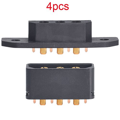

Closest I found is this
I wish I could find singular panel sockets and plugs that have 3 high-power pins and 6 data pins. I swear I’ve seen something that looks like a VGA plug like that.
What is that? It looks perfect
NZ$ 12.17 7% Off | 4PCS Amass ICM150S17PB High Current Power Battery Plug Male Female Bullet Connector 20A Parts DIY for RC Aircraft Drone
Only 20a phase current
I wonder if that’s 20A just to be safe or if it’ll start getting too hot over 25A. Would be neat to see the large pins tested to 40A or 60A

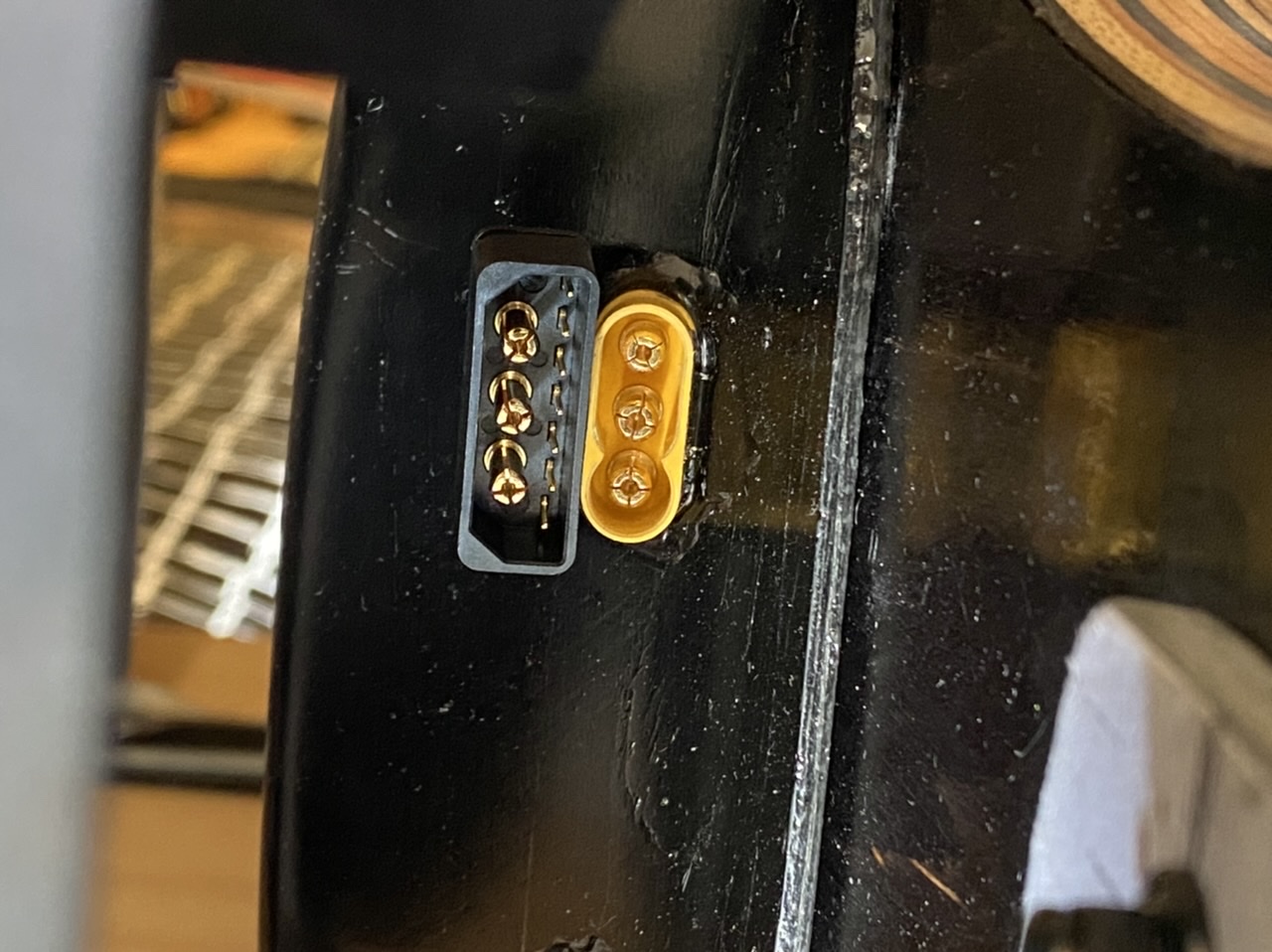

Well that pic is next to an mr60 and shows the size difference. They’re quite a bit smaller
They look to be about 1mm smaller, like the same size as the pins in an XT30
Says on the Ali page 20a, but 40a max. Prolly ok for small low power build.
Buy some and test them.
I have some but no time or desire to test them

They’re actual AMASS connectors too… I bet they can take more current than their rating
The back of the connector looks super weird to solder to though
Yeah, maybe meant to be installed and soldered on a pcb?
Yeah kind of looks like it, I wonder if it would even stick to a cable
I suppose you could make a motor connection pcb of sorts using these lol
I wonder if there is a beefier version
