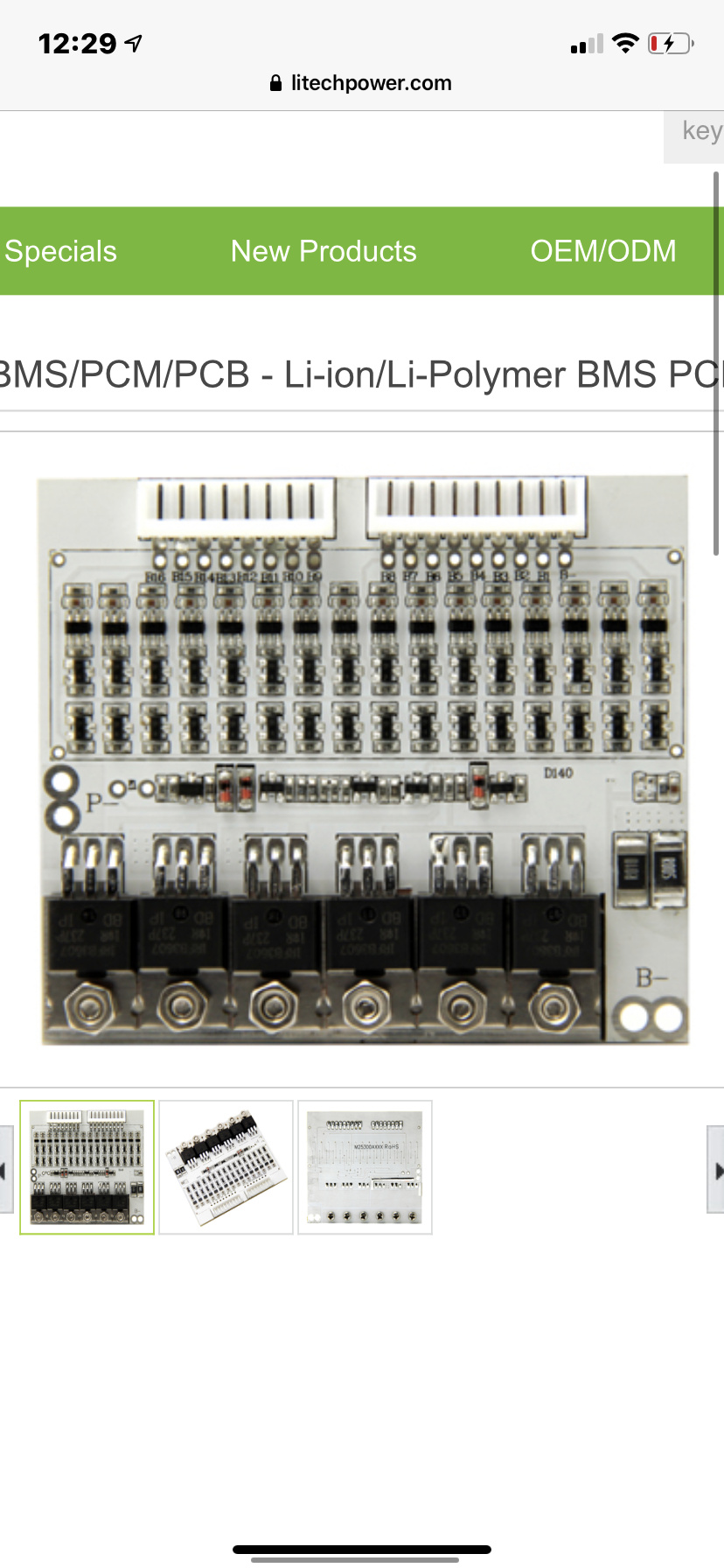

https://www.litechpower.com/ is your friend
They sell Bestech BMS and you can trust those
make sure the balance current is not blank
(like this one, for example. don’t get that one)
some models don’t have cell balancing and are current protection only
Try this one for up to 5A charging
and using this circuit
also 15A for the accessories (lights) circuit, if you want to put that there (is not necessary)
@b264 what about this…
https://www.litechpower.com/product-detail/HCX-D140LI12S15A_05.html#
I am stumped with its wiring though
Yes, the D140 also works, except charging up to 15A and no accessories circuit, so you would use this diagram
@b264 but the bms is split… how would that work?
It just comes with 2 connectors instead of one. The connectors come with the BMS, like this:
Hmm… so I just leave the rest of the wires because it has 16s?
I am sorry @b264 a little slow right now lol
They had a pdf on the site
On how to wire smh

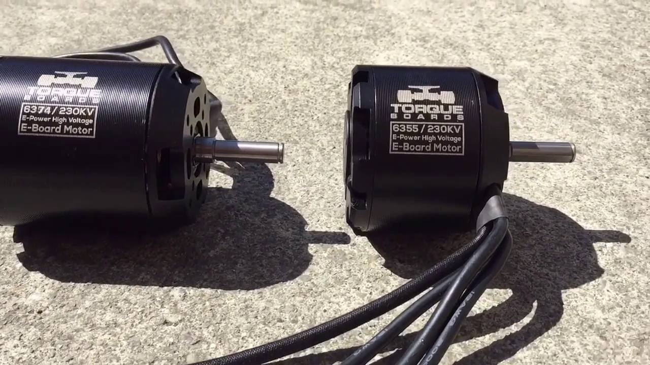

i needed this so bad too lol. In the end go a machinest to make new axles for me :rofl: :rofl:
You had a machinist reduce the diameter of the front of your shafts?
Those motor axles are case-hardened so if you cut them smaller, you would lose the hardening on that part.
I only know one place here with a lathe and I wouldn’t trust them for precision work anyways.
Perfect, thanks Brian!
Somebody willing to trade a single sk3 6374 (+ cash/ other stuff?) to 2x 63xx Motors? (smaller ones) like this
