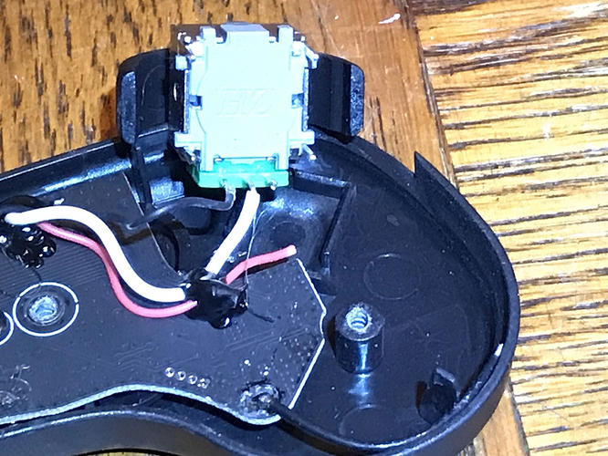

VX1 remote potentiometer wire broke.
When I opened up ~50 VX1s to paint them and QC them, I actually had 2 with issues like this. 1 where there was just not enough solder in 1 of the connections, and another just like this where half the wire came off during stripping.
It was in late 2019 though, and I haven’t seen it since. I check all my stuff before it goes out to weed out crap like this though.
I broke a wire when waterproofing and upgrading it to 1200mah. So I can’t blame hglrc.
Alcohol turns hotsnot to crumbly schmoo.

Today I wanted to commute to work and was already too late. On the street I found out the board didn’t work and after a short inspection I had to call a taxi which cost me almost as much as a new VX1 and I was still 20 minutes too late at work…
After work I opened the VX1 and found this
I found the reason why this happened, when braking all wires get moved by the thumb throttle which is very bad.
After opening a brand new VX1 (which I got yesterday) I recognized that the wires are routed like it should be so the thumb throttle can’t touch them
It seems it depends on the worker in the factory how the wires are routed :crazy_face:
Weird, in my case it’s hard braking without white wire.
Today before work I was jumping in dirt park with this VX1 remote and was just lucky that I didn’t eat dirt due to unexpected hard braking.

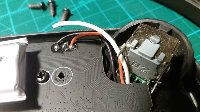

hmm. interesting.
good observation on the wire routing. I opened up the other 4 remotes I have. One of them, which i previously had troubles with strange hesitations.
had the white wire break off the pot with just a little stressing. so i fixed it. need to get my leg to heal before I can test and see if it fixed the intermittent “hesitations” issues but preliminary testing it didn’t reproduce.
I ended up ensuring the wires were routed well and hot gluing them there*.
* too impatient to wait for the neutral cure silicone and I just played iwth some IPA on some other hot glue to find it does work pretty well at getting things apart.
@fessyfoo Thank you for this thread. I went in today to inspect the wires, tuck them in, and put a dab of hot glue on the solder joints. Surprisingly, they looked very fine but I needed to be sure.
I also put a dab of hot glue where the throttle wheel slots into the potentiometer as it had become a bit loose after dropping it a few times. Good as new now!

diffferent FLIPSHIT VX1. I had checked the wires and glued them in place. but unfortunately not at the pot. and it broke off there.
I’ve had 3 different problems today. 1 is now blamed on flipshit. the other two boards issues may also be… I need to get myself into and comfortable with some other remotes. :frowning:
when I fisserated my VX1 I re soldered all of my connections with good quality wire, directly across the PCB and secured it on the top of the PCB with E600 after adding a bit of strain relief… I didn’t like the potentiometer/wire connection either so I routed the wires back under the PCB near those 4 points to the POT with plenty of spare wire…
Yeah. under is probably a better idea.
what gauge wire did you use @kook.
aside. I think after inspecting this one I didn’t leave enough strain relief with my glue job. so I basically am the maker of my own failure.
20-22ga whatever size is similar… I just used some good silicone wires from my quadbox stash of stuffs
if’n you have a 3 wire servo connector in your bag of stuffs… 4-6" should be more than plenty to fixerate your remote
