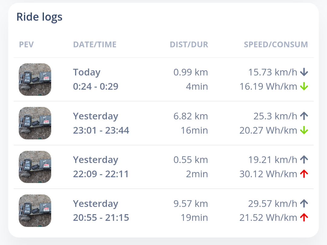

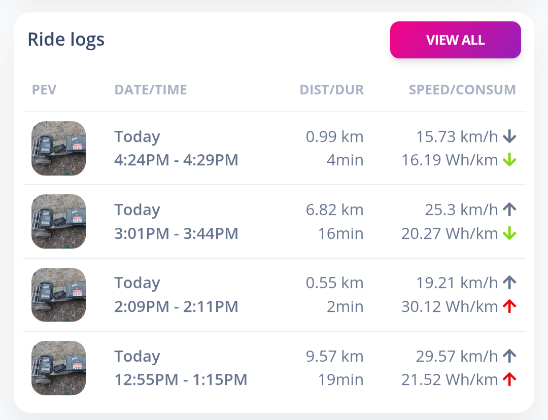

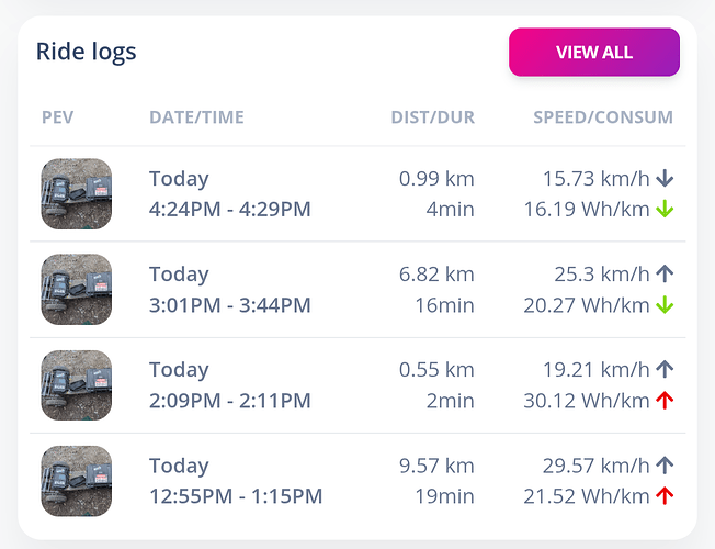

I’ve noticed the times on my uploaded rides are completely incorrect. All of these rides happened today.
The first one was around 11-12am and the most recent one was at 4:24pm
Edit: I was dumb and couldn’t find the time zone setting, then it took me forever to find Pacific Standard Time.
Fixed lol

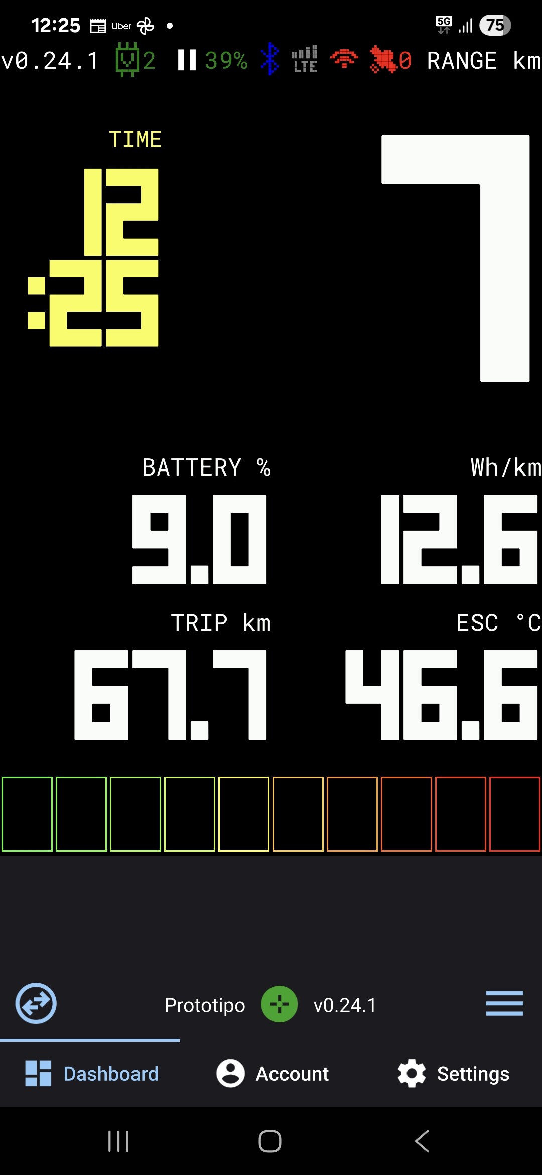

@rpasichnyk hey guys - today i rode 67km, but only 2/3 of the ride were uploaded. Missing the third one. It did failed to connect to wifi couple times…i received a bunch of Mongo db errors as well. But now, it says it synced it all, but big part of the ride are missing.
Screen shot showing trip of 67.7kms:
Only two ride logs uploaded (missing 1):

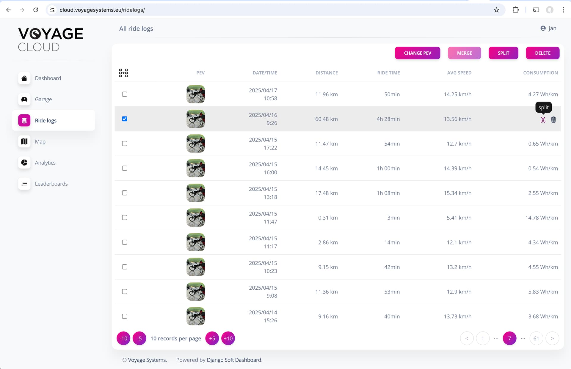

In the Cloud, the merged ride logs can now be split. This restores the state before merging. A useful feature if you make a mistake. Also, in (the extremely rare :innocent:) case there’s a bug in the merge and the merged log is rubbish, you can report it to us and the logs can be re-merged once the bug is fixed.
A short demo here:
https://www.instagram.com/p/DKHoo5whXew/

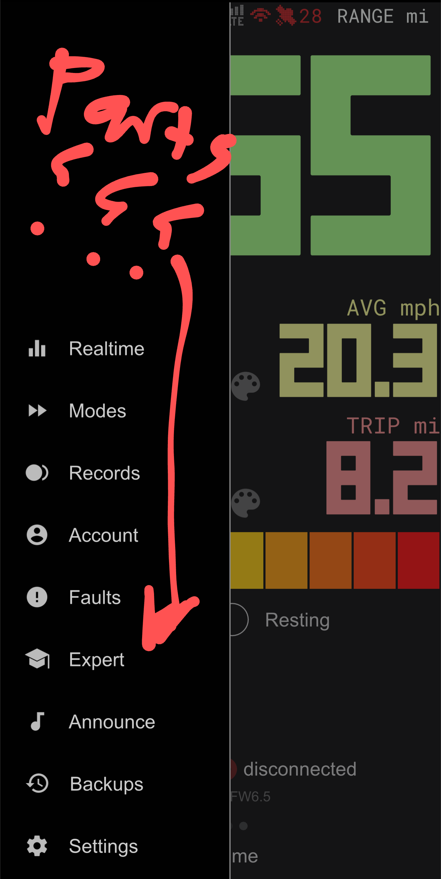

Perhaps related… The “Parts” menu disappeared from my Metr app a few days ago. What happened to it?
I’m on the Android Metr app v4.29.15 updated on May 22.
I’m about to swap my bald tires & was counting on that menu for lifespan tracking. I rode a bunch of miles since then & am nervous about attempting an old backup in case I mess up my board odometer.
Also - the Voyage app doesn’t meet my needs yet because it’s not currently at feature parity with Metr. I use the “Announce” feature with my helmetcom on every ride to alert me of high speed.
Tagging @poastoast 'cause he feels the pain of missing Parts, too.
Voyage also had parts lists reset. This is affecting everyone it seems.
There was a bug with part list, it was not possible to add parts after certain amount. We fixed that, but it brought 2 new issues:
  • a new bug in Voyage Connect resulting in part list wipeout / reset (fixed now)
  • incompatibility with Metr app, this is why part list was removed (temporarily)
The plan is to update Metr app and restore part list functionality asap. Sorry for the trouble!
