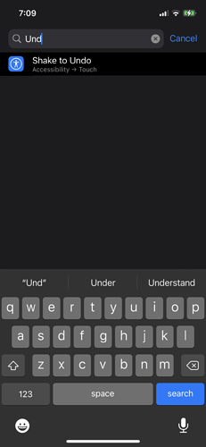

I’m using a NRF module with it successfully. Works great except for one thing.
Every once in a while after changing settings I will get something that pops up on the screen asking if I want to undo or cancel the action I just applied. I will hit cancel but it will pop up a few seconds later, usually after applying the brakes for some reason.
I have to close and reopen the app to get rid of the issue.
Any suggestions?
Is it the shake to undo thing from Apple? Think you can disable that in your iPhone settings. Screenshot would be helpful.
Every Apple device has a shake to undo, think you can disable that in settings
It’s not shake to undo. I’ll take a screenshot and post next time it happens. Thanks

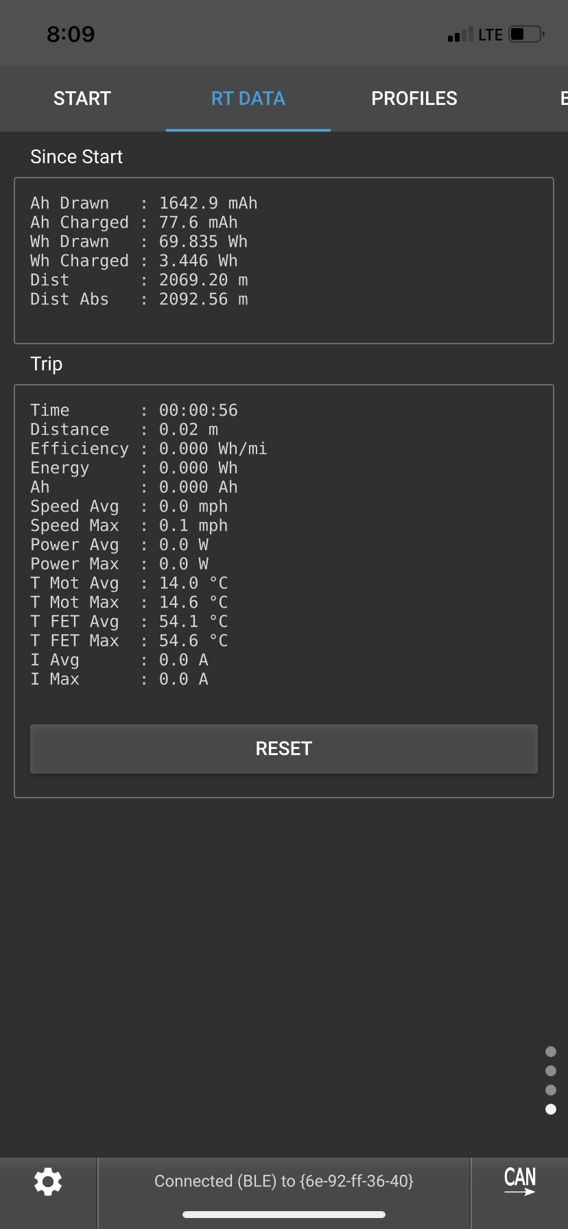

When I’m scrolling down to switch screens in RT data on my iPhone it always lags and presses the reset trip button… I’m not sure this is an app issue or my phone but thought I would mention it.
