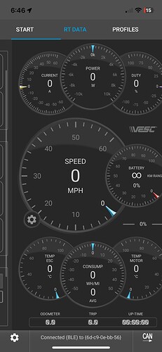

Hey Fellas, Having a problem with viewing realtime data.
I’m using a FS 4.20 with a NRF51 module installed on a escooter ( yeah, I know their reputation is not the best for several reasons but this was bought before I knew what was up).
Everything was working great including live data but it suddenly stopped working only when when I try to switch to live data. I can change settings normally but when trying to view live data the app becomes non responsive/ freezes. I have to kill the app and connect again. Again, everything used to work just fine with this setup. The live data freeze just started out of the blue yesterday.
Funny thing is I have the same issue with the Android version of the app so it doesn’t seem like it’s this app that’s at fault. Still, hoping someone can help.
Screenshot of the app when frozen.
Never mind my last post. I ran the motor wizard and the control input wizard and everything works again. Not sure what happened but I’m going to save the settings configuration just in case it happens again
