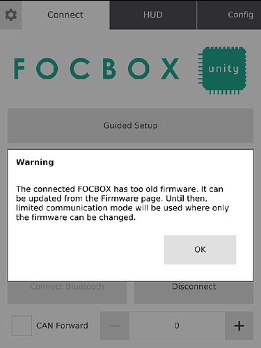

well that was fun, NOT… well you’ll remember my saga of yesterday an FW 5.01 over BLE…
FAIL but didn’t appear to brick the Unity… and the board still seemed to respond to the remote…
today tried to take board for ride… Unity app sees Unity BLE and errors out… board feels like 50% duty cycle while riding…
so I’m gunna open up the enclosure and bump to FW via USB… here I go… good luck to me…
EDIT: FW 5.1 FTW

I had to use the USB and newest VESC tool… but I have success now!
thanks all

Updated to Unity FW 5.1 from FW 23.46 in about 10 seconds. Seamless. Re-configuration was slightly more difficult (perhaps just different/unfamiliar or new) but really only a small learning curve.
