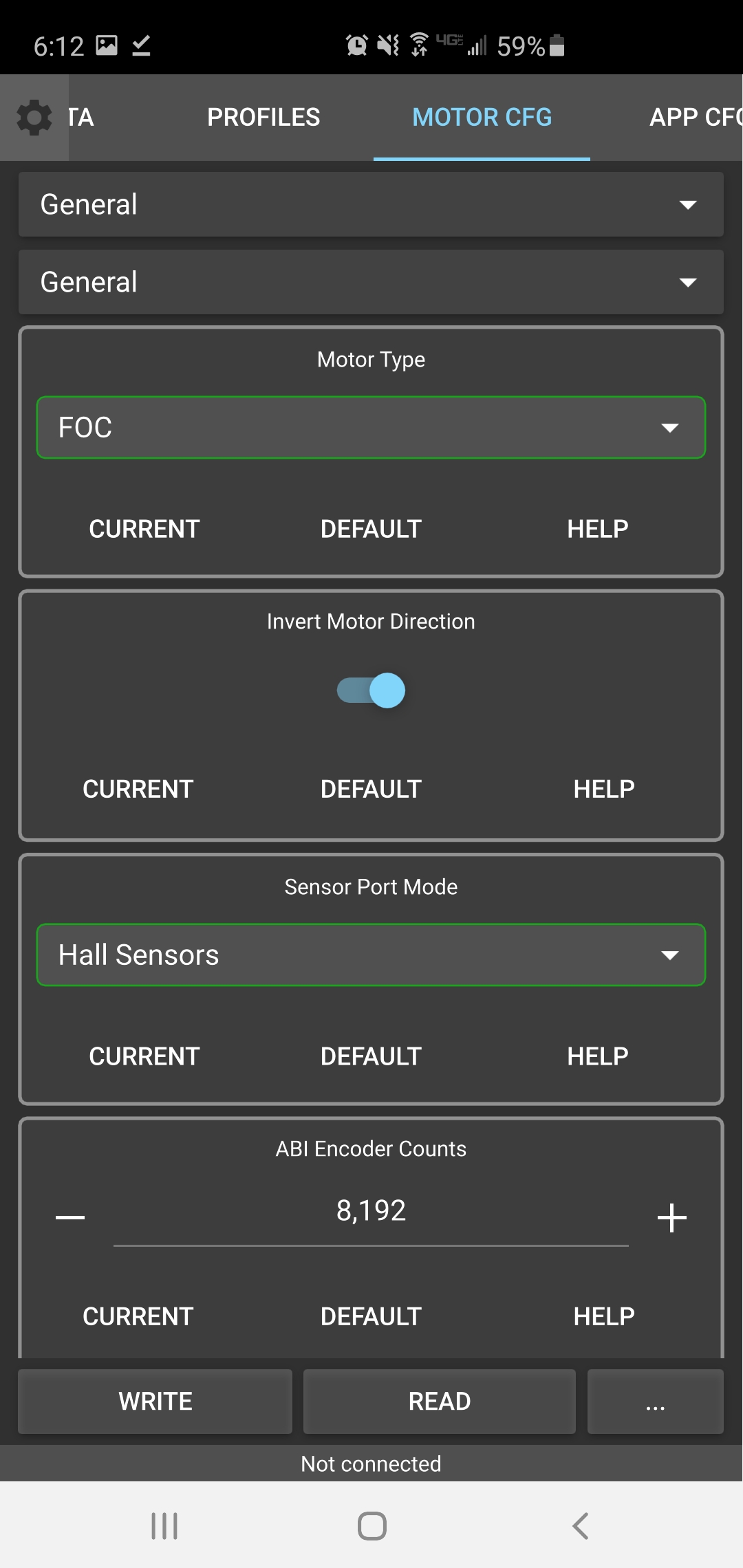

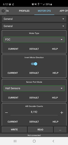

I get that Ben designed a workflow for adjusting settings across multiple VESCs, and im just complaining. So maybe a middle ground could be putting the “can forward” checkbox on every page (or the bottom bar with “read” and “write”) so I dont have to scroll all the way back over to the start page when i want to change settings for both VESCs.
I use them a lot, but I can understand you and I also wish to have that CAN button static on the lower edge of the screen. Best UX would be an icon for each VESC, high lightened when connected. You could jump from one VESC to the other.
Different strokes for different blokes, no problems with that. @Deodand do you think it would be possible to stick the “can forward” checkbox in the bottom bar of the app? I seem to recall mentions of an app/tool revision coming up, but maybe im misremembering (i do a lot of that).

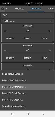

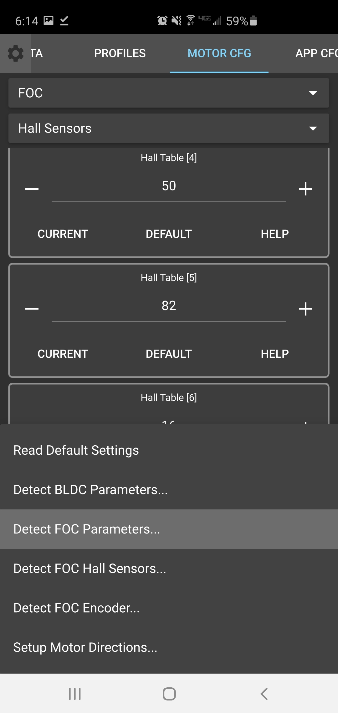

After you run the motor wizard do you need to run these detections again or is that part of the motor wizard? If not, I imagine you need to do them each individually by select sides of the dual esc.
It is designed to only run the Wizard and that is about it. The Duty Cycle CurrentLlimits have not yet been added to the Wizard, due to being a new feature. So you need to manually set the value for both ESCs
Ugh these definitely took some getting used to. You mentioned that you dont use the desktop Tool. It seems clear to me that the app was designed to be as similar to the desktop Tool as possible. So the way that everything’s sorted, and also the behavior of the wizards vs can forwarding etc. Makes more sense on the desktop tool for sure.

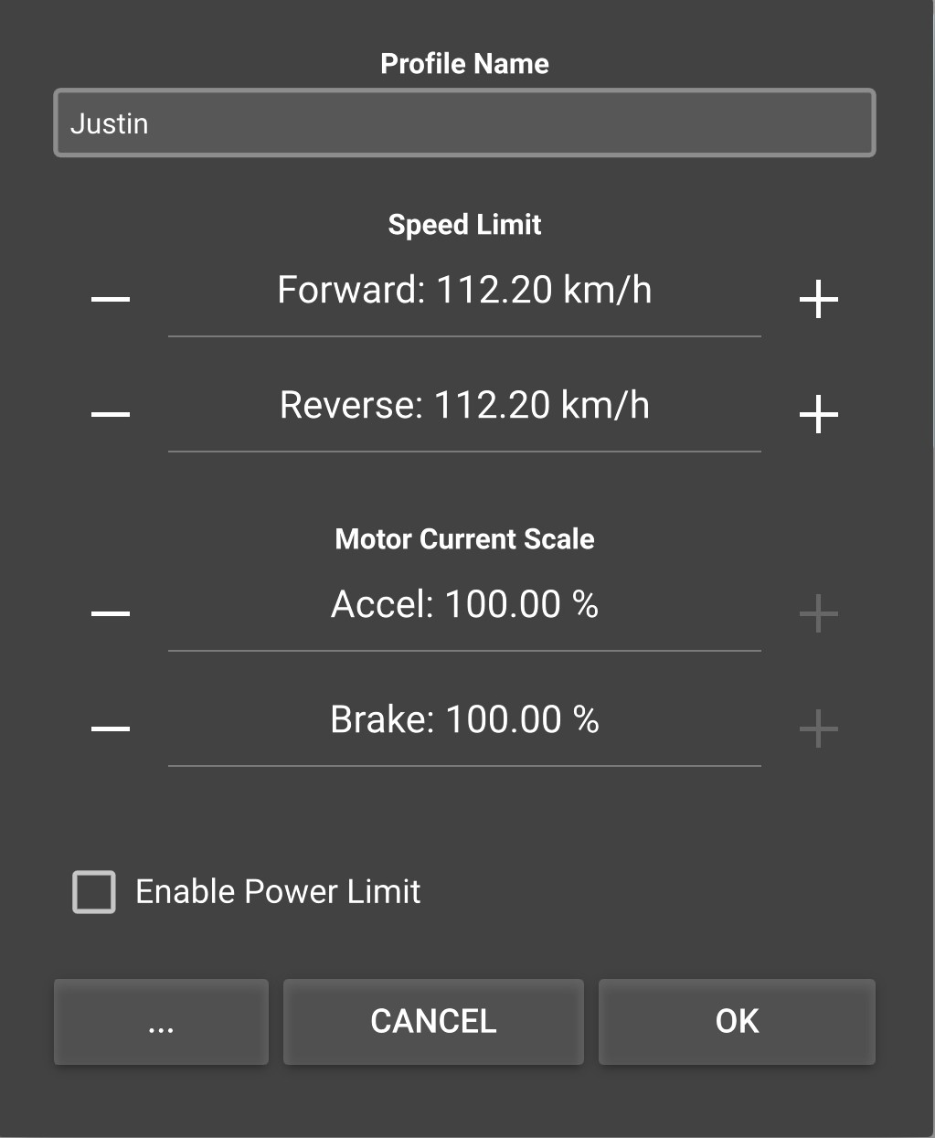

I haven’t gotten to play with making a demo profile for curious new riders but the ability to quickly.
The motor current scaling makes sense. 50% would be half the motor amps, half the accel and half the braking.
Does the speed limit scale along with the throttle curve set for that profile or is it a hard cutoff?
Soft cutoff via DUTY CYCLE CURRENT LIMITS.

I just made a test profile with speed limited to 35 kmh and 50% accel 50% brake. I noticed that on the bench it spikes past the limit and then slows down. I will test this on the road to see if it acts the same.
