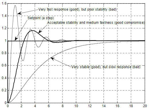

No but it is indicative that it isn’t performing exactly as I’d expect. Don’t take it so personally, I’m just here to provide feedback to the community :slightly_smiling_face:
This is just overshoot on the speed control PID’s similar to the dark line on the graph below.
If you care enough you can tune this out by adjusting the PID values but its a behaviour that you likely wont see under load (your more likely to see behaviour similar to the lower line).
Excellent thank you. Trying to see if I can tune it down enough to make a child friendly profile for strolling around in the grass.
It actually doesn’t use a PID controller for the RPM limit in the motor settings, its just a linear ramp off (just P controller essentially). Unloaded the board will overshoot the speed because the system is super responsive (since it’s unloaded) and the RPM estimator has a slight delay. So by the time the board detects it is over RPM it is already massively over since the wheels can accelerate so quickly. With a rider onboard it’s impossible to accelerate at a speed where a few milliseconds makes any difference.
