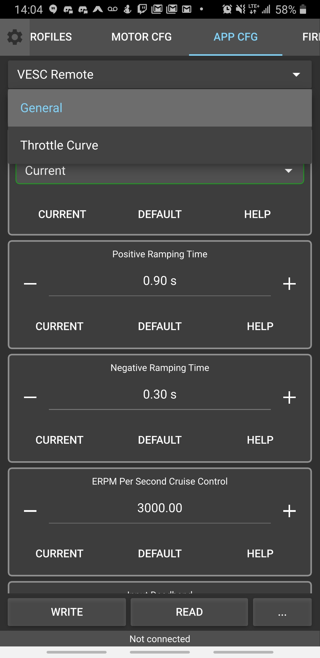

@deodand is there a throttle curve section I missed? I saw the positive and negative ramping time but no graph with sliders like focbox UI.

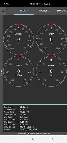

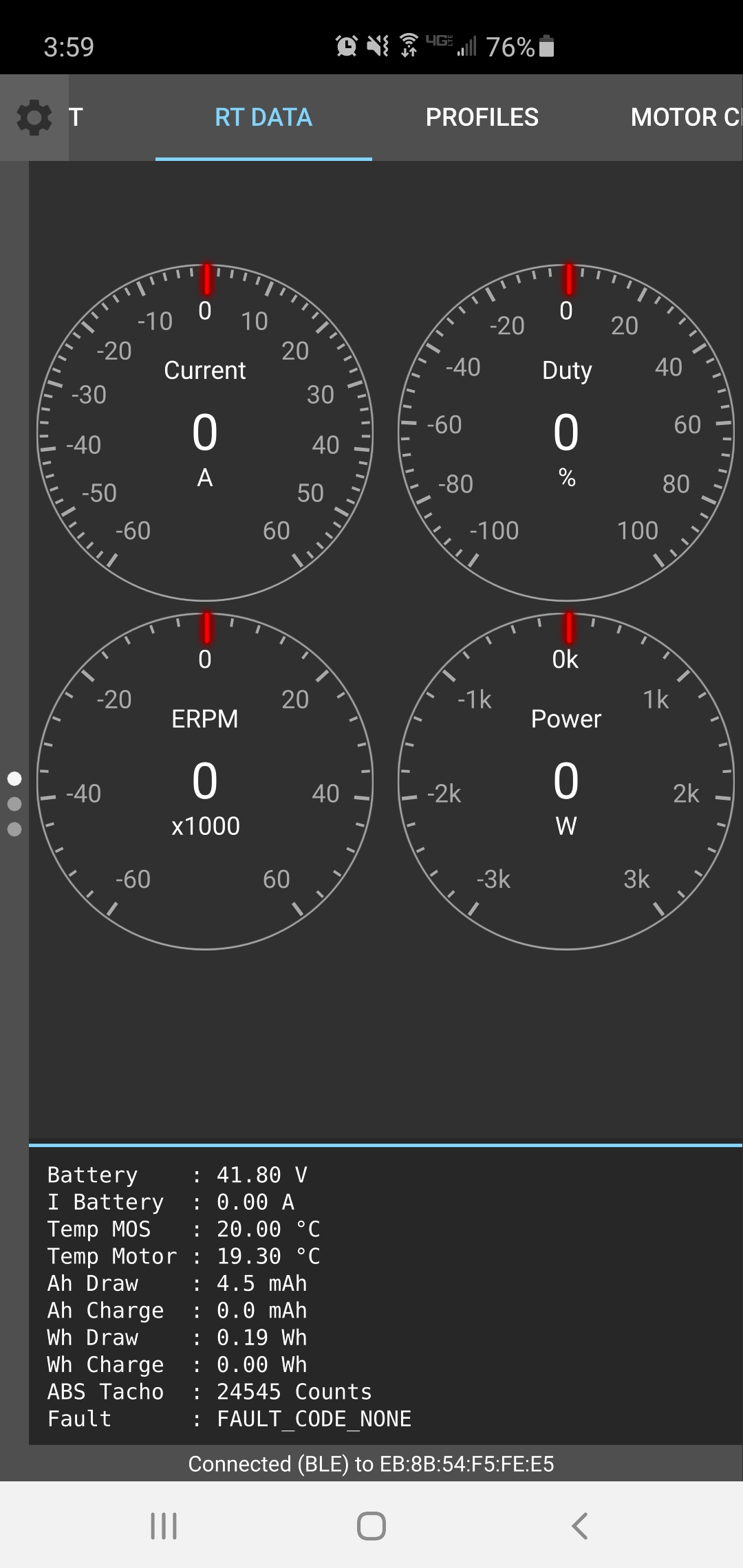

Temp sensors reading correctly
Click on the control type you want to adjust and then press general.
it doesn’t seem to give a visual representation of the curve if I remember correctly though.
Nope you want both negative tho, made that mistake once.

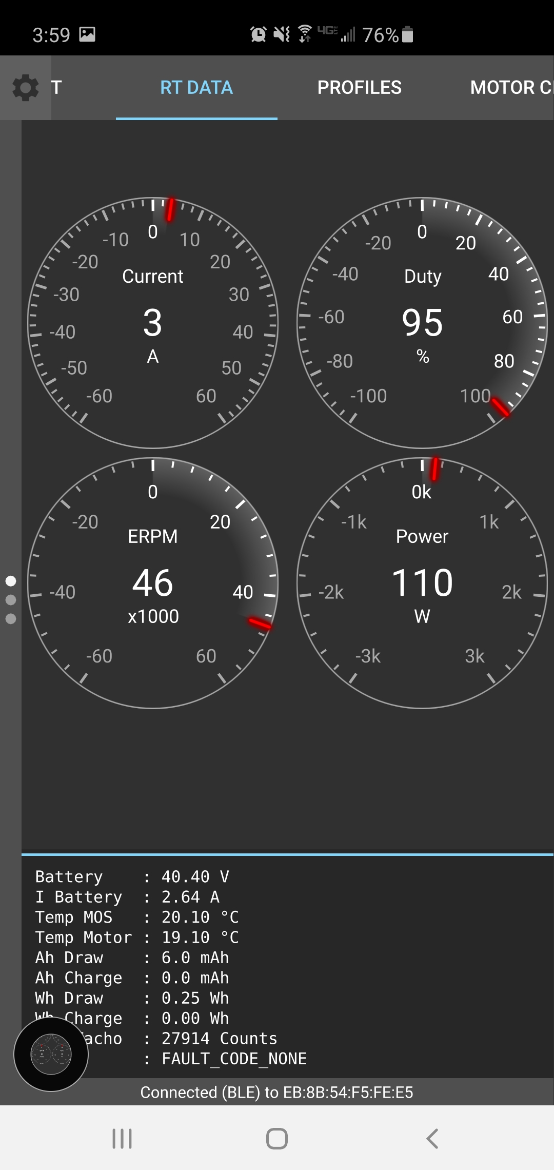

Everything set up mostly well, ride is going well but I get weirdness at full throttle. Feels like my motors can’t keep up with input. Ends up feeling like a shaky onset of speed wobbles. Motor detection results match my old ones.
Are you talking at max speed?
Yes
It will be under the same tab in the app also, and remember you have to set it for each motor using CAN fwd button

Found that setting in the vesc tool app. Haven’t touched the computer interface yet, how do I can fwd via the app?
START PAGE, CAN FORWARDING, BELOW THE WIZARDS
Thank you,
So I just need to activate can forwarding and it will automatically apply ALL settings to both motors? Or do I need to rerun wizards to apply to both motors again after enabling?
You scan, then activate and then change the same setting for the other VESC. Wizards and Profiles always consider both ESCs.Manual changes of settings are PER VESC only. So you need to tunnel to the other ESC and then do the same thing again.
