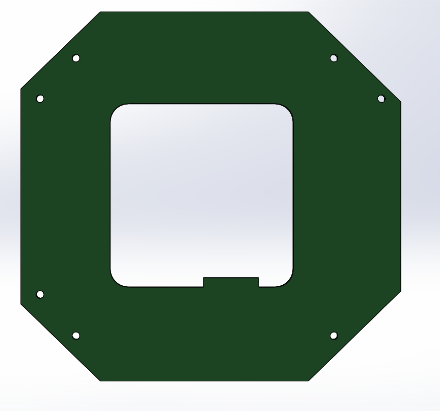

So this would be the main complex part to make.
forgive the terrible corner cutouts, I have no idea what I’m doing
I have some ideas for how to make the wheel be on a live axle (shaft) using a very DIY approach and how to make bearing blocks using a half 3d printed part.
too tired to explain will edit in here
Those corner cutouts could make it easier to machine. It may not, but it could, if you could increase the diameter of the smallest endmill needed to machine it.
Those cutouts don’t need to be nearly that deep I think I’m just not sure how to draw that exactly at the moment
definitely not getting a wrench in there haha so need to be a stuck nut or however you call it
Constrain the center of a circle to the corner, extrude a cut with only the part of the circle that’s over the material

Those inside corners are going to make that really expensive. See if you can design it without those. You can’t cut those with an endmill.
soory it was funny I have no idea hot it got like that all I did was add that square
