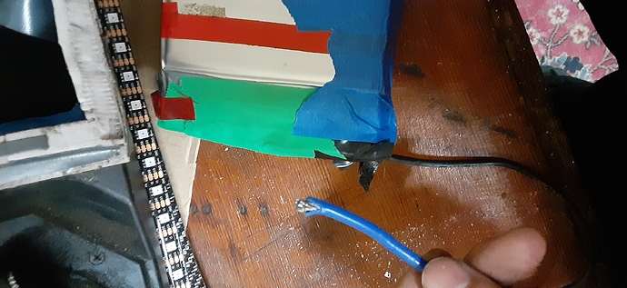

Oh thank God 0v out the battery my focer are oke probably
Hmmmm
ruh roh
The cable just broke ? All is fine ?
Shit solder joint combined with using vice grips on said solder joint causing it to crack off.
If the foil crimps were larger so I didn’t have to crimp on the wire that would be less of an issue.
Nothing real bad happened, look to the bright side !

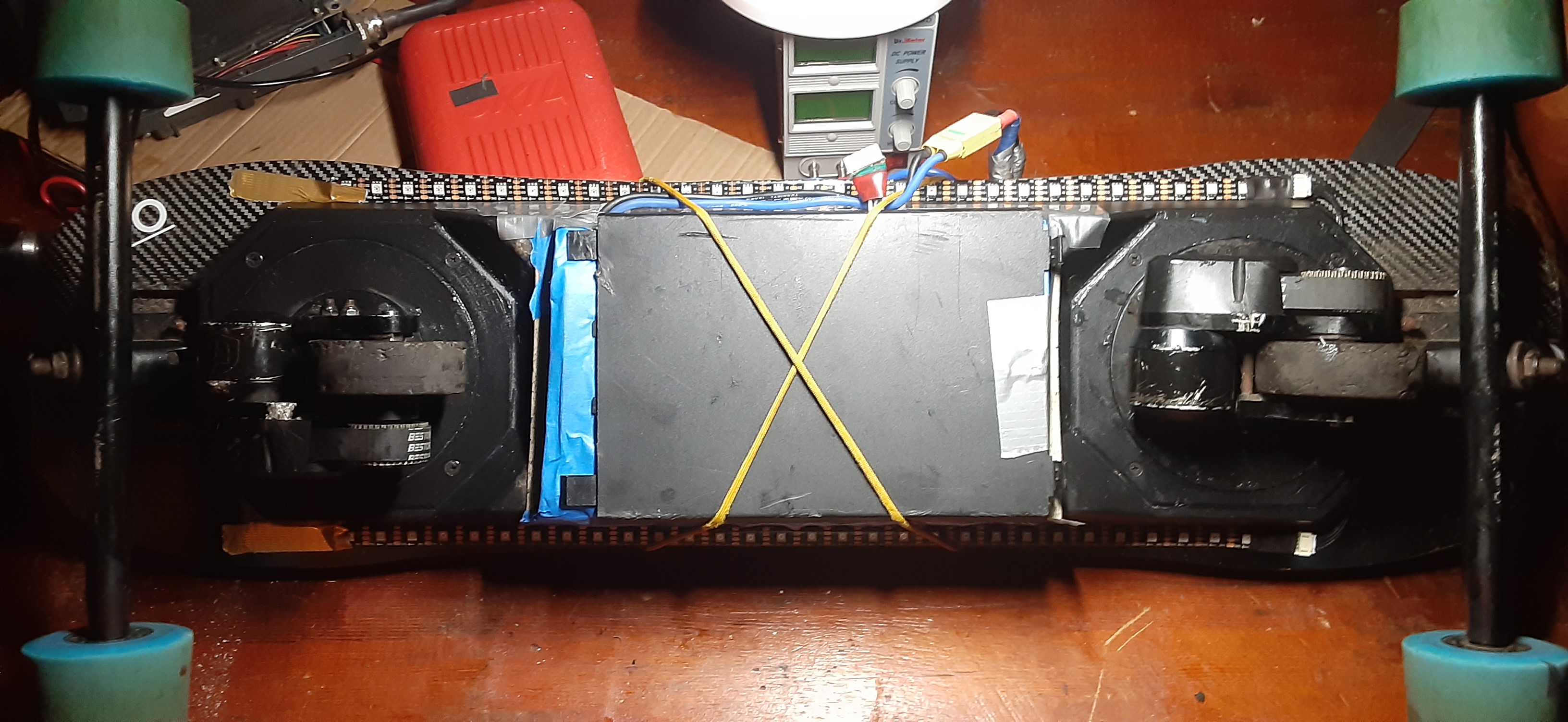

I really need to get the focboxes out of this and get in some cheap focers, in my testing it draws about 30-40A batt max per motor so they would be perfect.
Get some cheap 4.12, if you don’t want foc (or just stick to 10s)
Cheap focers should be exactly what I need. I do have some 4.12 vescs but I wanted to use them in an AWD esk8.
Could use them in it.
switched the vescs from ack to FW5 bc I don’t need to use hm10 bt module anymore.

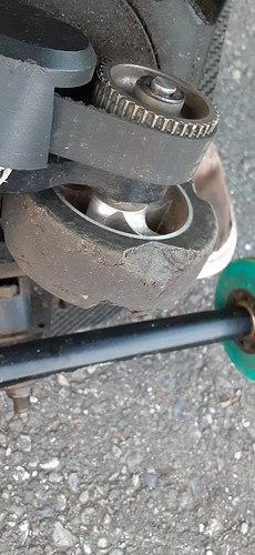

One mess of a lubrication and clean up job later she’s ready to rock a couple of more times.
Both the motors spin up on their own again! Looking forward to ride tomorrow, I also want to try running two 6S1P packs in parallel for 355Wh total.
