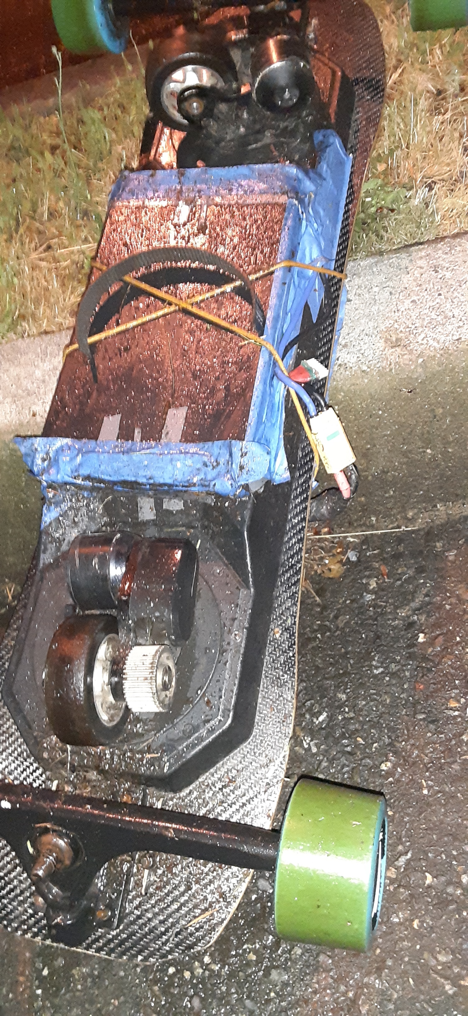

Oh and like my “waterproofing”?
It’s really just to keep the dirt from getting in.

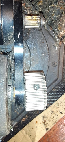

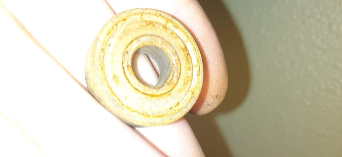

Bearing was seized… wonder why the belt broke lol.
Honestly didn’t know there was this loose grub screw.
