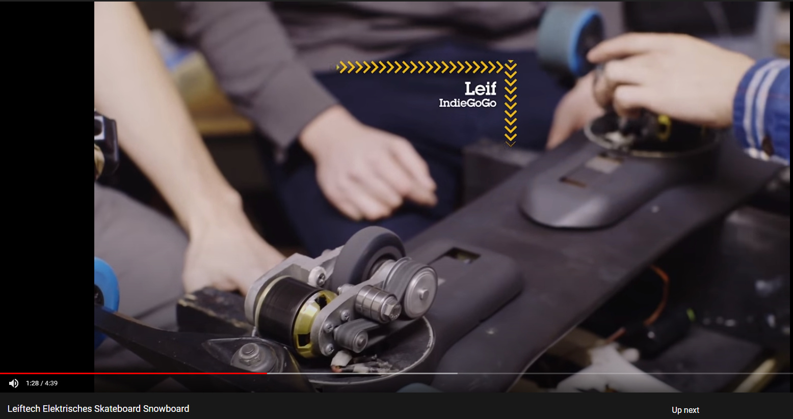

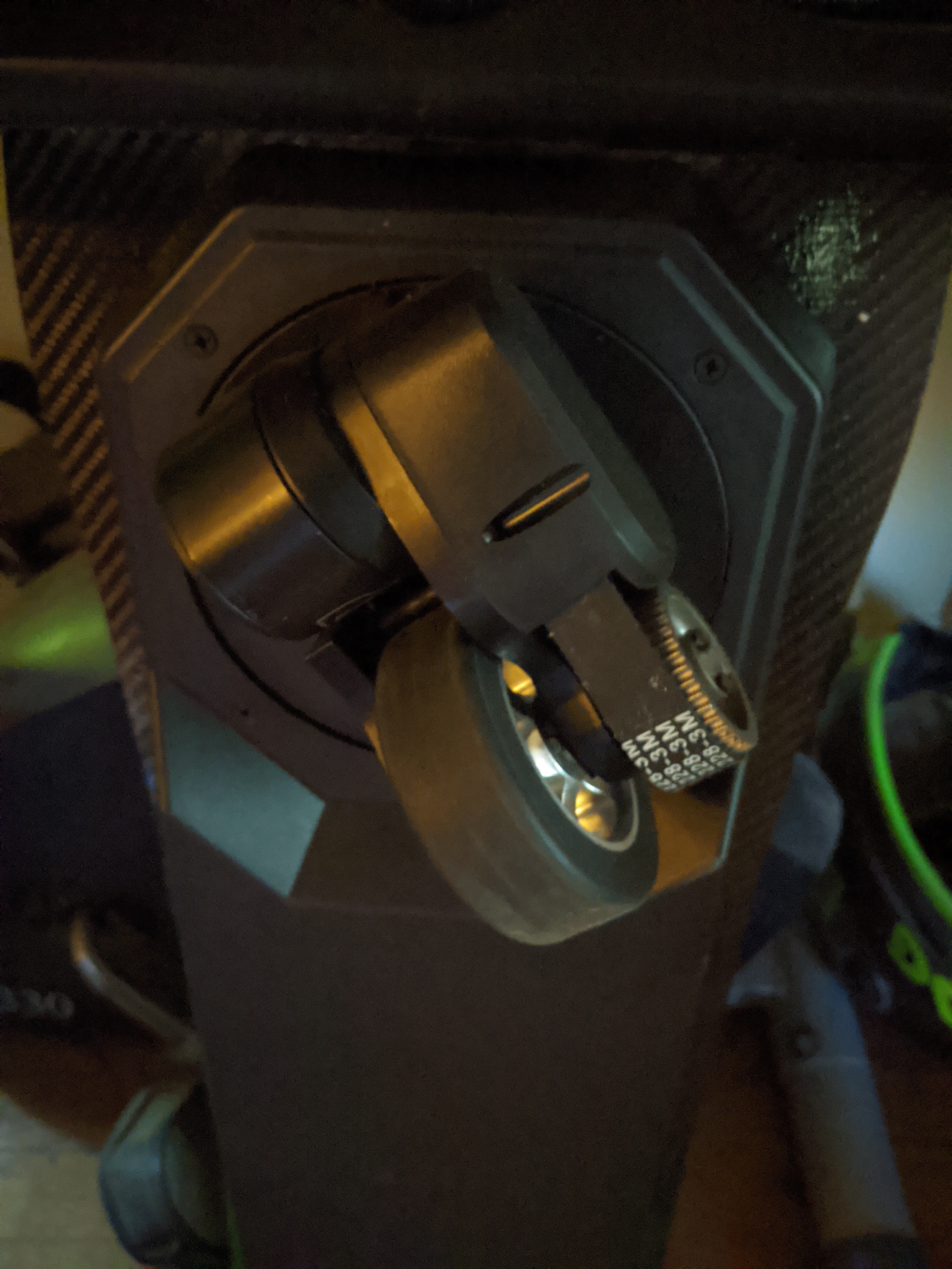

Leiftech prototype. Looks like with 5055s or something. The guard on both sides of the motor is nice.
Also in this video they have a different center wheel. Like the Freebord one but pink, didn’t think they had colors besides black.

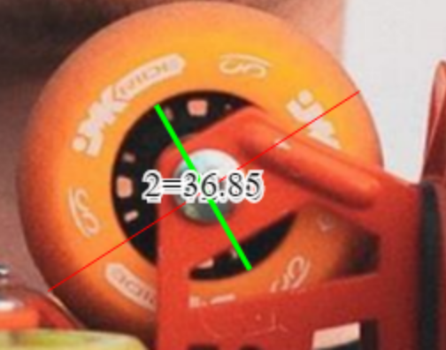

Looks like it would solve my wheel clearance issues, but I’m holding out on upgrading the current drive system before I figure out how to make my own wheel and motor mount stuff. Need to order the JMK ride wheels.

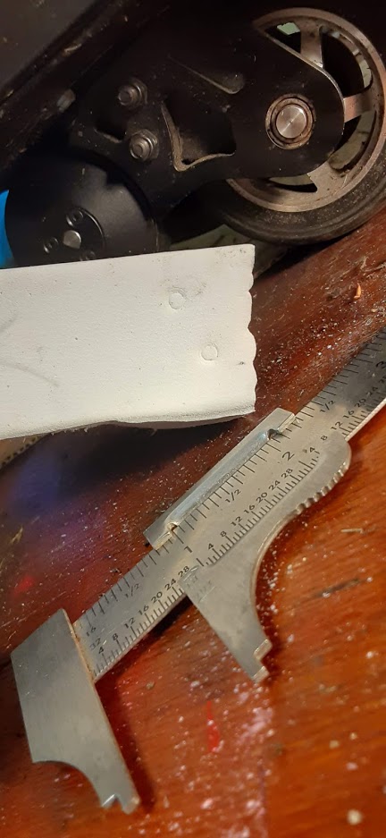

used my favorite foam to make an impression of the bolts then measured them, think the holes are about .125" by .5" apart. Not sure what size/thread the bolts are
Need someone to 3D print a pulley for these JMKride wheels. I believe a square bolt pattern will work I just need the diameter to put them.
better pic of the wheel hub.
never designed a pulley before so might need some help.

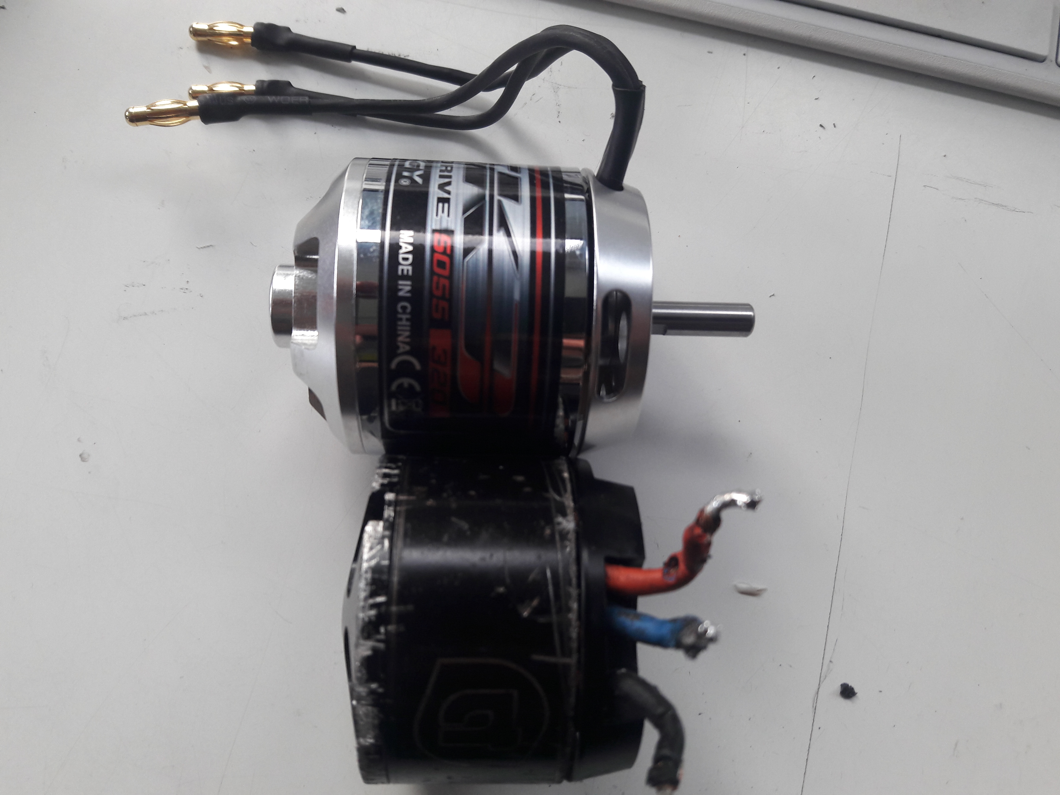

as i set up new motors today i was surprised to see that i run with 50A Motor and 35A Brake , so i told you wrong settings a few posts above
FJI i use very old vesc4 with FW 1.14, using BLDC, startupboost 0.05 , no cutoffs , align centerwheels in same direction and give her a little hip-push, then it runs fine

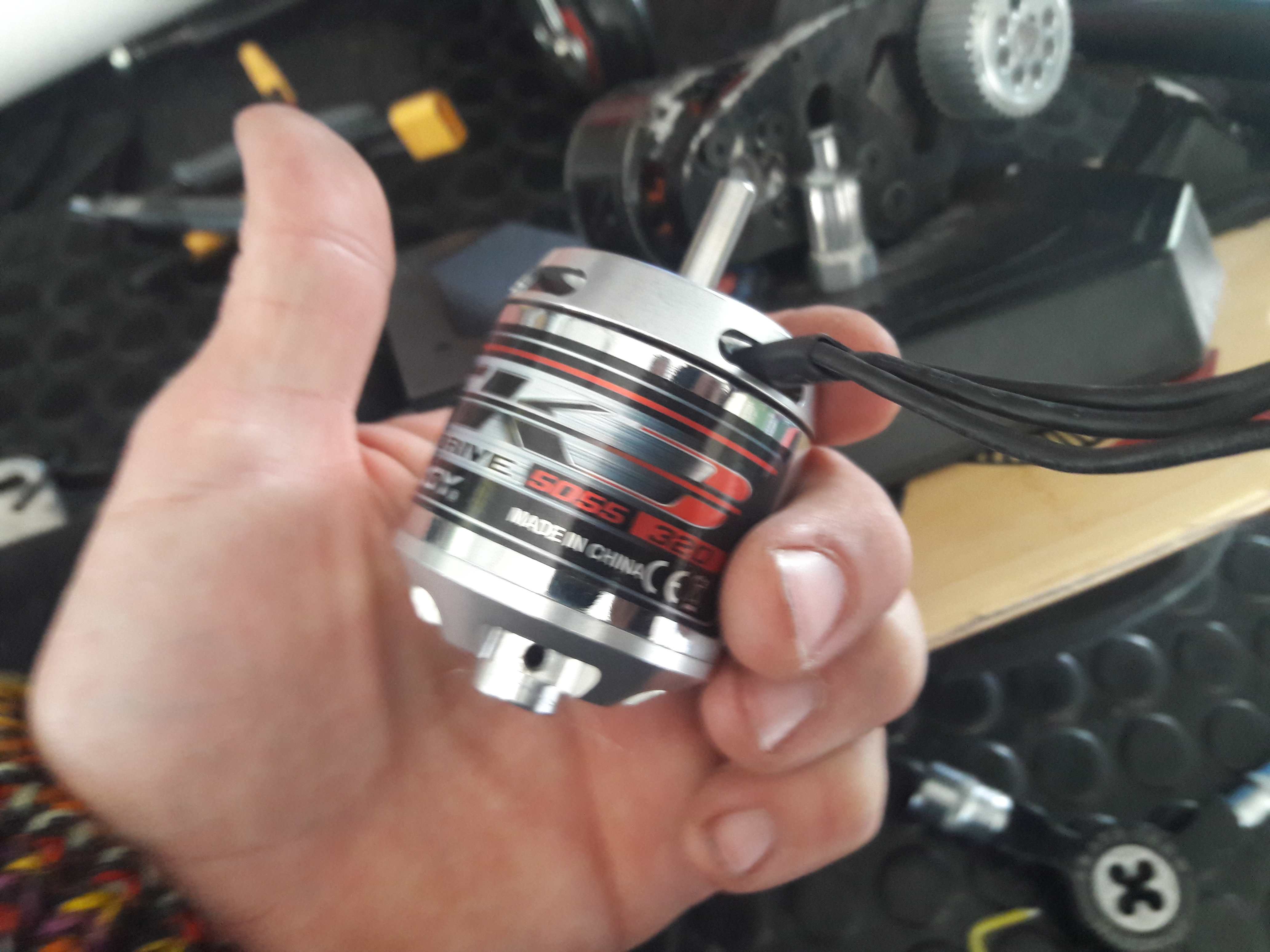

looking forward to test the sk3 5055-320kv tomorrow
cheers

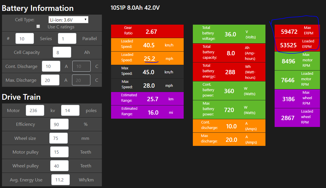

With that SK3 236KV the stock gearing seems pretty perfect on 10S

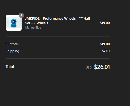

Probably going to buy these wheels to try out

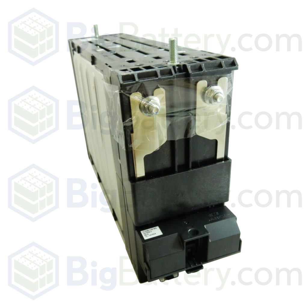

lol this would be a good battery for this… Although I would like to go 10S, which makes more sense with the upgraded motors.
Capacity: 27.2Ah!
Physical Specifications
Length: 11
Width: 3 - slightly taller than my current too tall battery, but it would still be below the motors or can top mount.
Height: 7
Weight: 14.25 meh
Could get 20 mile range, very impressive for $140.
$35 shipping for two, $315 total.
54.4AH Leiftech would be quite extreme.

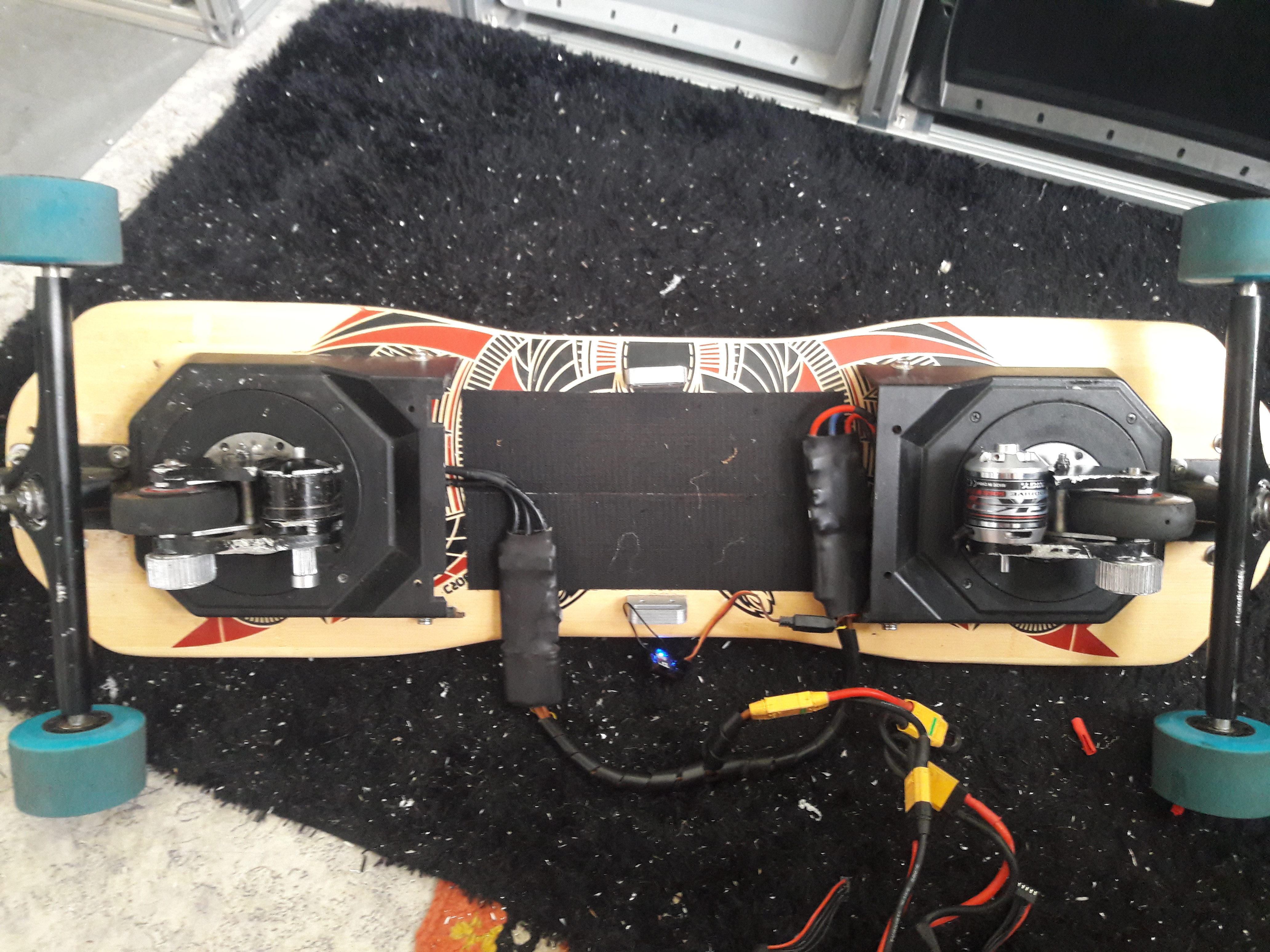

Yes sir, its been here for a couple of days. Had to do some battery surgery before i could ride it. Finished that today, been raining ever since. Hopefully tomorrow I cna go try it out.

I have the leifboard in hand, it even works. I haven’t ridden it much, but I’m gonna take it to a friend’s neighborhood today that has really good asphalt.

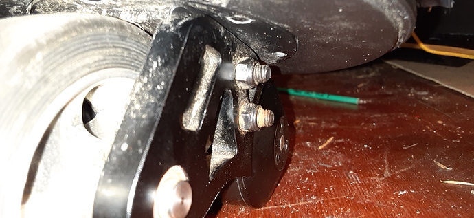

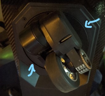

Make sure to check all the fasteners. These two were spinning on both my modules.

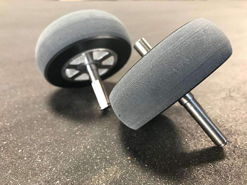

Also what center wheels did yours come with? I should really order that better one they have.
I honestly don’t know the names. I haven’t really researches this thing anymore than to see if it’s fun.
If I get the hang of it and decide it’s a keeper I’ll swap to VESCs and a build a battery with a decent charge solution. The factory charge solution is garbage.

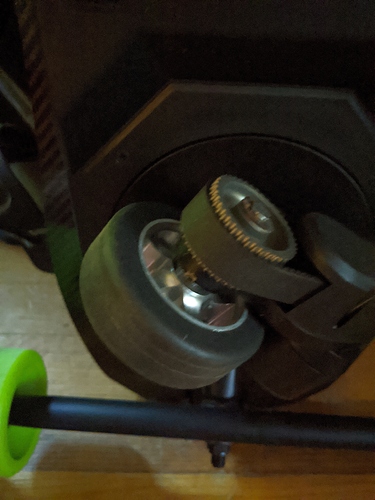

Here’s a pic of the wheels I have.
Yeah that’s the old crappy one that I have now.
https://summerboard.com/products/drive-wheels-axles This is the much nicer one. Good that I have the version with the D shaft.
2afd73aecacc5829628ad37d36c770cc9228cf54_2_375x500_LI This tolerance mismatch is why so much shit gets up in the slip rings. I shoved a ton of grease in it for now but I think a flat rubber ring seal over it would be good.
