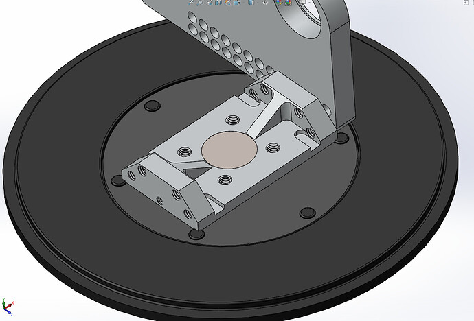

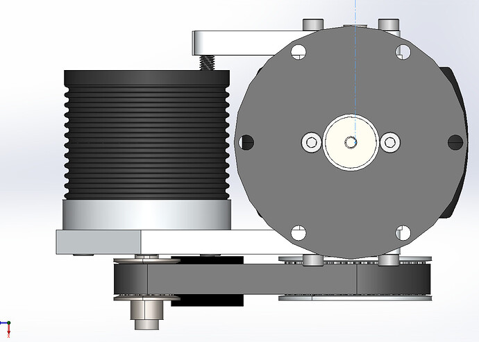

that is what I started with. It is fully supported in all my designs. It is actually the best choice with the modular design because you can slide the motor and not use an idler. Only use two bolts, or drill more holes.
This is the next thing I need to design a mounting plate for. The modular caster is designed to work with them with some adjustment.

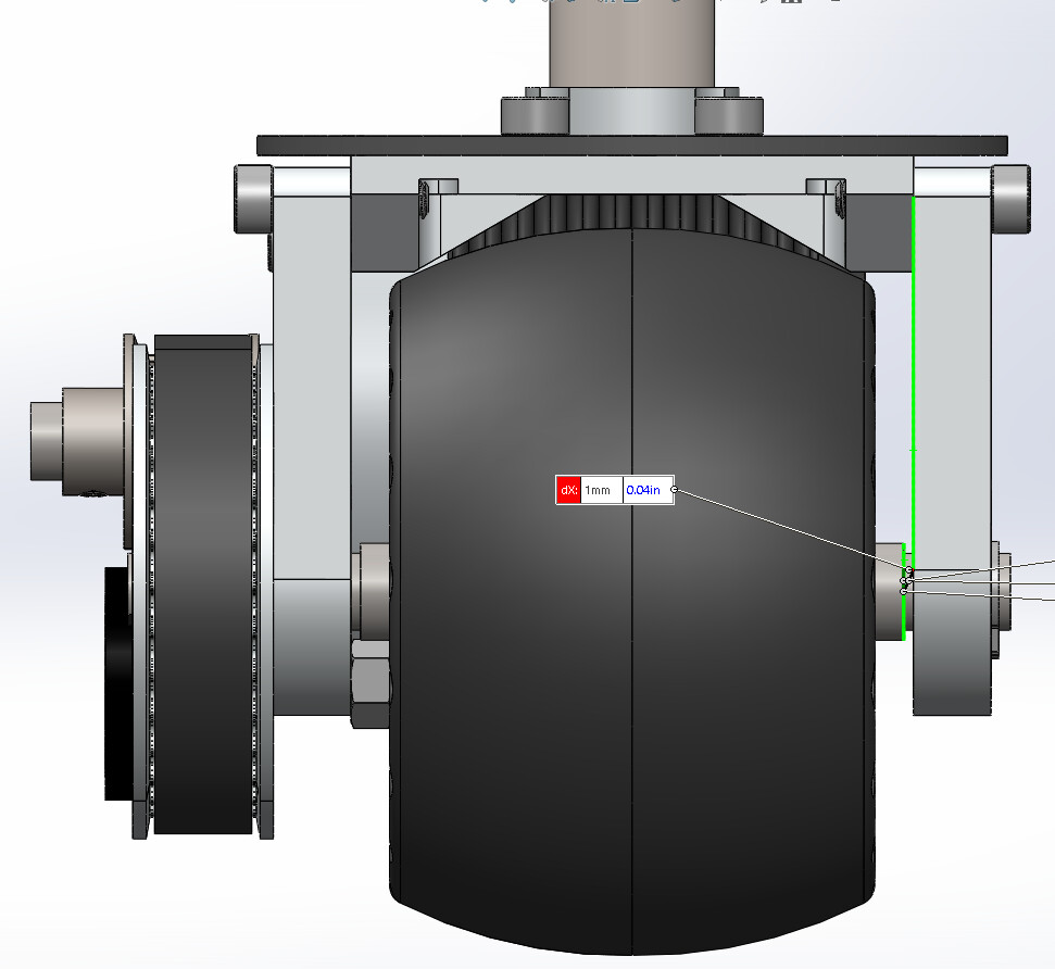

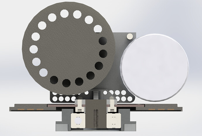

That is a slight issue
boo mmm
oh if I offset the outer ring 15 deg I think I could have avoided that haha

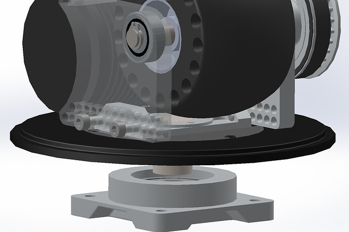

Just the last few pics I posted. The Modular caster I can think of no more improvements for. It can use either HTD 3M or 5M belt drive and fits the stock leiftech/sbx belt size. The motors it can use are all of them. Except 63mm motors, Yet. The HTD 5M belt drive parts all all COTS and readily available.
One of the few things I do not have is a good way to turn the JMK ride freeline skate wheels into wheels with a keyed 8mm drive axle. I can either do a custom hub adapter just for the JMK ride wheels or I could try a more universal skate wheel to 8mm keyed shaft adapter that would be very useful for testing. Hmm I have a fairly good idea for that actually.

as long you are not sure that you really will stick with this specific wheel i would prefer something more generic IMO

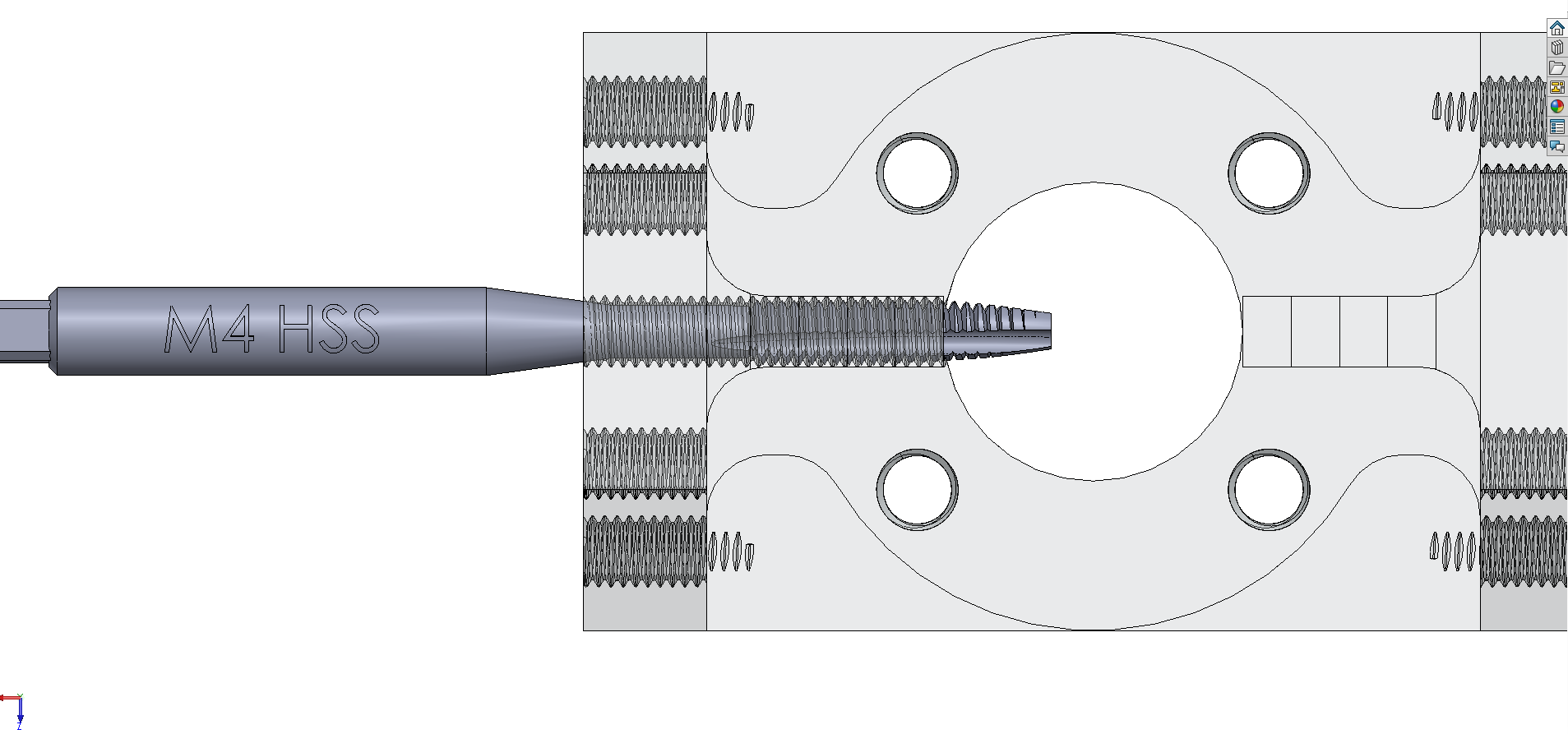

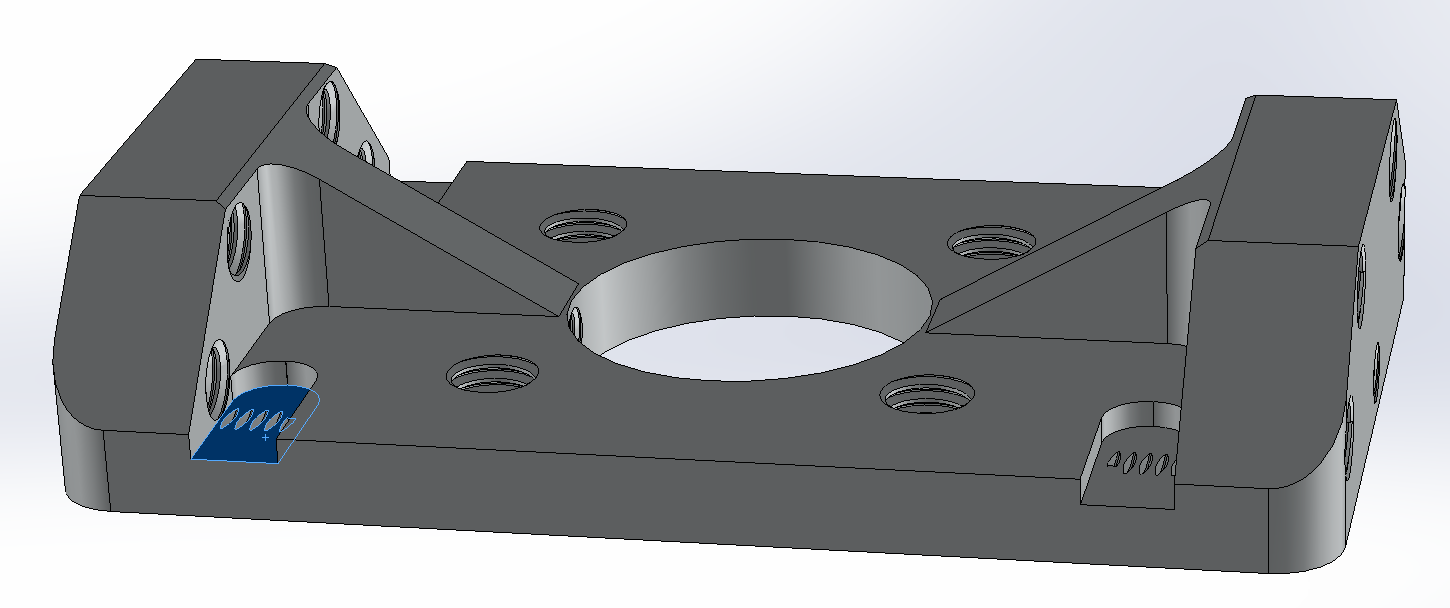

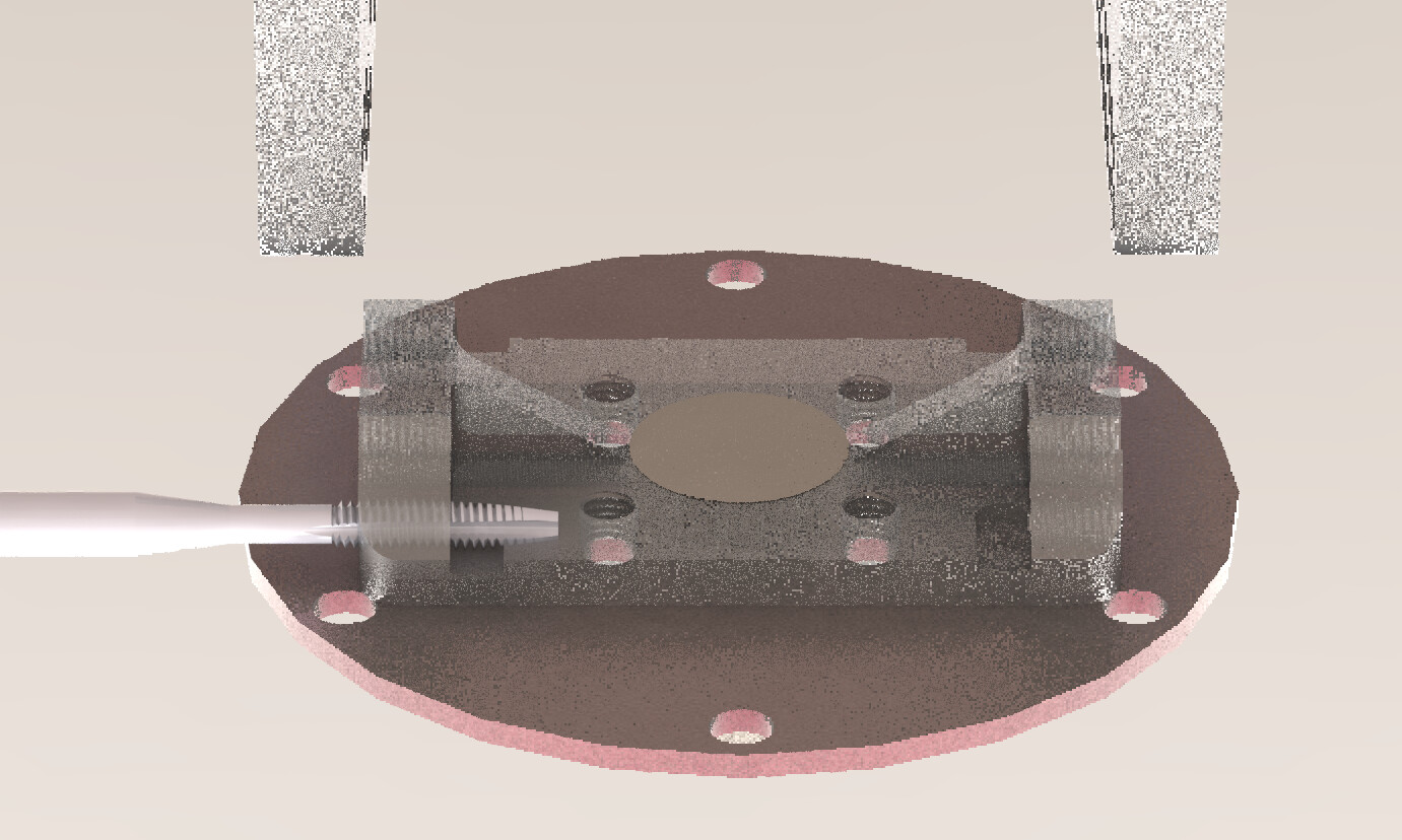

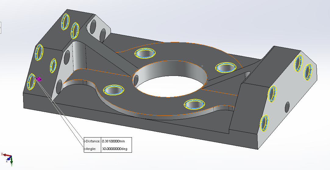

opinion on should I make this cutout for the tapping of that set of threads deeper or let the tap cut those scratches out? it is not a strength issue, idk.
Does the tap need more room for cutting full depth?? idek
You’d need to use a taper tap for the initial threads and then a flat bottom one to do the ones furthest in
Yeah I know I can start a Solidworks CAM operation to import a tap to ensure it can reach the appropriate depth… That sounds like a Pain I can prob just import a 3d model of one…
guess I’ll minimize the depth and make the cut out the proper size.

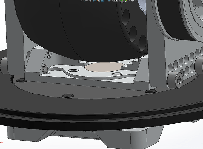

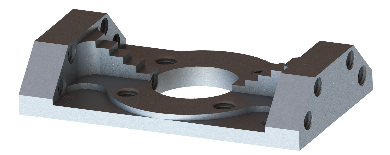

I feel like I learned something from @ChrisChaput where I should make a bunch of steps on the incline of that ridge to make CNCing it easier. I forgot I wanted to make a general CNC/CAM discussion thread, Ha. Threads…
I guess those step should be taken on the outer edges too

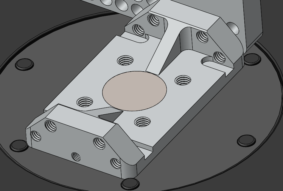

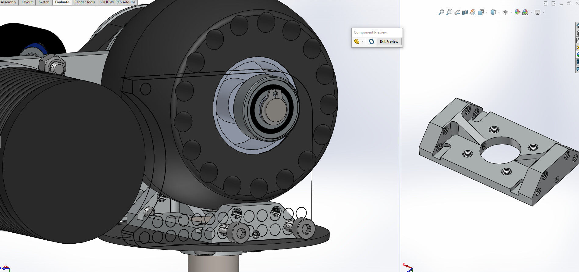

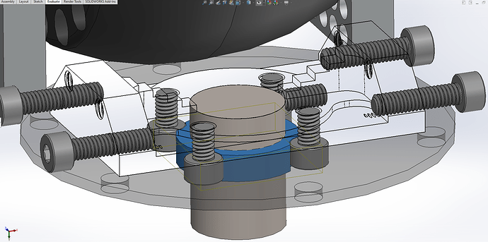

This highlighted spacer part could replace the grub screw holding the pivot axle in the center modular block, by being fixed by a pin then having the m4 screws hold it together. Or both could be held with 641
Hmm you know thinking about it, that grub screw is preventing the module from just falling right off of the board… might want a pin instead. Although 641 plus the grub would be solid enough I think. Mostly works out for the BN stuff… for a while.

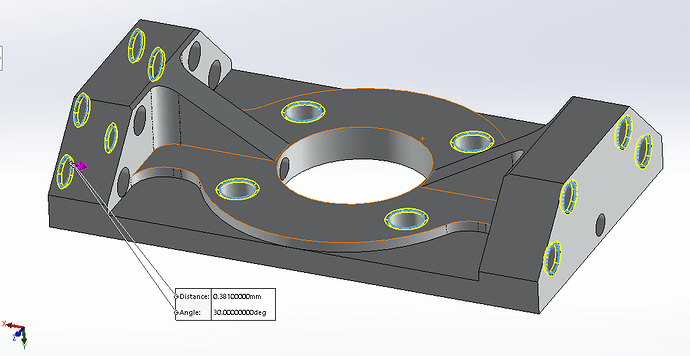

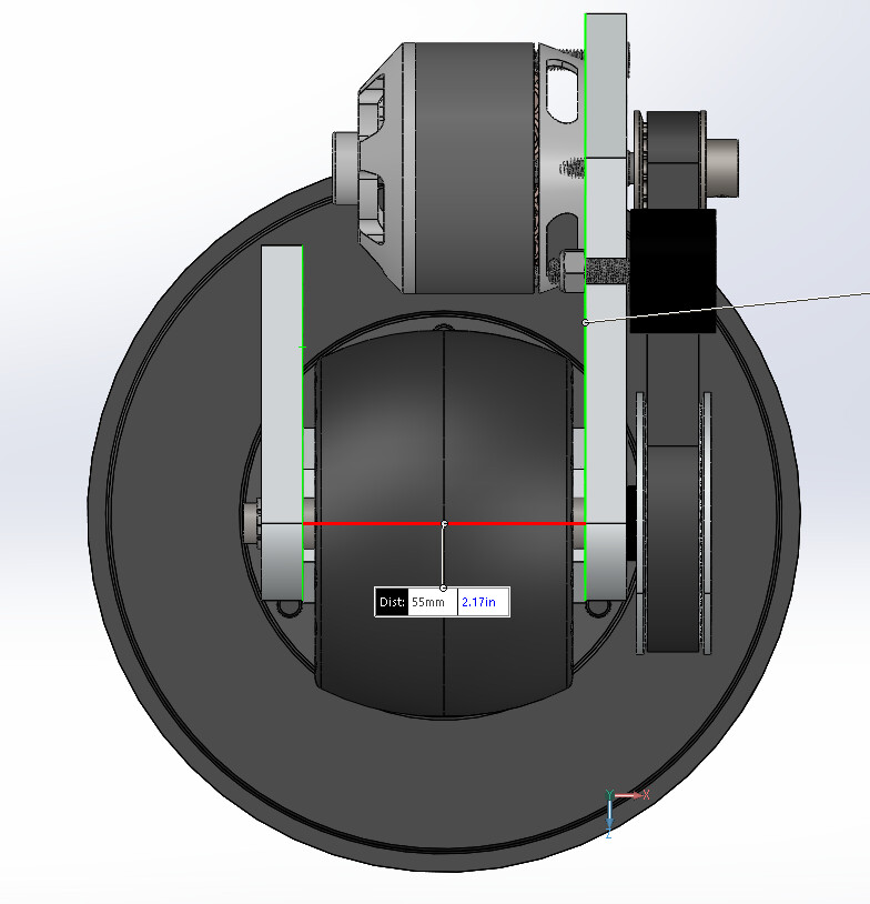

oops forgot to fix this issue also.
Should cut down 2 twoo
almost did it lol… 22.5deg actually

I certainly enjoy how my design here is good enough to not have any improvements left in mind at all really. Just testing the motor plate for it’s durability with and without a bolt across the bottom. I have no idea how these things would fail doing jumps, would need a serious drop that’s for sure. Modularity meaning bad parts are easily upgraded.

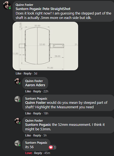

List of things I am still working on:
  • getting SBX wheel dimensions/model
  • figuring out exactly what the height changes are for the slip ring mounting in the SBX PCB vs the old v2. @Suntorn and some others are helping with that due to my lacking a sbx still
