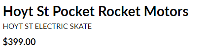

I think the 56mm hoyt pocket rockets will kick ass and be more than enough to handle an adult going uphill for hours, do take up a ton of room though.
i think these hub motors would work way better since they already have the powerball shape and are like 1000W. only downside is their size. your have to use risers on the truck you’d have a higher center of gravity. not sure how well that would fell on a freebord.
this price is insanity.
Yep I almost got a set or two of them when they were on sale, wish I did. That is the hub that @alexincorsica is using for his project in E-Freeboard Open source Electric Caster
Price on the hoyt motors is a lot but you are paying for reliability even if you beat on them. Hoping they would last over a year of skatepark riding. Also that is the ONLY option I have found between 50 and 63mm motors that are not high KV inrunners or hubs ofc.
