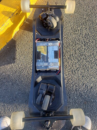

I’m seriously considering ripping my SBX apart, transferring the SR360’s to my freebord and building my own battery as the SBX electronics are janky, a great improvement over the leif but still. Having a decent battery and running HFI would go a long way making a huge difference.

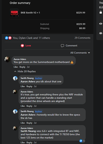

No idea on wh/mile mate, summerboard have their own app now which is a skin over VESC tool. I never used to have the SBX VESC tool installed as you can only have one instance and I need it for my other boards

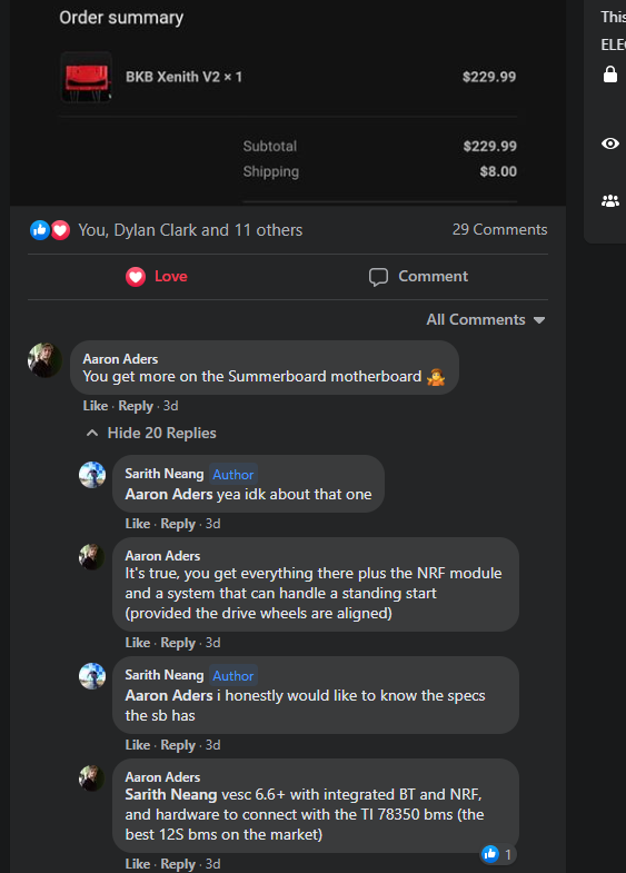

SBX ESC is VESC 6.6 based with an NRF receiver and some kind of feature enabling you to start from a stop, idk if that is like a.s.s or what.
Aaron suggested buying it opposed to a FOCBOX which on a moral level I could get with but for the general user idk. seems like a way to sell an overpriced battery.
They would be really happy to crash test some freesk8 remotes yaknow @DerelictRobot

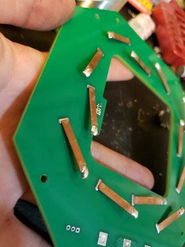

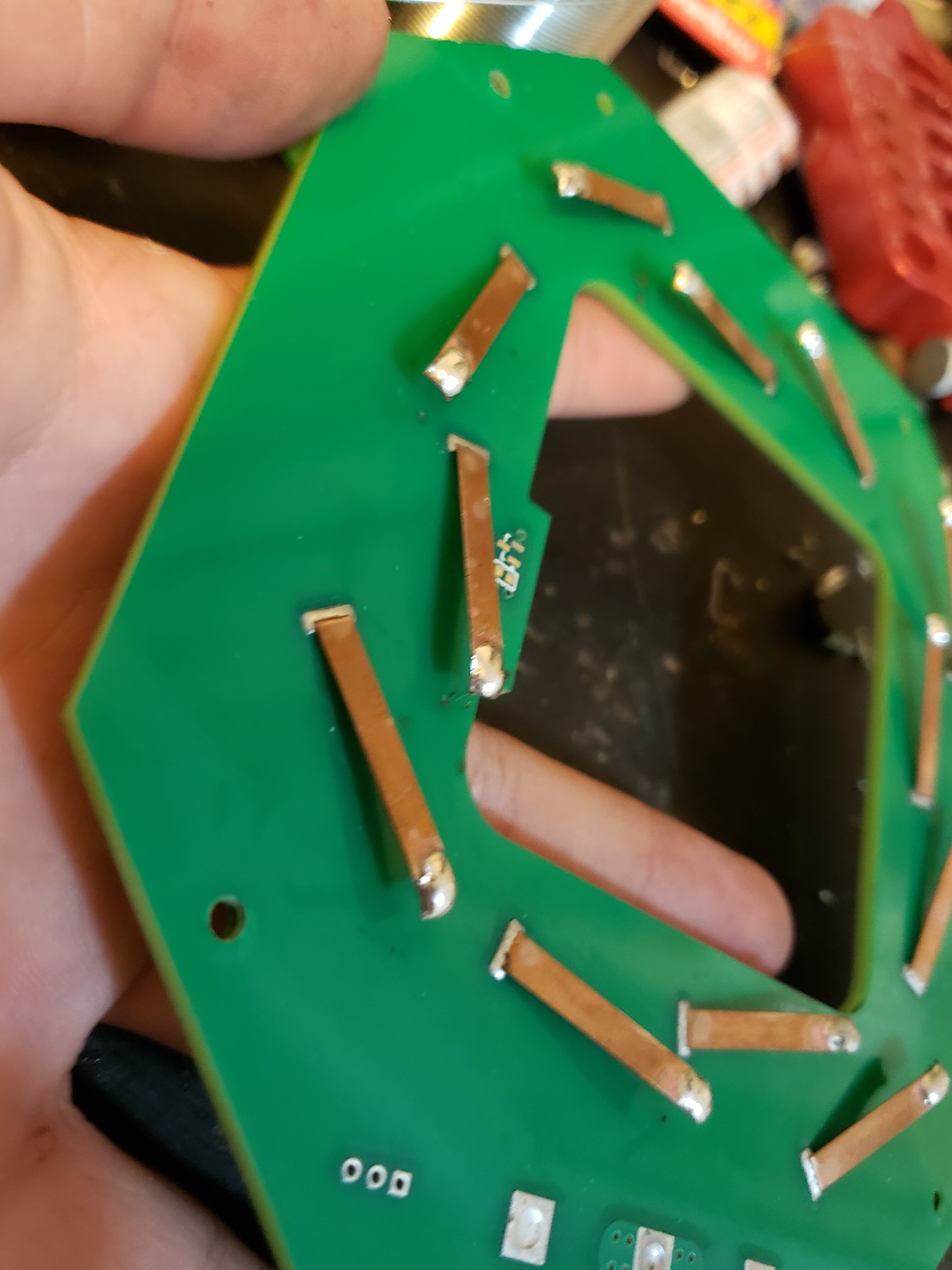

Yep it’s a VESC based ESC for sure but the implementation of the rest of the electronics has caused them many issues. Power switch, BMS and hall sensor for detecting if the battery is attached all go through this optical isolator board which tends to cause issues.
You have to have the board switched on to charge, if the battery gets too low it won’t turn the board on…
I love the product but I am starting to think it might be better to just do my own thing. There isn’t any special start up thing, the board runs uncensored FOC, a push to get rolling is pretty much required. The ESC is in the board btw, the battery carries all the other electronics
You see he talks about how the esc pairs perfectly with their batteries, also the esc case having the battery compartment as the same part makes it clear how they are supposed to be used with each other.
No UART connectors, but maybe could be hacked on.
$400 and no warranty on the esc only I would think, battery is $150. Deck is ?? $75 guessing
I’m not sure of you missunderstood what I meant, ive had several of these apart and repaired them for Summerboard, I’ve got the guts of several batteries and motherboards in my workshop and some components to fix the ESC’s as they are prone to blowing the big diodes. You do indeed need to use their ESC with their battery - like I said inside the battery you have several other things going on such as a safety switch, BMS, and the on/off switch routes through the mobo to the BMS too and then they communicate with the motherboard through this optical isolator board using those smaller pins you see on the connector. It’s also actualy 2 seperate batteries that are paralleled together on the motherboard so technically the battery is air safe as its 2 x 99wh packs in one shell.
I do ride one and I don’t notice anything different other than unsensored FOC going on. I am not sure if their ESC supports HFI, but that’s what I’m thinking about implementing on mine, I think it could work better.
I understand what you are saying. My comments were about how Aaron said you get more from an SBX ESC than a Xenith, but that doesn’t say anything about how you also would then also basically need to buy an SBX battery, and looks like a cutout deck from them possibly.
BTW that cutout looks like a great way to give your Vesc a nice bath.
For the price of the SBX system buy a VESC HD60

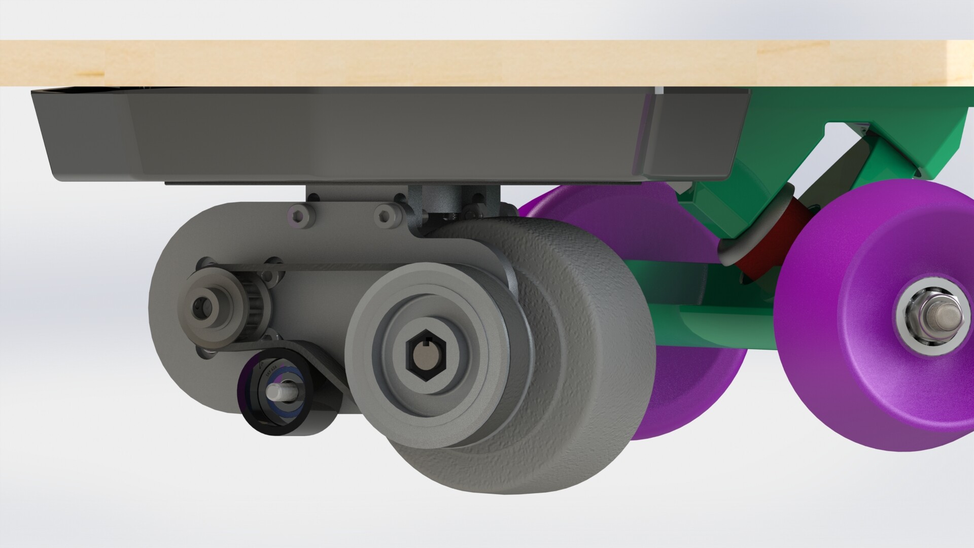

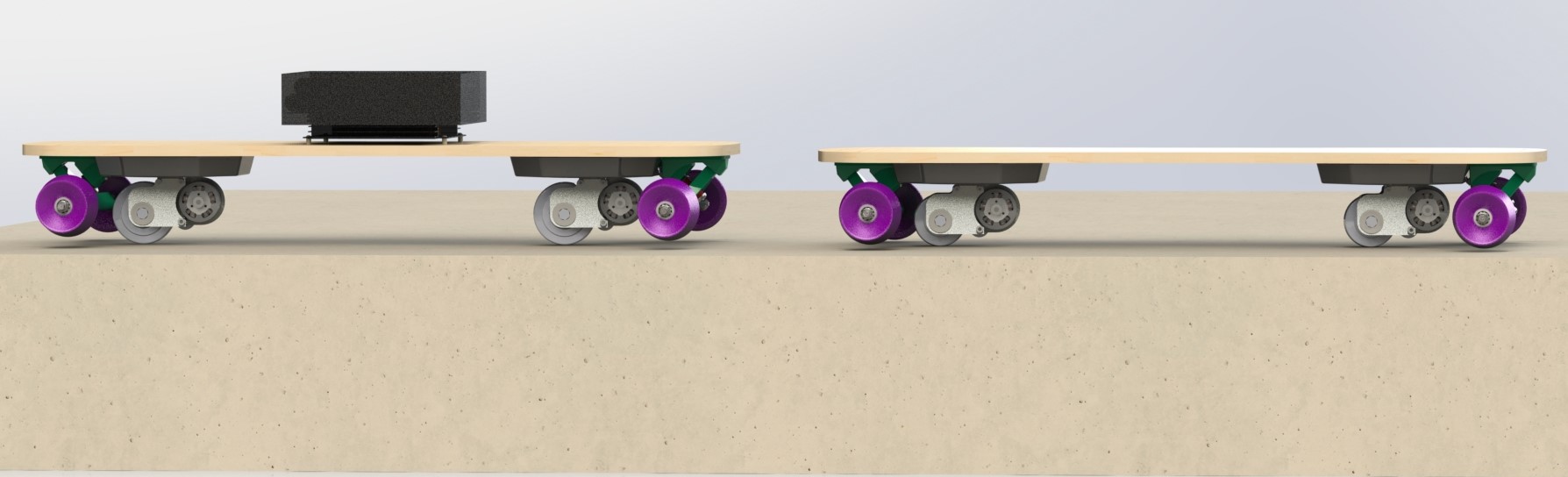

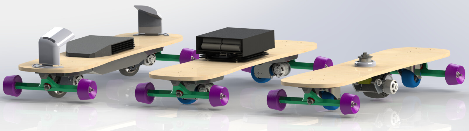

Right now I am trying to come up with idea for how the electronics should be mounted on this board. Then I can print some models and test them out.

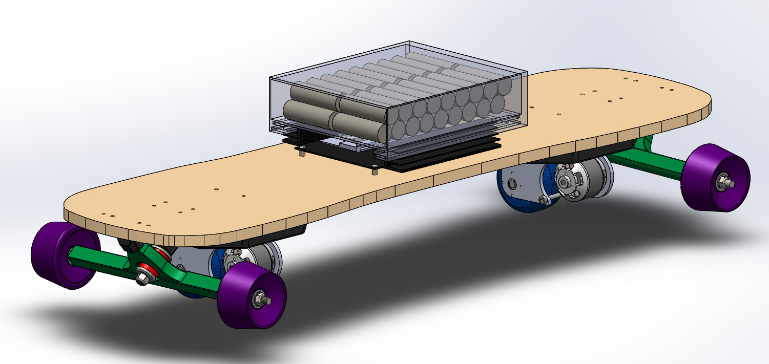

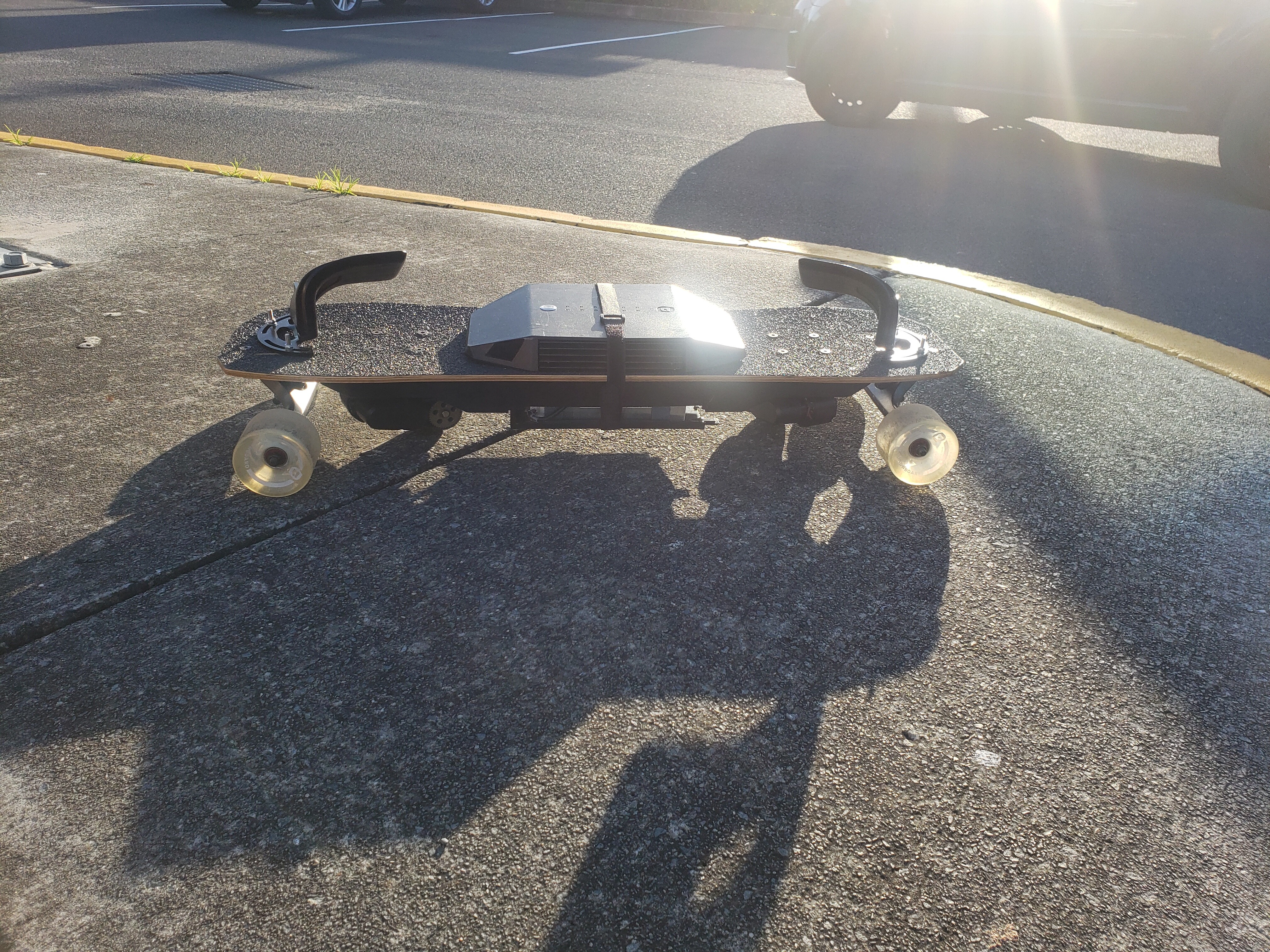

worrkkkinnngg on top electronics cases and shiiiiiiit

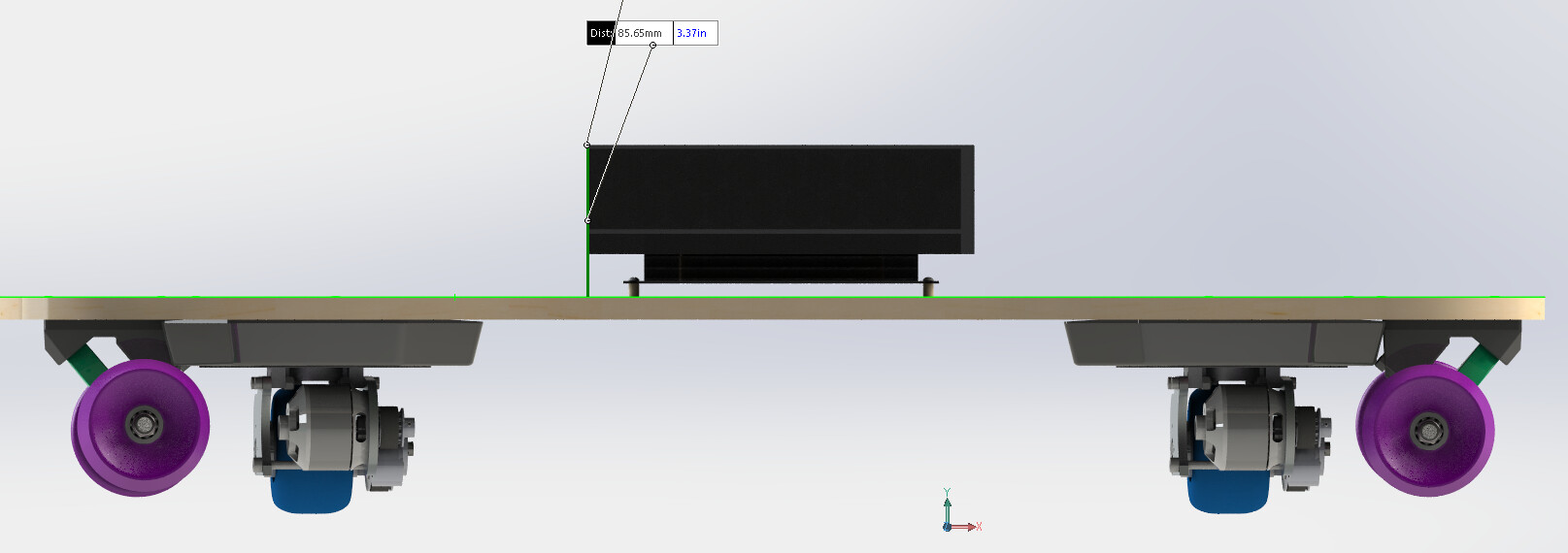

12S3P 21705
box is about 220mm/9in long
looks kinda dumb
but to be fair they are all kind of dumb.

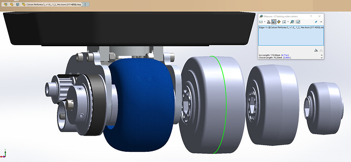

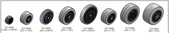

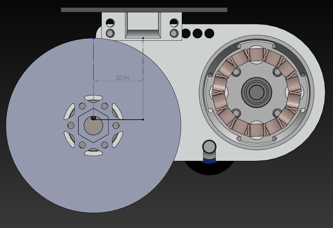

With that tiny wheel I could make a small e-freeboard for fun
3in vs 2.5in

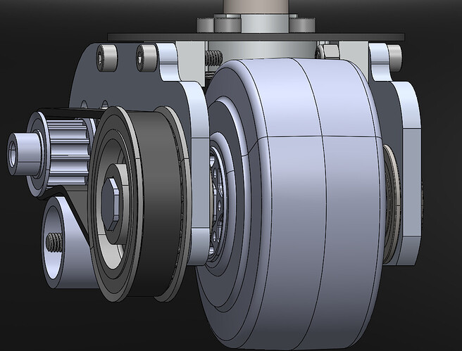

hmm ok after looking for good bearings for the hex shaft I see now it is just no gonna work.
Right as I realized that I found this solution:
Using this I can have 8mm bearings on a keyed shaft for the pulley and wheel.

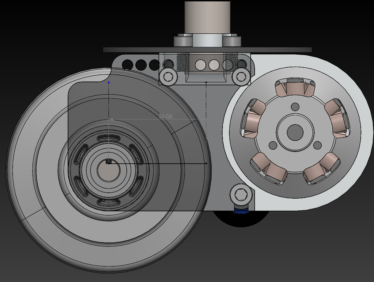

Things left to do on this module is constrain the shaft on the berings and the hex adapters/wheel onto of that. not sure yet how exactly.

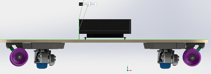

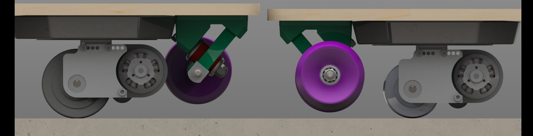

you think anyone would adjust the wheel closer than this?
15mm front to back adjustment, 4.5mm up and down.
TONs of motor-truck clearance still
