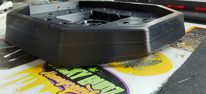

I have got the motor mount side much closer and the other side is damn near perfect. I think my first “hanger” model was fairly spot on as far as I can tell.
right as I and super-mega-111% confirming the dimensions I realize how I could have printed this part of the geometry alone to prototype quicker… well now I know.
as such
Nailed most of the dimensions down using the above method. Have sent the files off for production I guess, hope they can do some checking of their own to make sure they function. High hopes!
Next thing in progress in this project is buying a used summerboard wheel to get those dimensions and design my custom hanger and motor mounts for wide centers.
Possibly an entire summerboard, dead or alive
I did not notice these files
the extra looking holes are the locations of the 4 sets of 3 brushes
oh I forgot to import the brush PCB model.
should have started the print already
14 hours at 20%
Warping messes it up a little it seems.
Might fit on still

I do kinda remember knowing that people had made custom separate covers for the v2 I was only planning on modifying the stock ones but now I can print stuff to try out at least.
I was too lazy to take apart the v2 so I starstarted by getting the profile for this 83cm Freebord deck
hard to see but this is nearly there
Then I can try the 2-part case
How did you do that ? Trial and error or you have a technique ?
I wasted all that filament on the full print then realized I needed to tune in small sections, just trial and error to this point. Prob did about 7 revisions so far and it is close enough to work but not perfect.
