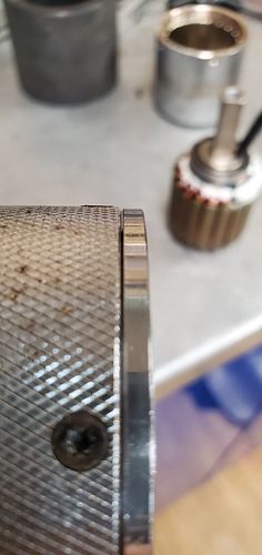

Onto the motors. The famous water cooling feature. A 165x6mm heat pipe with questionable thermal compound, laid horizontally (no gravity assist). Not sure where the vapor and condensation chambers are, but if it is the usual type with each on opposite ends, all it will do is transfer heat from one motor to the other. (lol?) I didn’t do the math on this but from what I remember a long time ago, it is not nearly big enough to make much of a difference. (that’s what she said)
Motor winding reminds me of a high school motor I wound by hand for a science project. This is likely the source of the heat problem. Stator fill is terrible, winding is absolutely inconsistent and not up to par for the power of these motors. Air gap at 0.5mm is not great but not bad either, so the problem ultimately lies in the winding and the heavily armored and sealed motor can. This looks like a case of okay design on paper and bad execution in manufacturing. What you don’t see is the horrible wobbling tolerance of the casted motor plate. This part should’ve been turned on a lathe for true. I might end up taking it down half a mil and shimming it to true. Lack of grease or seal also introduced rust to the mating surfaces from water ingress.

A quick attempt to true the motor shell, the face plate had to be taken almost a mil off center for the shell to spin wobble free.

It came to my conclusion that this motor is just bad design. It has way too much power with no way to off the heat. Surrounded on all sides by 4mm of some kind of steel alloy and covered in PU, seated on a steel axle and completely sealed, it’s essentially an insulated oven. The vapor rod does essentially nothing as by the time the heat reaches the center of the axle, the stator and sensor is already overheating.
Rewinding to a lower kV would lower temps, but also lower performance. Rewinding with better fill may yield another 5% in efficiency, but ultimately, 1000+ watts in each hub that, realistically, could dissipate the heat from maybe half of that power.
I don’t want to neuter the power of these motors, so that leaves one conclusion, the motor needs more cooling. Considered the options like running statorade in the shells, but drawing the heat to the can does nothing when there is still a thick layer of PU insulating it. So ultimately, this motor needs to be vented.

Edit 6
Finished the template and went to town on motor cooling. 10x6mm holes on both sides, plenty of airflow now. Waiting on a D140 BMS, VX2 remote and currently in progress of attempt 1 of molding the outwheels.
