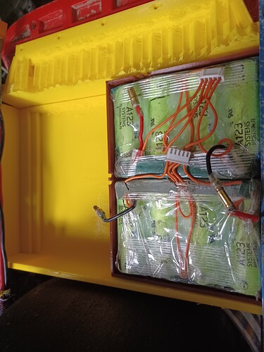

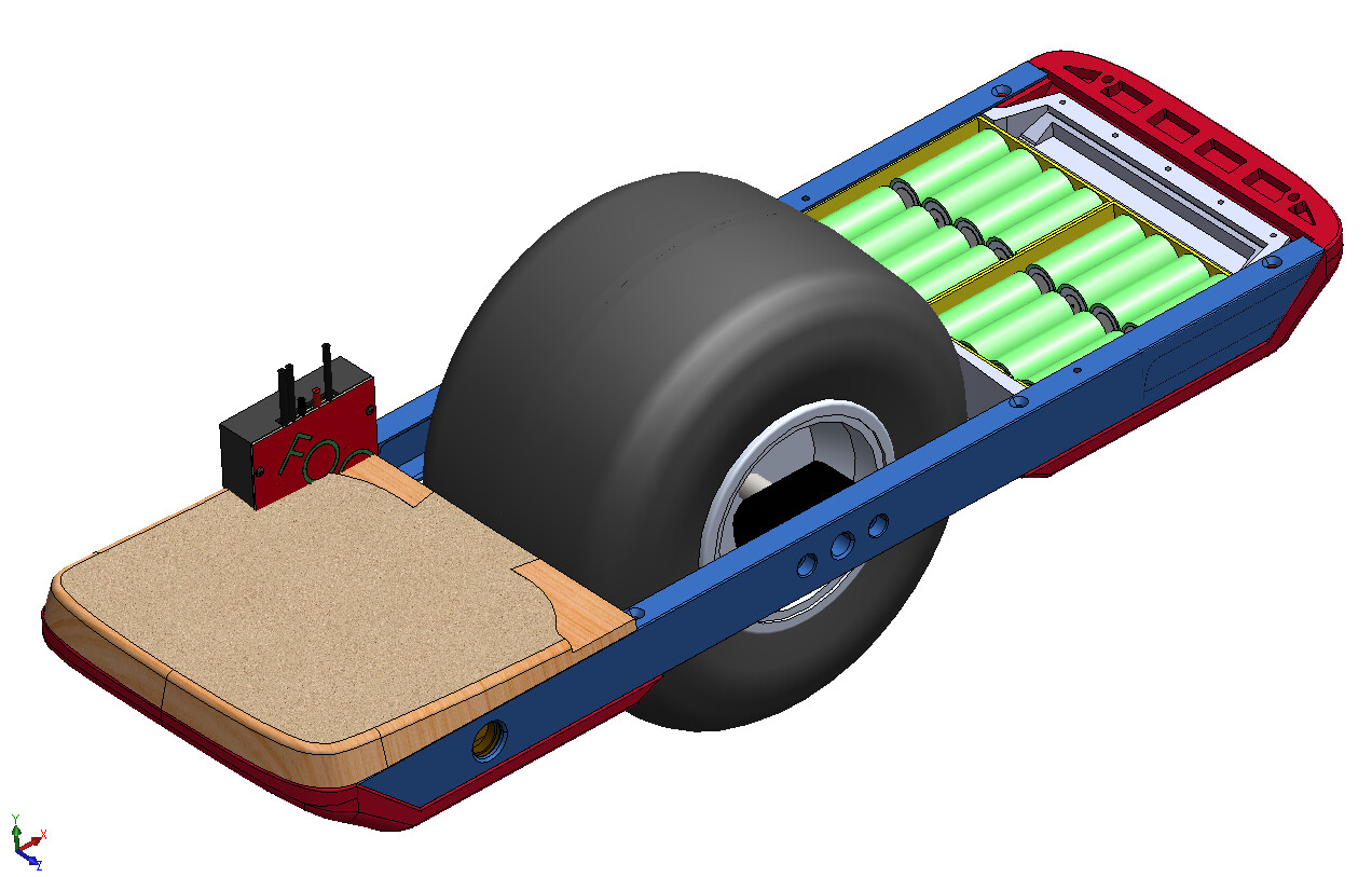

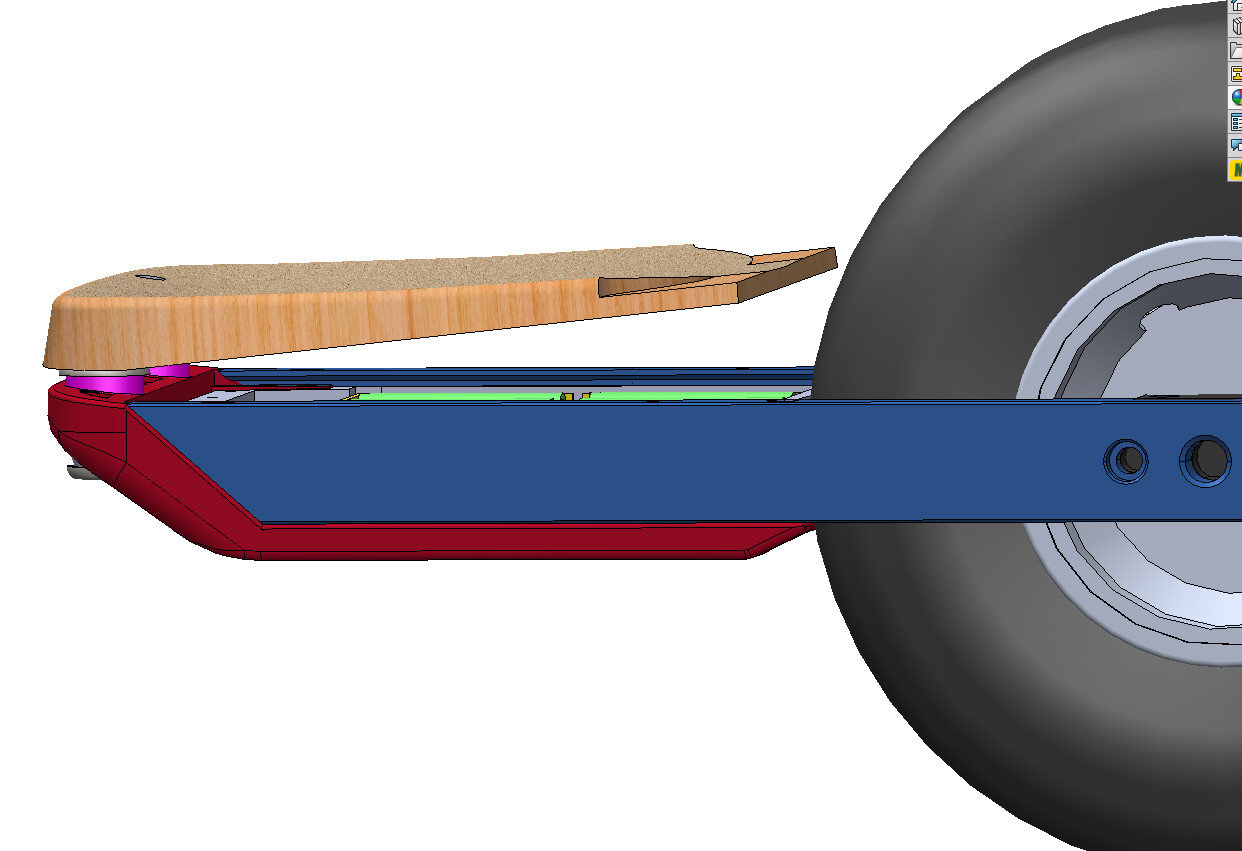

Trying to make the battery modules remove easily ish. so a split compartment up front is what I am working towards.
Having the modules slide out the side of the rail no footpad removal would be tight.
would look like this kinda. if it was wired for parallel modules they could be 20S1P.

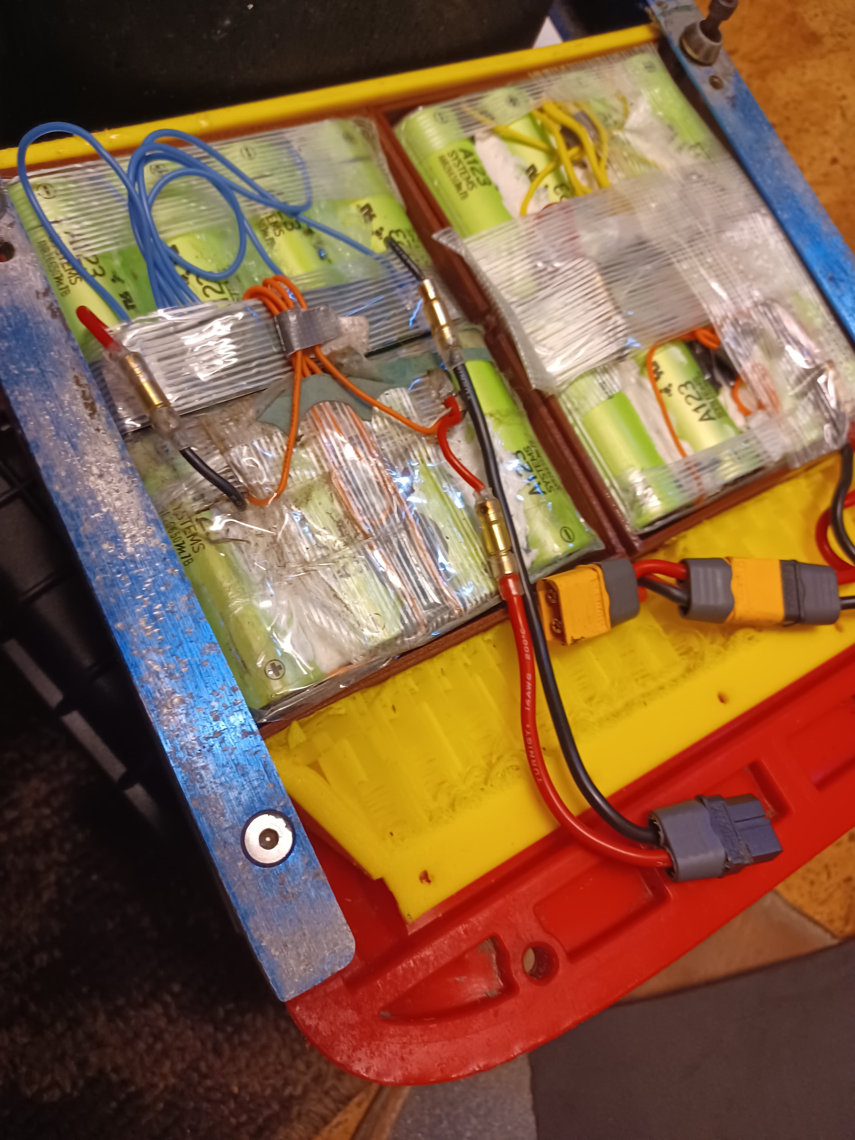

Getting close

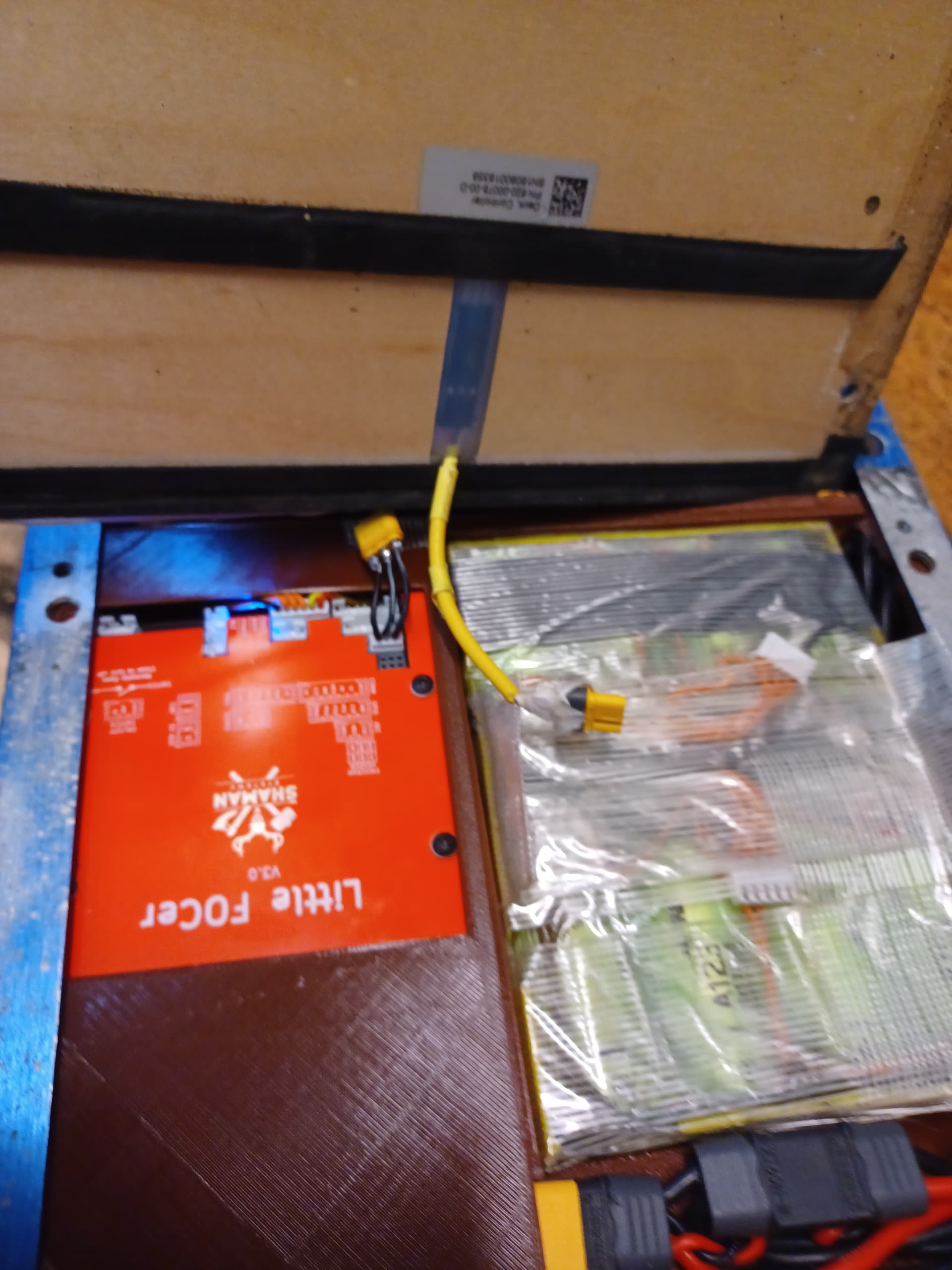

Figured out I needed motor and battery connections all run up one rail/side, not much room.
think I will not have MR60 inside the box, just wires from the esc to the connector external due to no room to mount.

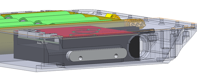

The esc would have nowhere to sink heat unless I attach it to the rail.
this alu bit would be glued into the box and hopefully extract enough heat and not leak.
What if the inside aluminum piece was a bit bigger touching more of the ESC, think sideways T. And fin the outside for better cooling?
Good thoughts but I think you missed this is between the esc and the rail.
Although… if I wanted to I could drill holes in the rail where this alu heatsink spacer part is and expose it to air, then fins would make sense actually. Similar thought would be gluing the bottom of the esc to the case to seal it off then have holes in the bottom of the bumper to let air get all up in there. I like the idea of using the rail the most. Sidenote I really want to make custom footpads that have smaller sensors so one corner could be cut out and let you have the esc on its side up against the rail.
The other thing I like about this is it would firmly fix the esc in place instead of having it all be friction fit box being squeezed by the rails.
with regular stance you would never step there anyways. so much room for activities like this.
huh not unless you did a trick… so better idea to keep it out of the footpad area entirely.
I think one issue I was not thinking about is something going under the footpad then you crush it against the inside cases.

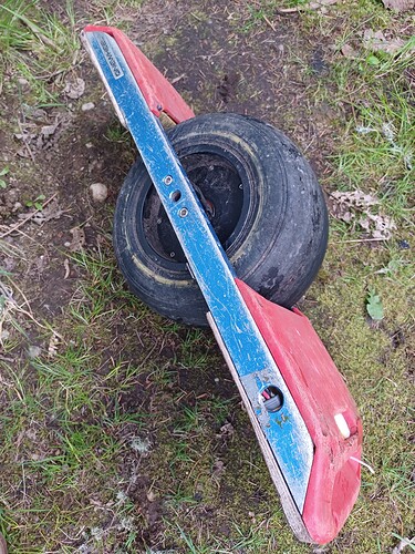

Sorry if it’s a stupid question but what you using for the frame?
Funking rails clearlyy
jk rails from Onewheel V1 (2014-15)
bang bumpers and XR footpads that are due to replacement.
Hoping to get some aftermarket footpad sensor for the next board that will have XR rails and BadgerBumpers. Motor wise either a superflux or floatwheel 6in hub.

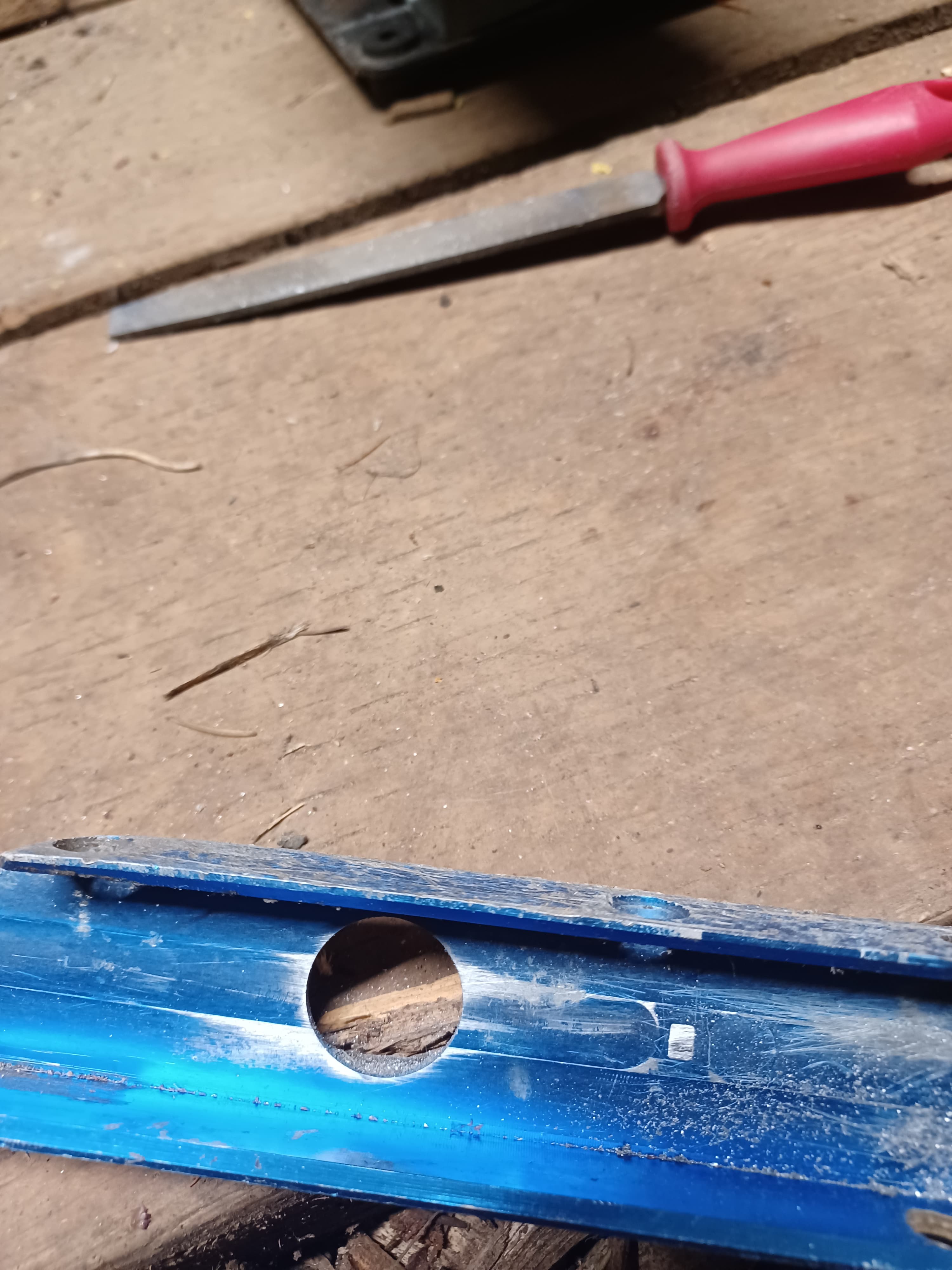

Do you know where you can get the rails from
I want to build one but can’t seem to find a good base to use
I mean you could get these!
Jk that’s like 600euroz
Many of the aftermarket ow parts makers sell new rails or you hop on fb or whatever and find someone with old ow rails for like $60.
Funwheel and Floatwheel rails could also work.
Lastly I have seen some good builds that just use random alu or steel stock.
