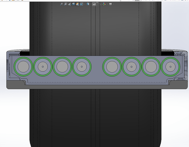

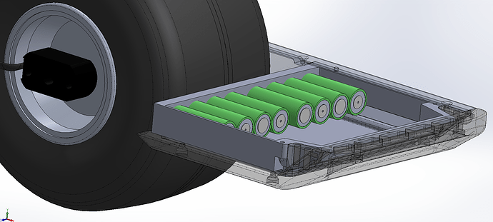

This is the only smart bms I found that could reasonably fit. Its flat enough that you could still put one layer of cells above it. But I would also accept “only” having a 20s2p in the battery compartment and the bms and controller in the front.

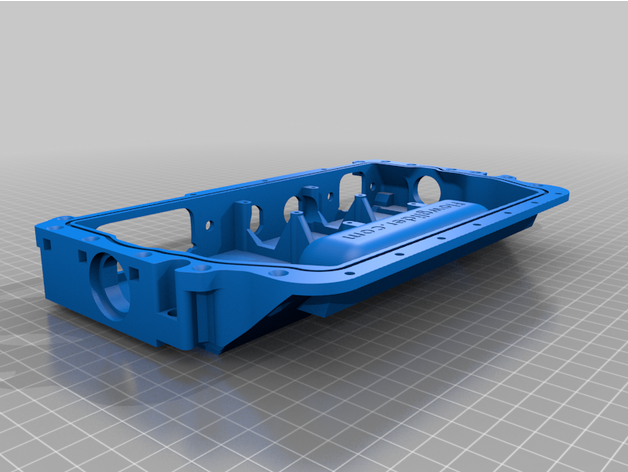

I Also would like to 3d print the enclosure with a metal plate at the top (and maybe bottom) similar to the case I posted on thingiverse.

it nearly fits right in that XR stock case
That looks great. Even if it doesn’t fit in the back it would still save a lot of space.

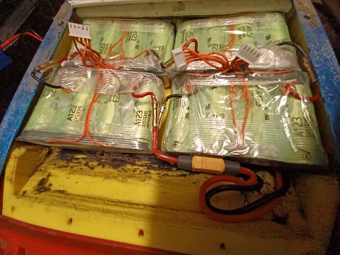

I still think a 24S A123 pack is nearly the perfect choice except in terms of range/ not having a split pack, although a BMS is optional with a123 cells as long as you check em every 20 rides maybe.

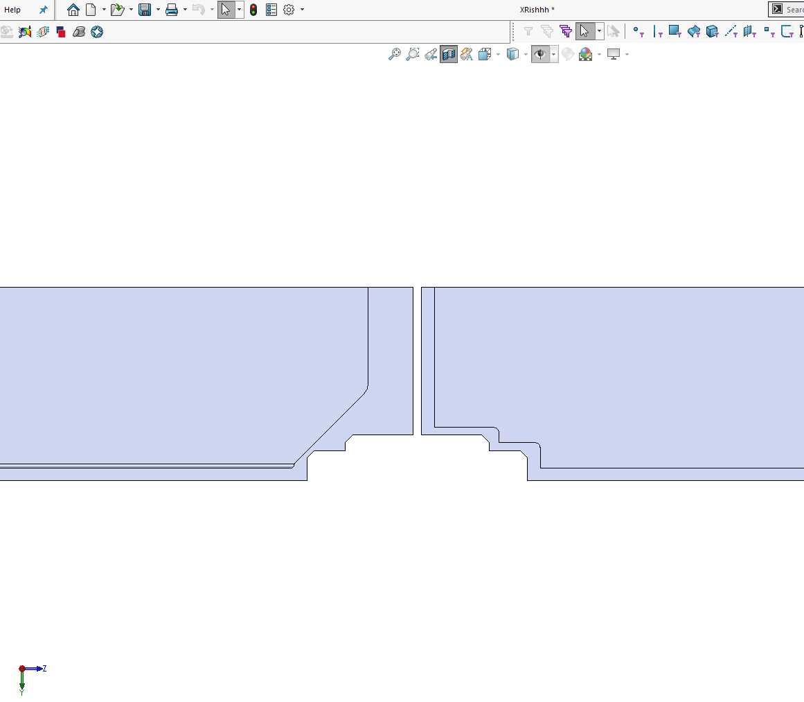

bang bumper and box dim still messed up slightly
redo the box cutout while im at it
19S test… still want to extend the hub mounting and solve the bumper mounting issues and widen the board a bit.
Directions

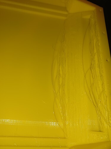

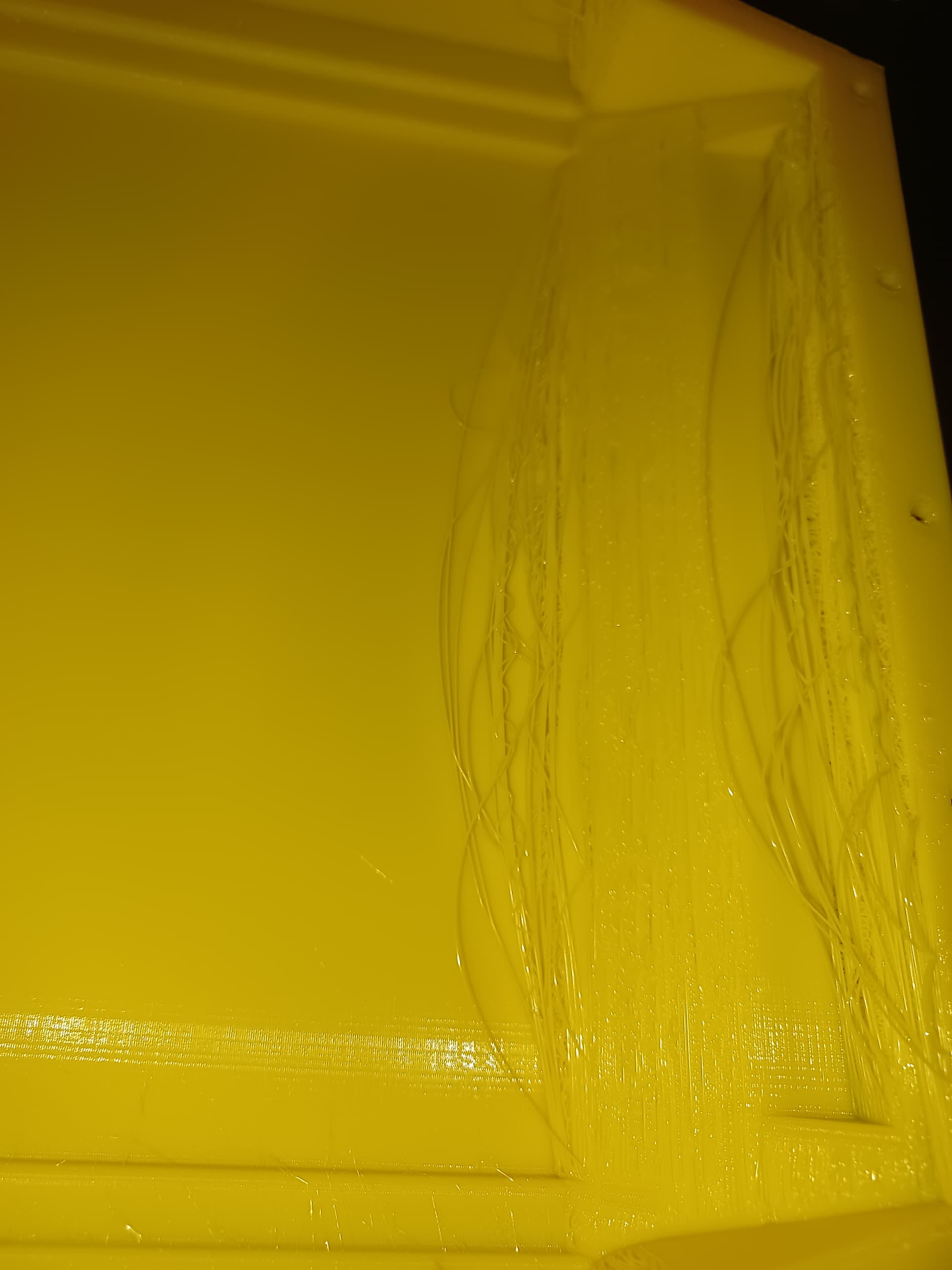

I guess I could have used a hot air gun to melt those strands down at risk of messing up. Needs changes to be good enough without reinforcement. Although thin wall will help me find the weakness.

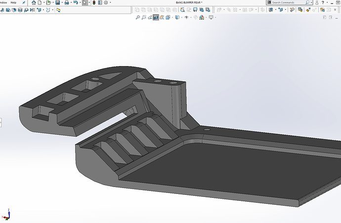

Thinking about more dramatic mods to existing common parts to increase enclosure space.
First one I already tried which is grind down the handle on the bang bumper to make the front case as long as the rear case, although if you were really going crazy to fit cells you would run battery side bumpers both sides.
I was thinking you could also cut the entire end off and move it out, but I don’t like that as much as cutting it down the middle and widening because it accomplishes the same goal but keeping nose and tail clearance. Widening involving motor mounting hardware so not as easy/cheap. Footpads would need clamps instead of bolts on the side closer to the wheel because rails not being underneath.
These mods avoid raising the footpad higher which is also a way to go, I was thinking about ways besides that.
Also related to these goals I would like a module that fits into bang bumper light cavity with LEDs either battery or internally powered with vesc controlling color and brake indication, I guess a version fit the XR bumper also.

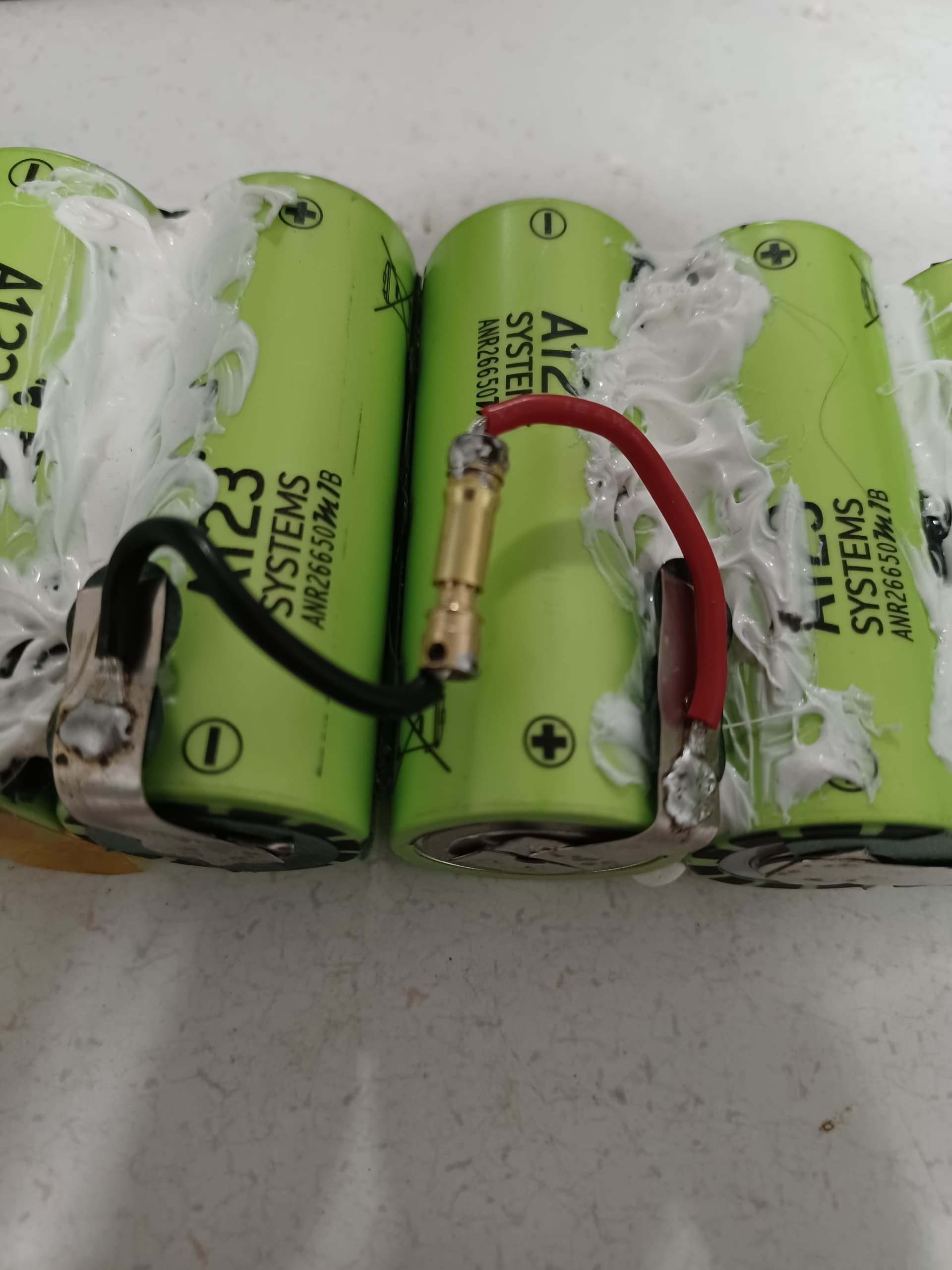

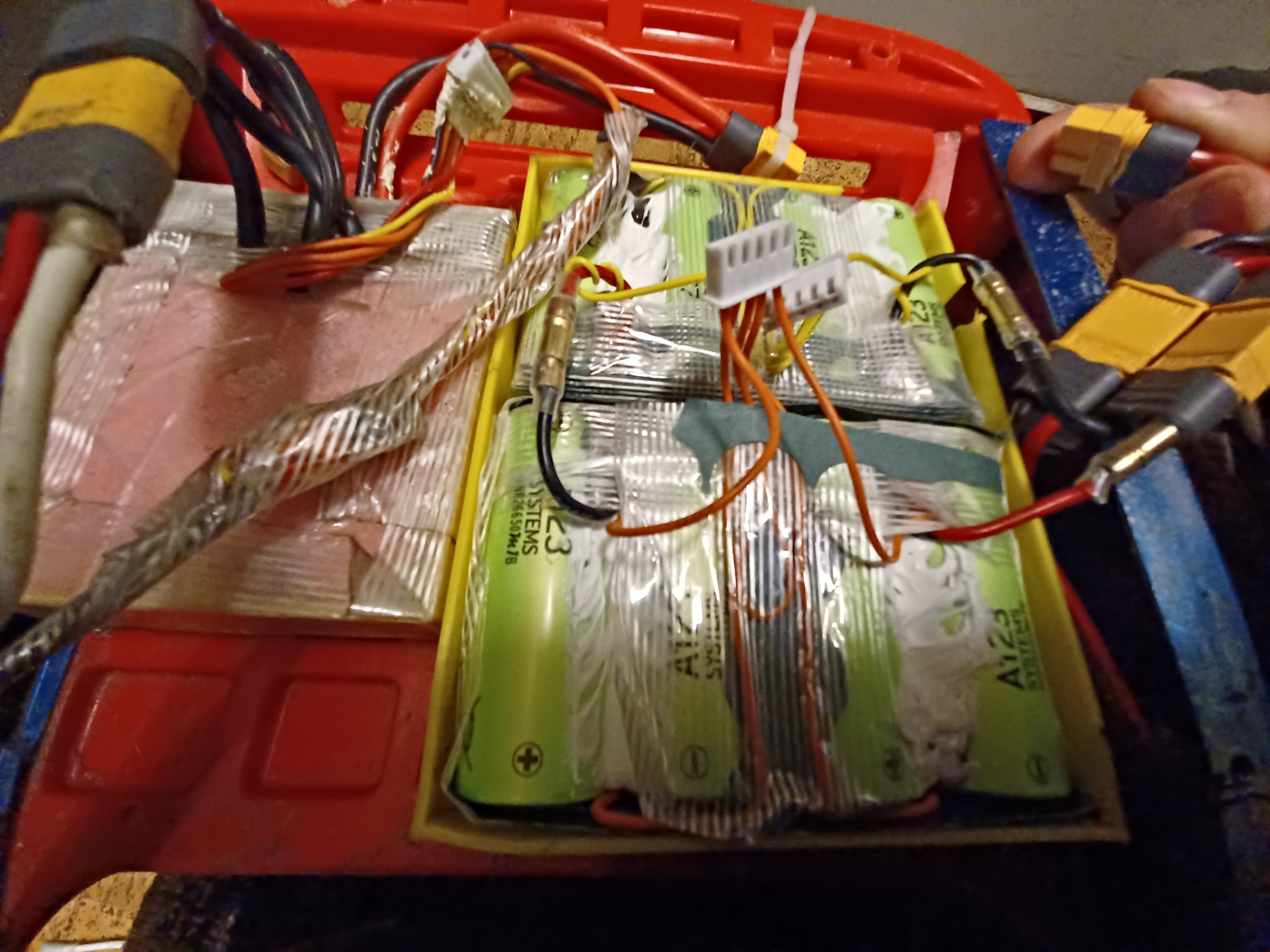

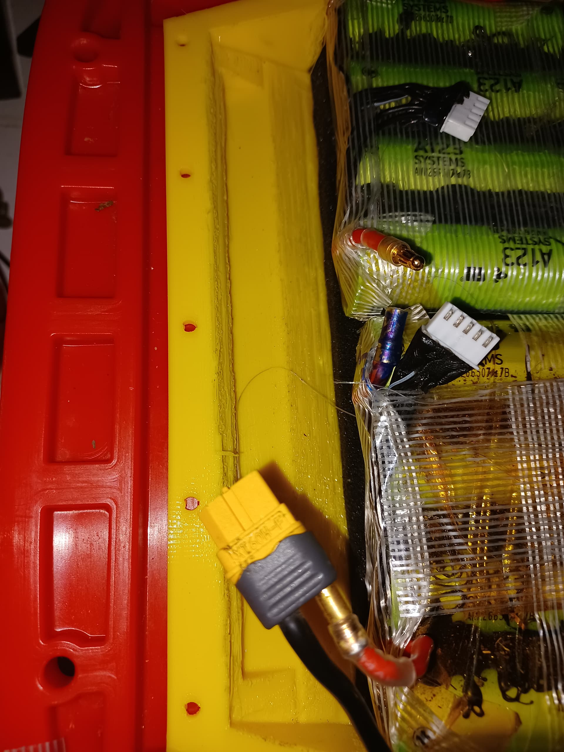

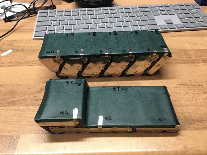

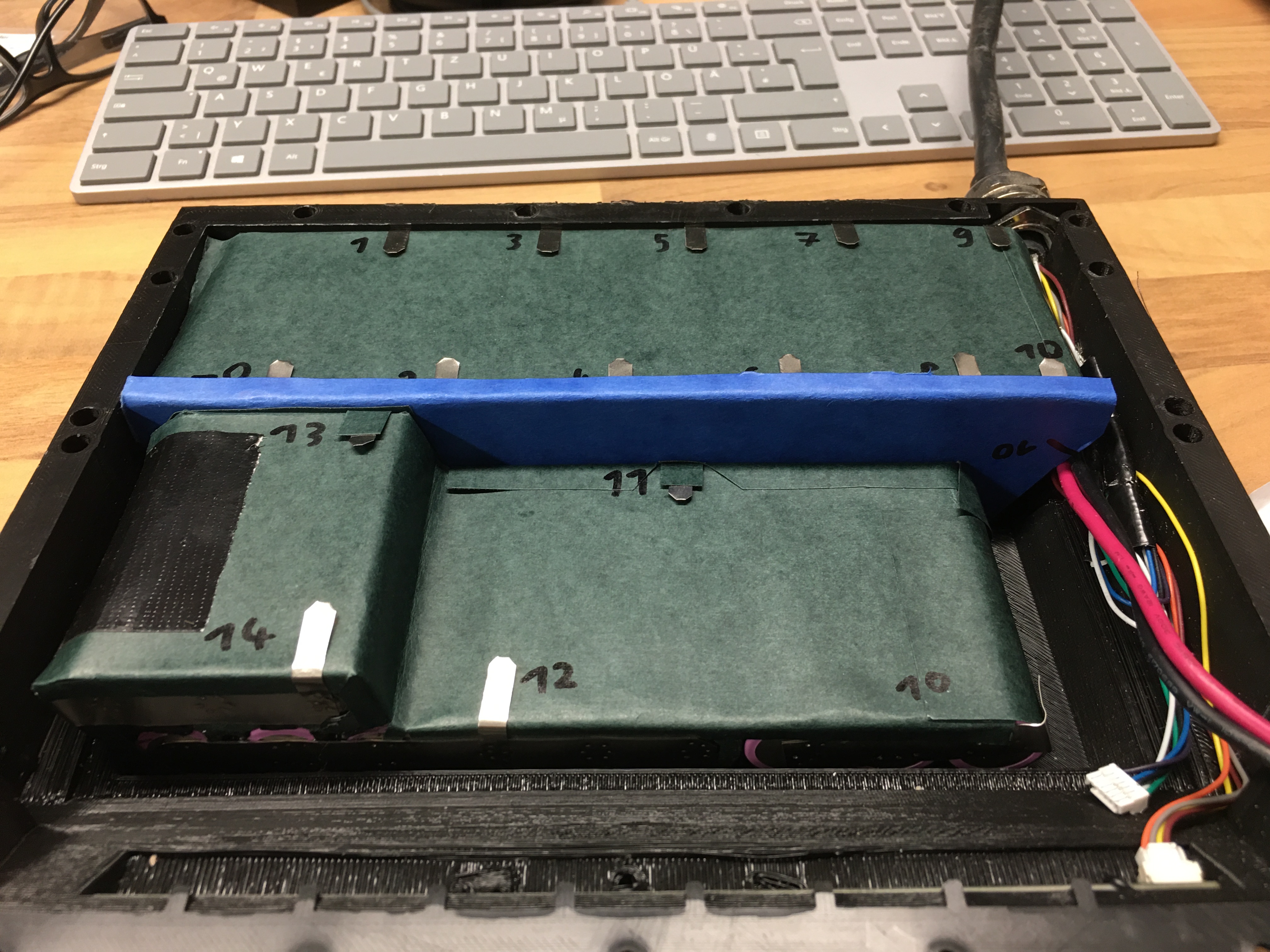

Ok so I posted only this one picture of the battery packs I made for the 24S1P 26650 M1b lifepo4.
While those series connections were unable to be shorted they were possibly more prone to breaking.
This keeps them a nicer shape. Excuse the non taped packs I need to figure out balance wires again to find any possible improvements.
Shorter series connections because the output sides of the 4S packs face each other vs away. Again this is a trade off between accidental shorts and quality of connections and stuff.
Trying to make the ± balance wires the shortest because if they ripped off they could be resoldered without taking it out of a plastic case.
A tiny bit more wiring harness adapters due to the identical 6 4S modules.
One of the screws is long gone
