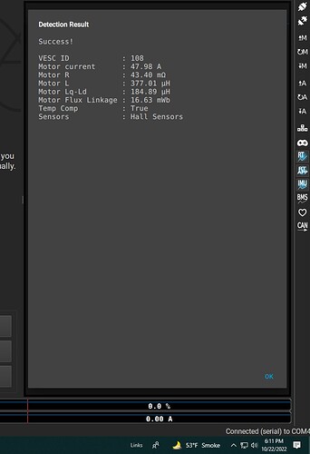

Onewheel V1 Transverse flux motor TFM 500W pictures.
https://drive.google.com/drive/folders/16Q0OKYmkN0YYeElRBHfq2wFAdG8NNEsh?usp=sharing
Can’t exactly make heads or tails of what the motor driving characteristics for this need to be, compared to standard bldc. The coils are where the stator usually is??
I really want to tag @hummieee or anyone who knows the first thing about making motors. Not that traditional motors experience transverses over to this. Btw John do you still offer motor rewinding? Not for this but for a regular ow motor.

I failed to mention the major motor torque cutout issues so far. I was hoping it was something basic I missed but no.
So while the board rides its not able to stay engaged due to the TFM properties not lining up with the VESC firmware’s expectations.
