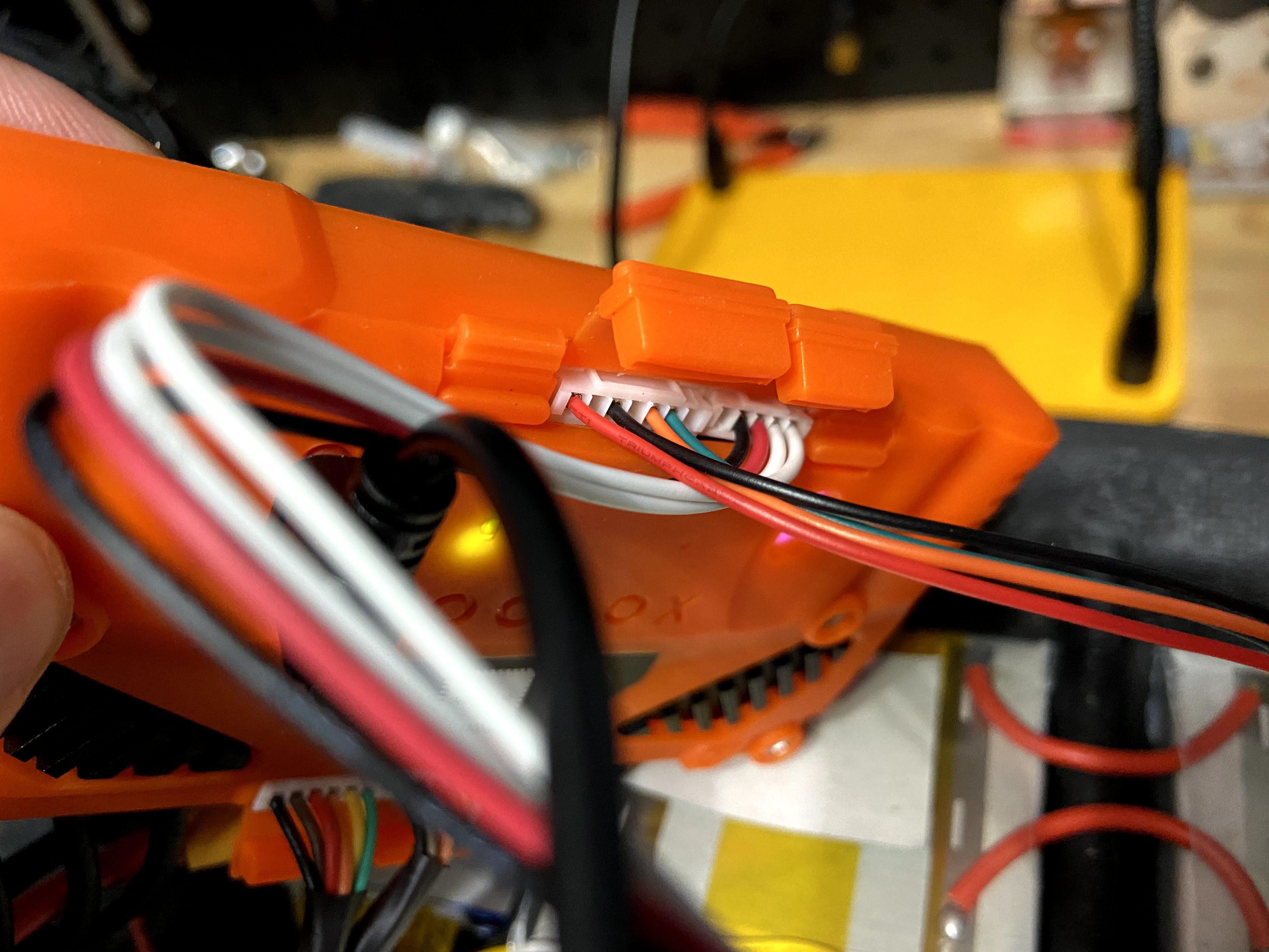

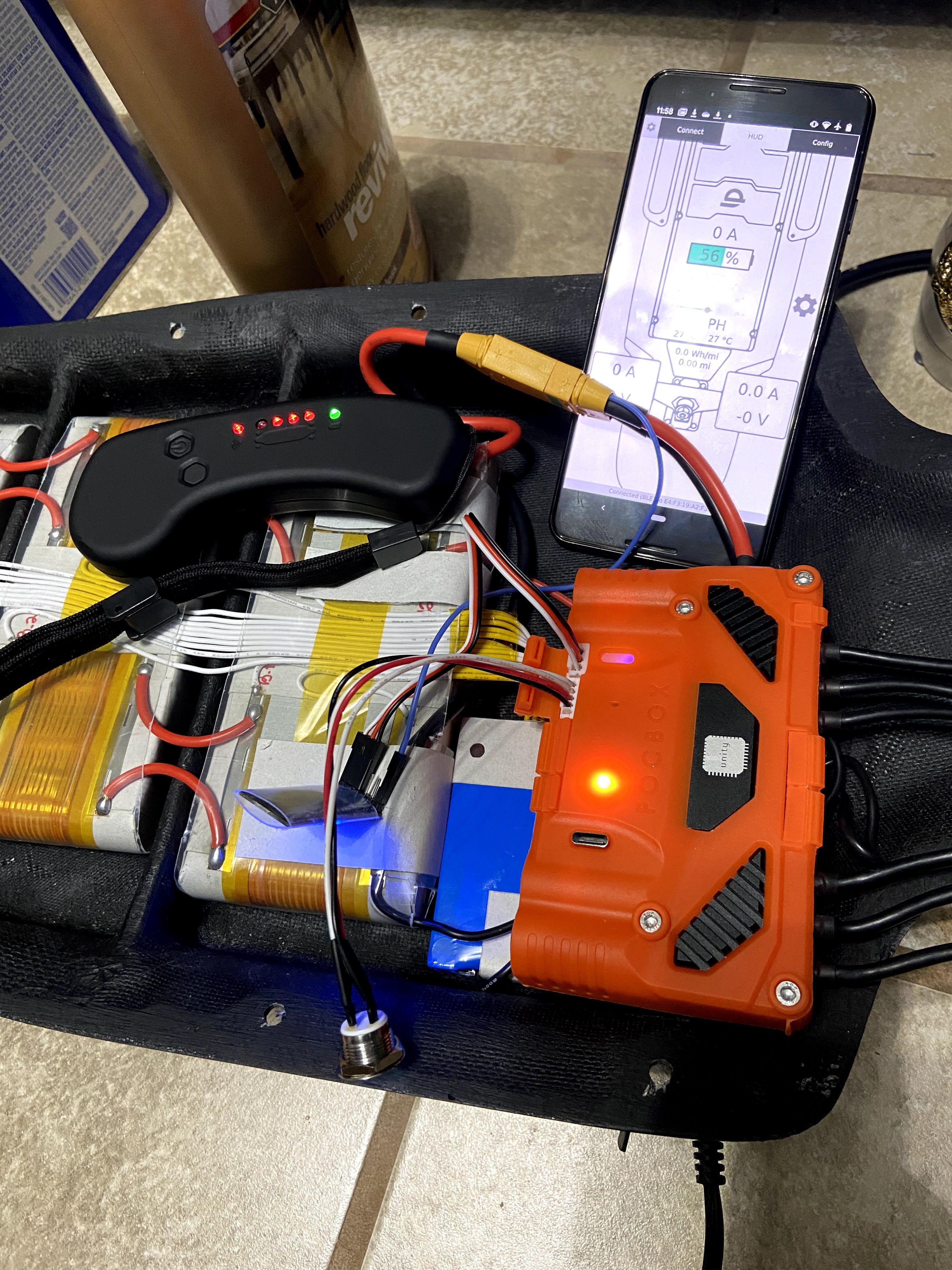

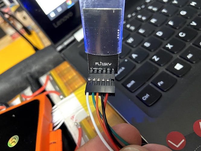

Hello everyone, I’m hoping to get some guidance on my first DIY build. So far everything seems fine, aside from my remote connection setup. It works, runs the motors well enough, but I’m unsure if I’m missing something with the app/remote calibration.
Forgive me if this is an amateur issue. I am indeed an amateur.
I assumed I set it up in UART, as I used the included cable (with the VX1). I haven’t soldered the battery wire to the positive lead yet, I have to splice that in tomorrow.
Currently I’ve gone through the motor detection wizard, seems to have saved all those settings. Does the remote calibration not work in UART? Would I still be able to program and save the throttle curves?
I did make sure it was receiving RT data, but still no dice.
This isn’t a build I intend on tinkering with too much after it’s done, so I’m hoping to get as close as I can before I close everything up and do cable management.
Specs:
12s4p Samsung 30Q
Haggydrive (6365 190kv 60A max sensored)
FOCBOX Unity
Flipsky VX1 (using included cable that seems to follow the wiring diagrams of the remote and Unity)

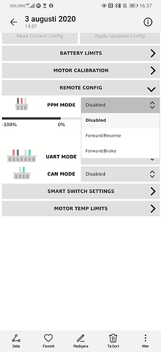

Set mode to UART and baudrate to 115200, see if it helps.
You have to set up your unity without it, go through motor detection and app set up with the receiver disconnected. Once everything is done, turn off and wait a few seconds for good measure, then connect and test.

I thought my VX1 was playing nice with my Unity and even got 30 miles or so under my belt with that setup before it locked up my wheels at high speed resulting in broken bones. I was using UART for the connection. During troubleshooting after the wreck I switched to a mini remote over PWM and the issues completely dissapeared. Be careful with the VX1/Unity combo and please consider using the PWM servo connection instead of UART. There is something fishy going on with UART communication between these two devices (at least in my case).

I can confirm. Vx1 vesc4 model. For unity use PPM and the blue cable is just to have the battery level on the remote. It goes wherever outputs the battery voltage.

Just to confirm. Riding daily with Unity + Vx1 combo. PPM only. all good
PPM on VX1, UART on VX2. Both work with unity if you do them that way. I have both setups in my garage right now on my daily riders.

For setting it up via PPM, do I just use the 3-pin cable in the Unity box and set it up in the Servo connection?
I tried @Linny’s suggestion, but no dice. I’ll give the PPM setup a go.

On one board I have been using both. Just change 1 settings in the unity app to swap. Works fine.

Just as an update and a massive thank you to everyone here, the VX1 set up with PPM works perfectly so far. Voltage lead soldered into the battery connection, remote reads fine. Fine tuned the throttle curves in Current mode, and everything runs smoothly.
Haven’t run the board on a test ride yet (have to drill out the deck and all that), but remote-wise it seems fine.

I can confirm that Unity + Vx1 uart is a no go.
It screws with the built in bt module too!
PPM works great and is reliable on the unity.

VX2 on unity with UART works, just pain to work with.

I only use PPM on the unity with the VX1. I’m not sure what it was, but UART just carries some issues between the unity and some UART recievers. It made the original shitty vx2 completely incompatible and on some FWs I would guess the vx1 also just won’t work.
