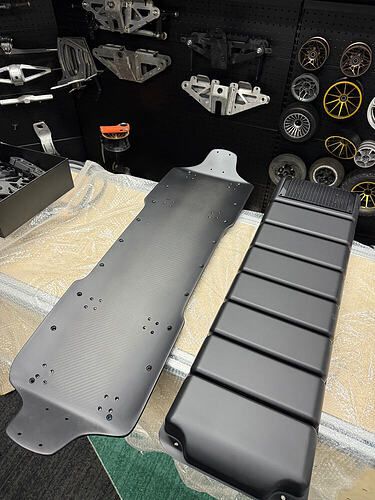

Deck/Enclosure: @Ean.esk8 phantom deck and enclosure with custom 3dp/fibreglass top enclosure(s?)
Battery: 18s12p (insert best 6.5ah cell @SternWake @Battery_Mooch @DIY500AMP.COM ) completely underslung. If my potentially misguided predictions are correct, if I completely fill the phantom enclosure with cells AND add a ‘gasket’ thick enough to allow another layer, I should be able to squeeze in 216 cells under the deck.

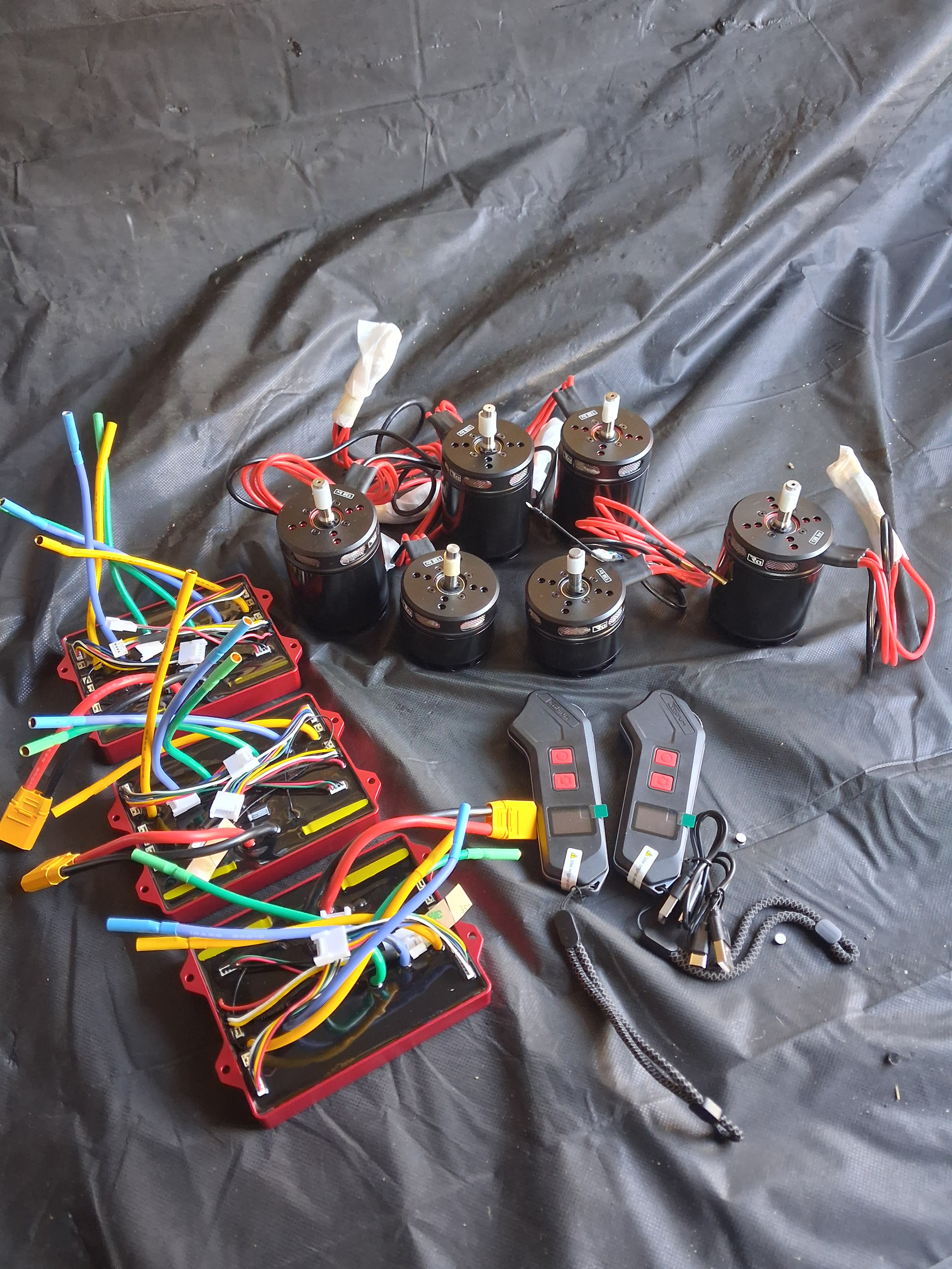

ESC/Motors: i’m REALLY hopeful that @Tony_Stark can hook me up with 4wd motors and escs. I noticed in the remote options on the M1S that you could switch to 4wd mode… i’m assuming that the escs in the M1S are already capable of hooking up with more escs…
Ideally i would love to run 6455 front and 6485 rear, NON VESC.

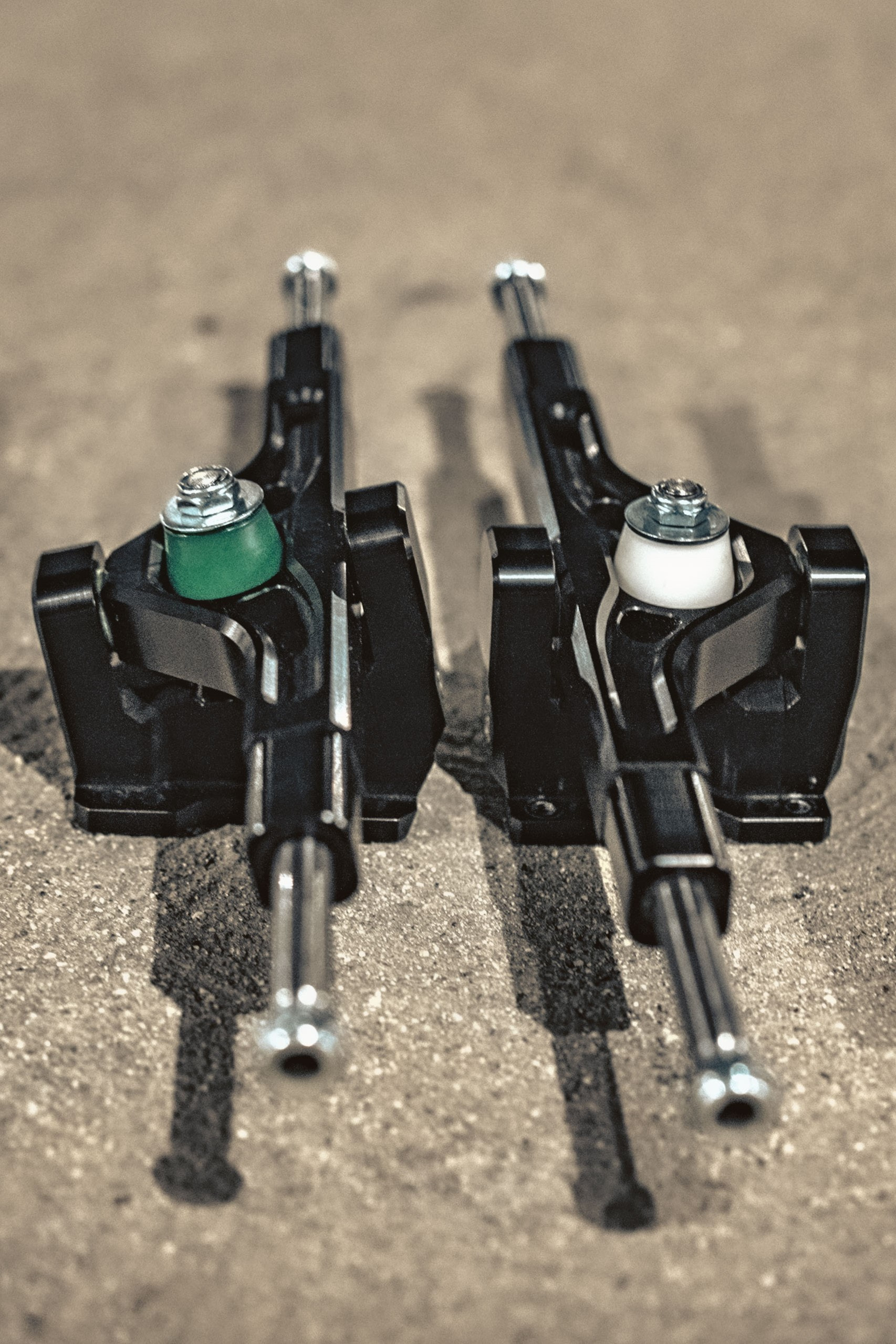

Trucks/wheels: I’d love to try out @Titoxd1000 dualities on this build. It’s gonna be a big boi so I think the 300mm hangers would be the go.

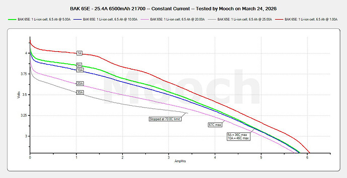

Interesting thought experiment on ‘best’ cell for an 18s12p RoadTrip battery, spending someone else’s money.
As of today the LinkData65P would seem to be the clear winner, but could one get their hands on 220 of these cells today?
When it is time to actually order the cells, will there be 7000mah nominal cells available?
At 12P, does it matter if it is an energy cell versus a power cell or some sort of hybrid that falls in between?
I think as of today the near horizon cells with a 6Ah nominal rating should also be in the mix.
I just want to put these cells out there as potential candidates in the beginning of this thread as I find it interesting to look at older threads, and often wonder what cells were available ‘back then’.

BAK 65E, 60D

@SternWake i’m definitely happy to leave the battery to be the final piece of this puzzle in the hopes that the ultimate cell becomes available. At this stage i’m thinking the bak65e is looking pretty good.
The board doesn’t need to be crazy in terms of discharge current, in fact i’ll be looking to have it dialled down as much as possible for max efficiency, but I still would still be looking for more of a power cell than an energy cell.

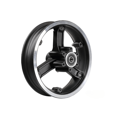

Hmm… 2 piece scooter hubs are kinda hard to find.. this was the only one i could find after a quick search.. looks like axle length could be an issue with these…

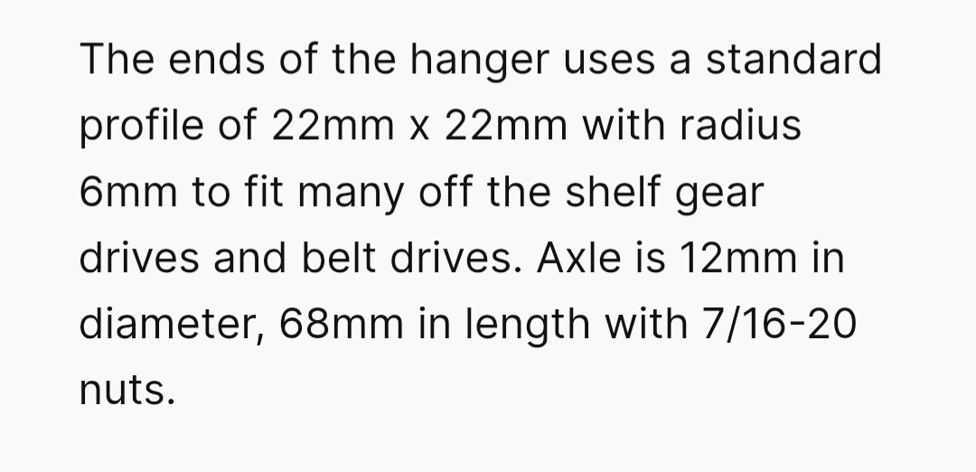

What is the available axle space on the 300mm dualities @Titoxd1000 ? Website says 68mm but is that including the thread?
The axle length is about 71mm now, that does include the threaded portion which is 14.5mm.
