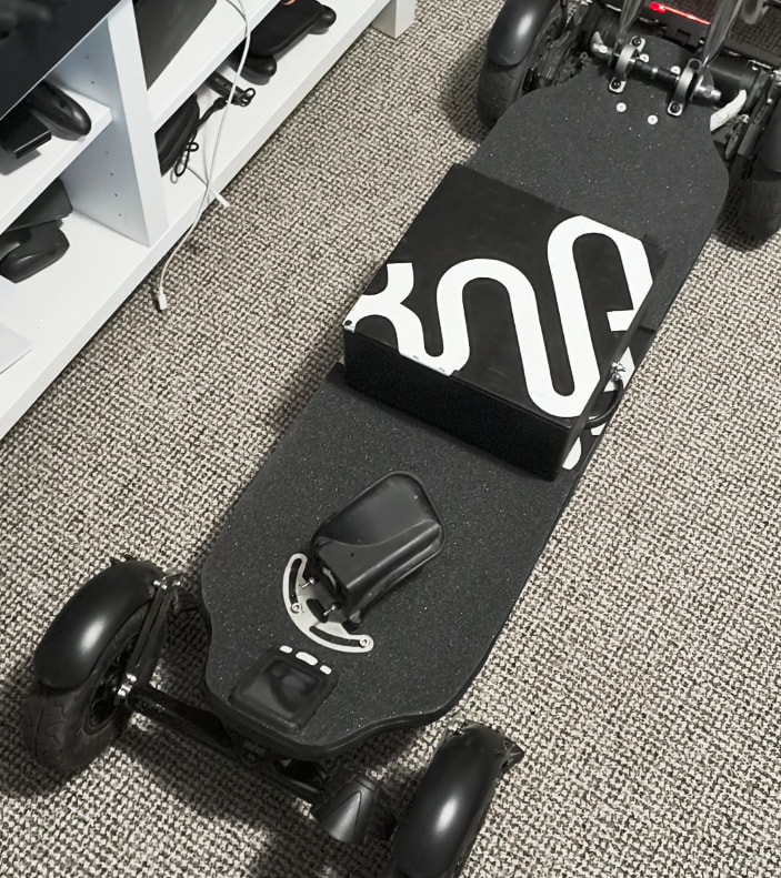

Board - Flux Motion AT2 NOVA with an additional battery.
Basic specifications:
Controller: VESC - original FluxMotion V6
Motors - 2x 6495 Reachertech 146Kv
Battery - 12S11P 18650 1615Wh + 12S10P 21700 2100Wh
Total capacity - 86Ah / 3715Wh
Charger - 50.4V, 50A, maximum 2700W
Trucks - Matrix 3 CNC
Gear Drive - Linnpower V4.3 13:47
Wheel rims - Matrix 2 Pro
Remote - Zmote double trigger
Bindings - Freebord S2
Telemetry - Voyage Megan

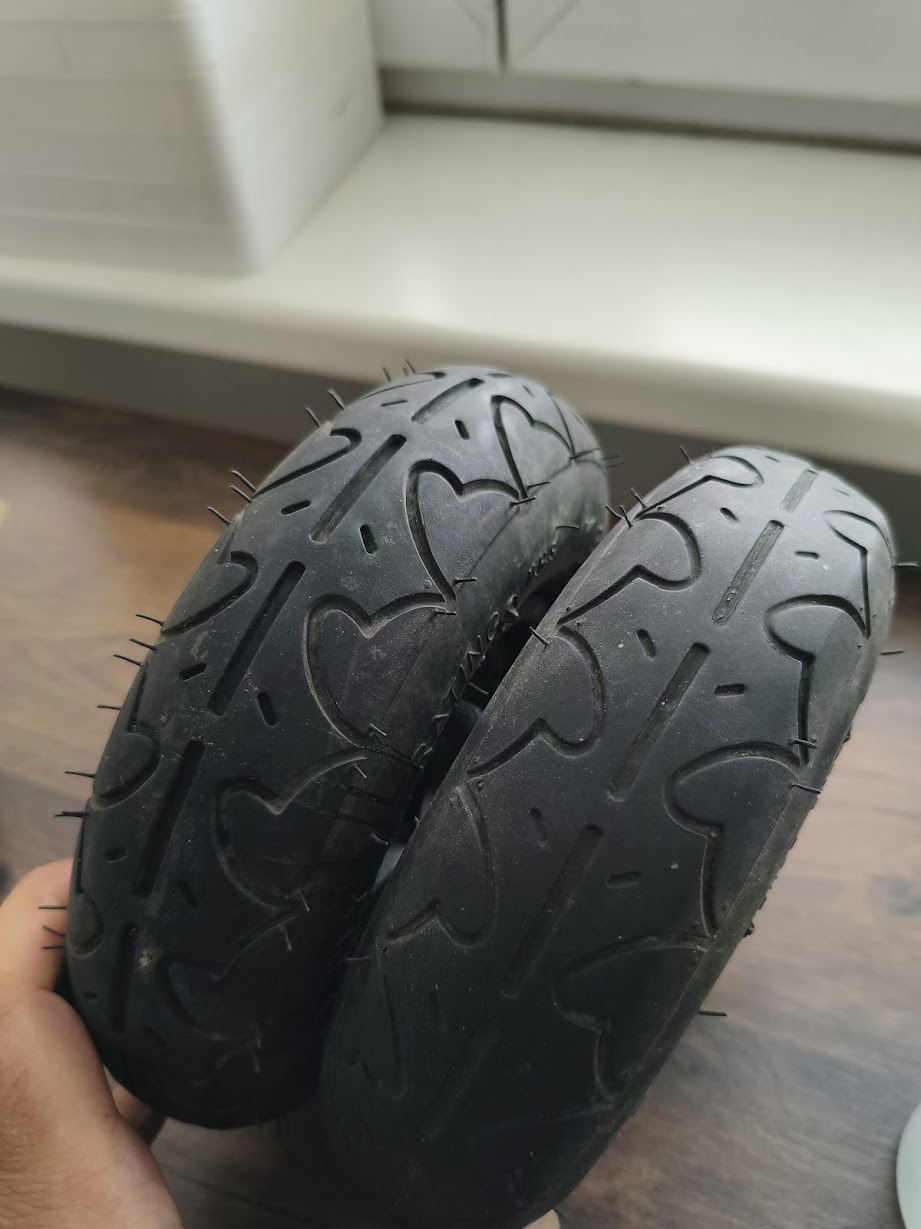

Tires

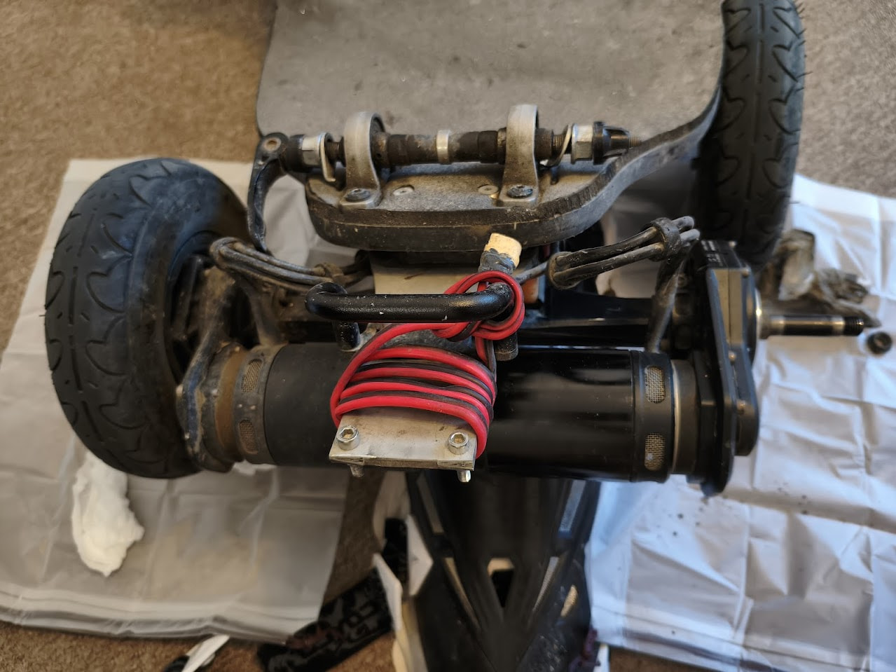

I bought Kenda 200x50 mm tires - Street Tire | 200x50 | 8" | KENDA – FluxMotion
Two of them needed balancing, but this is what they looked like after 4,107 km. The front tire is on the left and the rear tire is on the right. I could not have chosen better tires; I believe they could easily last over 5,000 km.

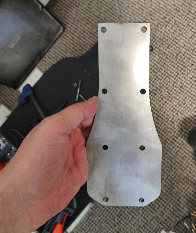

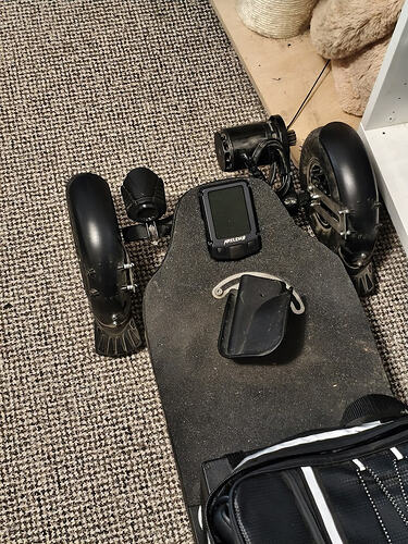

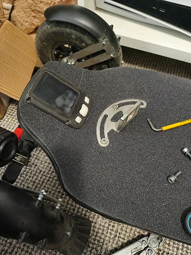

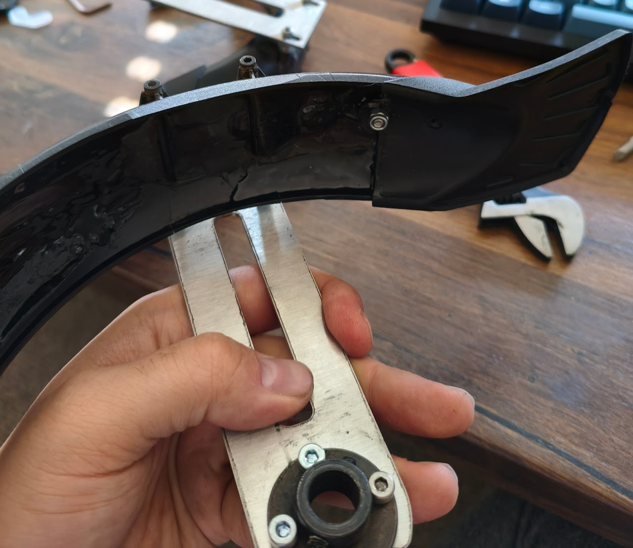

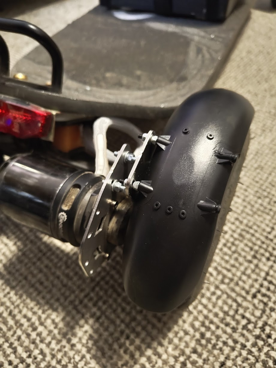

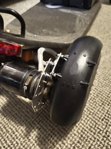

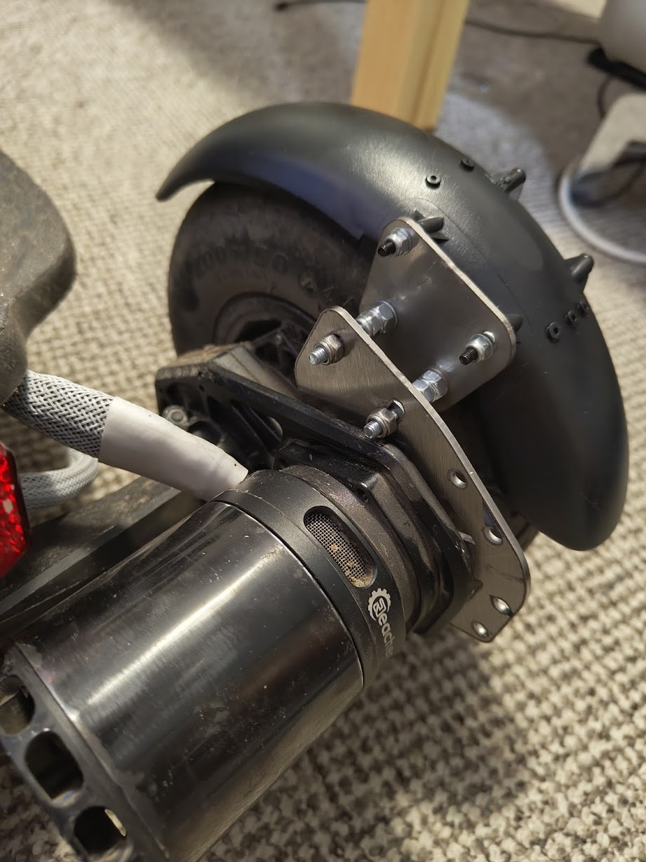

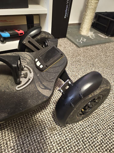

Mudguards
I made the mudguard mounts myself. I designed them in Fusion 360, made the test version on a 3D printer, and had the final version laser-cut from 3 mm stainless steel. The plastic part were bought on AliExpress, and during the trip they turned out to be completely useless. Not a single one made it to the finish; they gradually cracked and lasted only about 800 km. The mounting system itself was good, but I will need to find a better solution for the plastic parts. I even tried pouring epoxy into the inside of the front mudguards, but even that did not help.

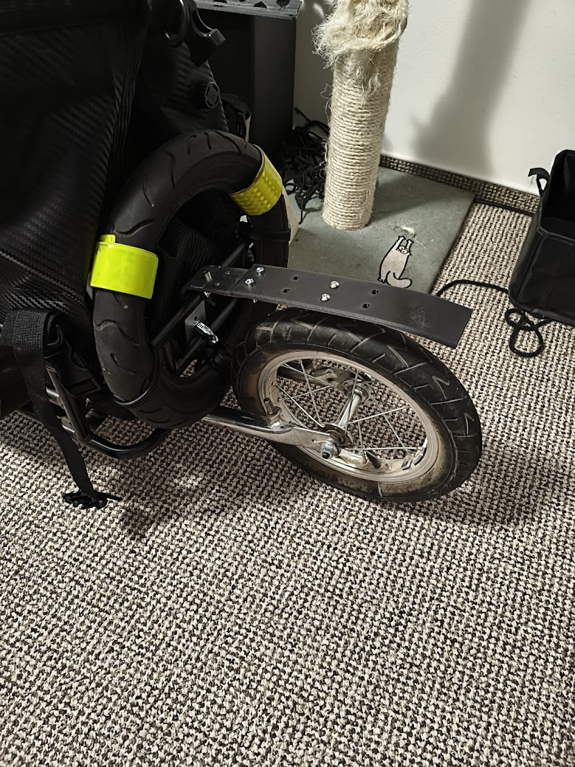

I also made a mudguard for the trailer, but unfortunately I did not put as much effort into its mounting. It fell off on the very first day, and I have absolutely no idea when or where. :smiley:

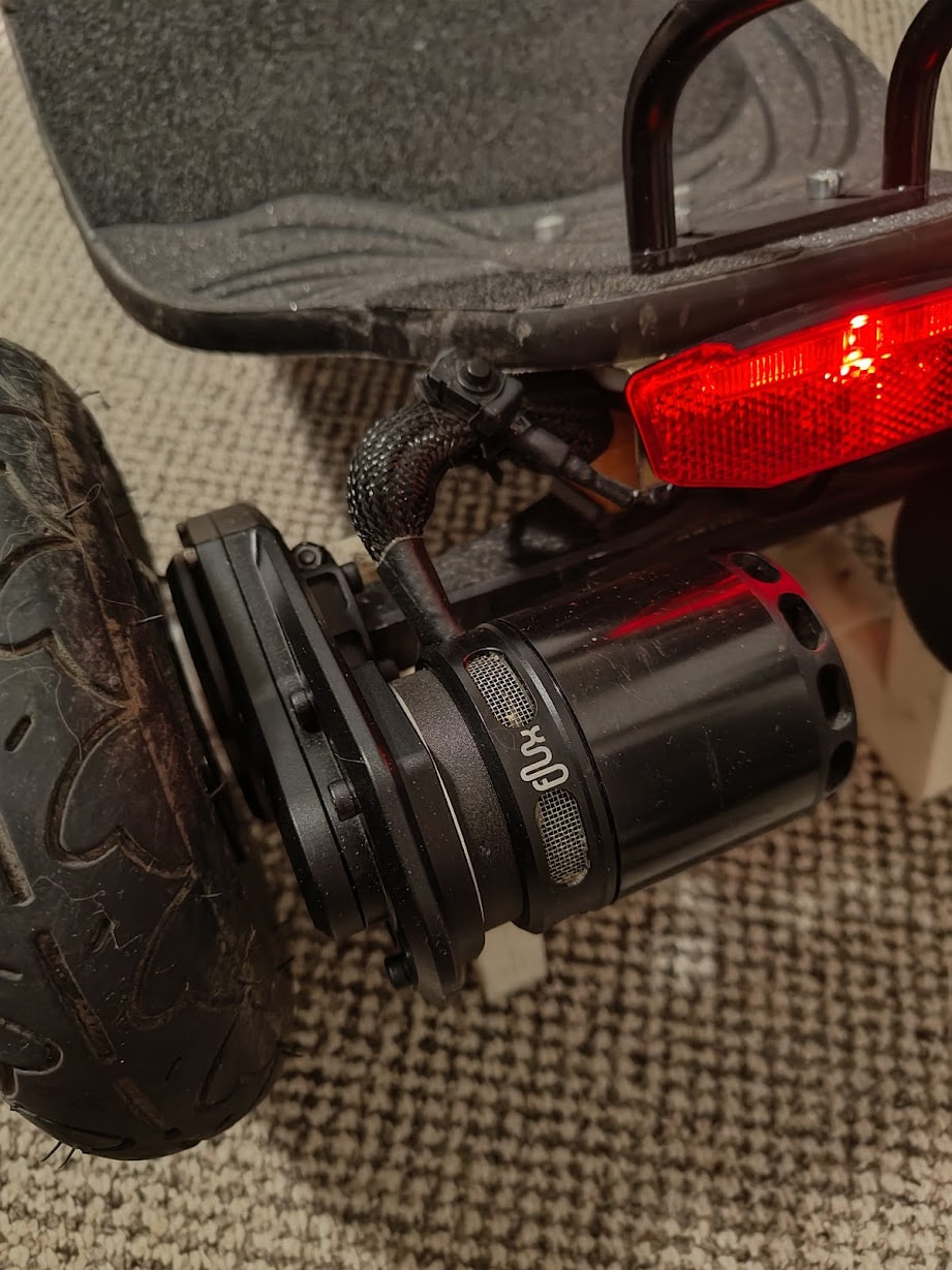

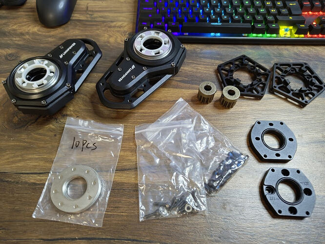

Gear drive
I got the gear drive from Linnpower because their system is 100% compatible with the parts on this Flux board model. It is a three-gear setup. It worked absolutely perfectly, and I can honestly recommend it to anyone. During the entire trip I only added grease twice, and after the full distance I found no signs of wear at all!

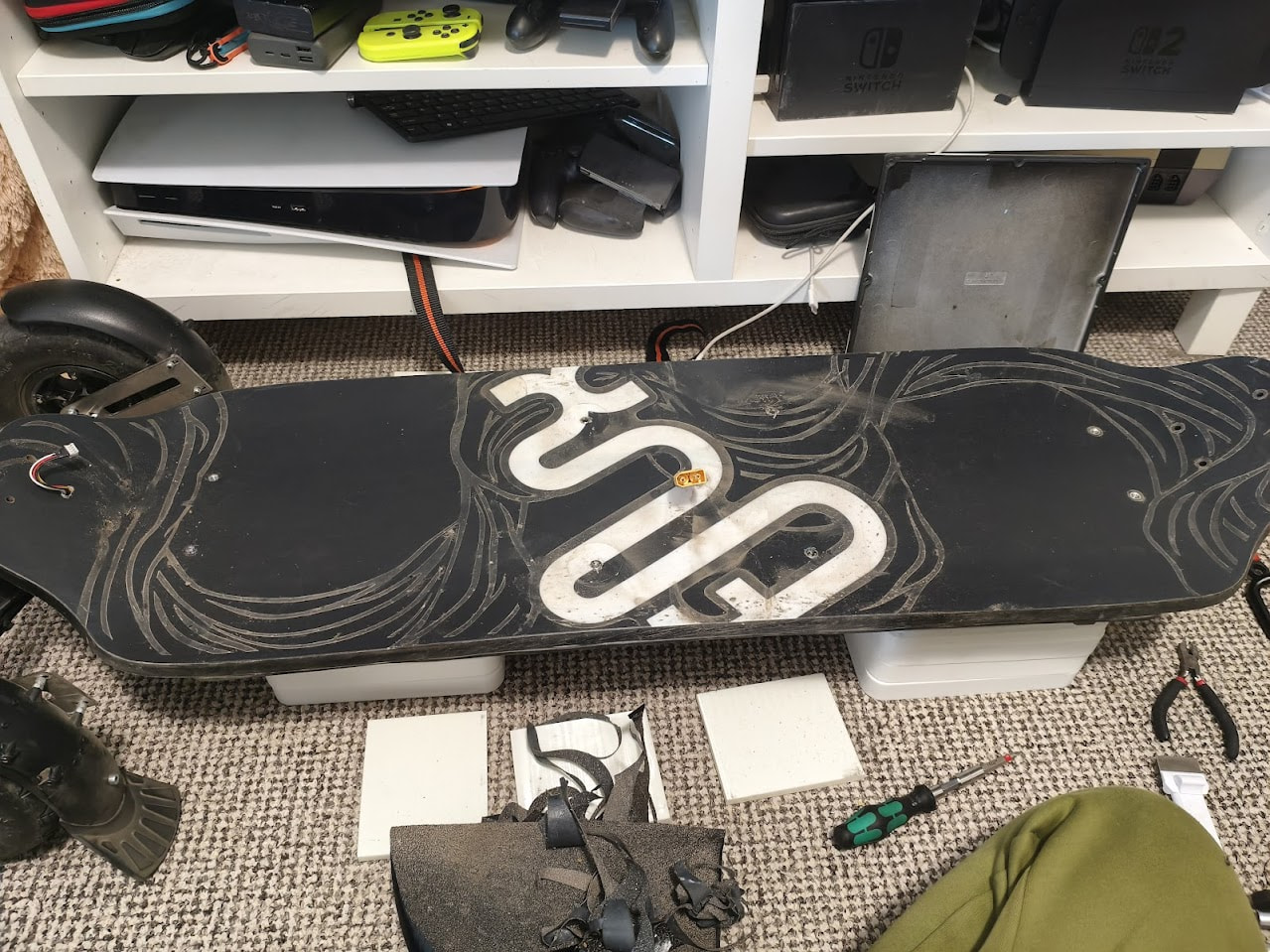

  • The entire board was disassembled down to the last screw. Every screw was cleaned, degreased, treated with Loctite, and put back in place. All connectors were secured with heat-shrink tubing.
  • The bolts holding the trucks were additionally secured with locking nuts. This turned out to be a good decision, because two threads in the MBS trucks stripped out during the trip.

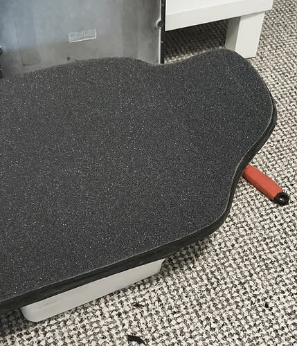

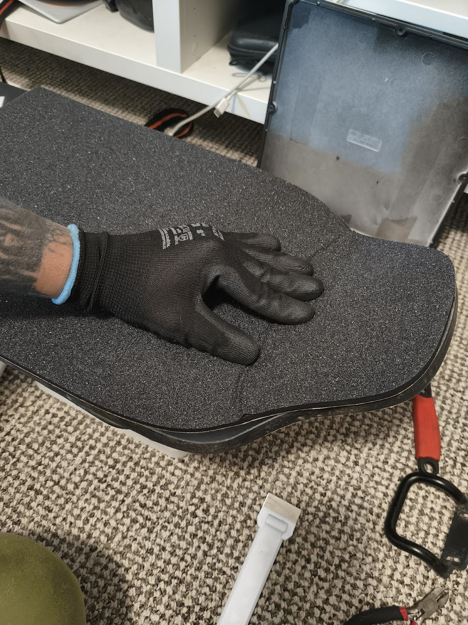

Griptape
Through a friend, I ordered YocGrip griptape made for Flux Motion. It was 6 mm foam griptape, which is the best choice for long-distance rides because it absorbs vibrations extremely well. Their template did not fit the board at all, as you can see in the photos below. Since I did not need griptape in the center of the deck, I shifted it and cut it myself so that it followed the shape of the board.
According to YocGrip, Flux Motion had never worked with them, so they did not have the correct dimensions. The design was made only from a picture on the Flux Motion website. Haha - maybe that detail should be mentioned on the product page!

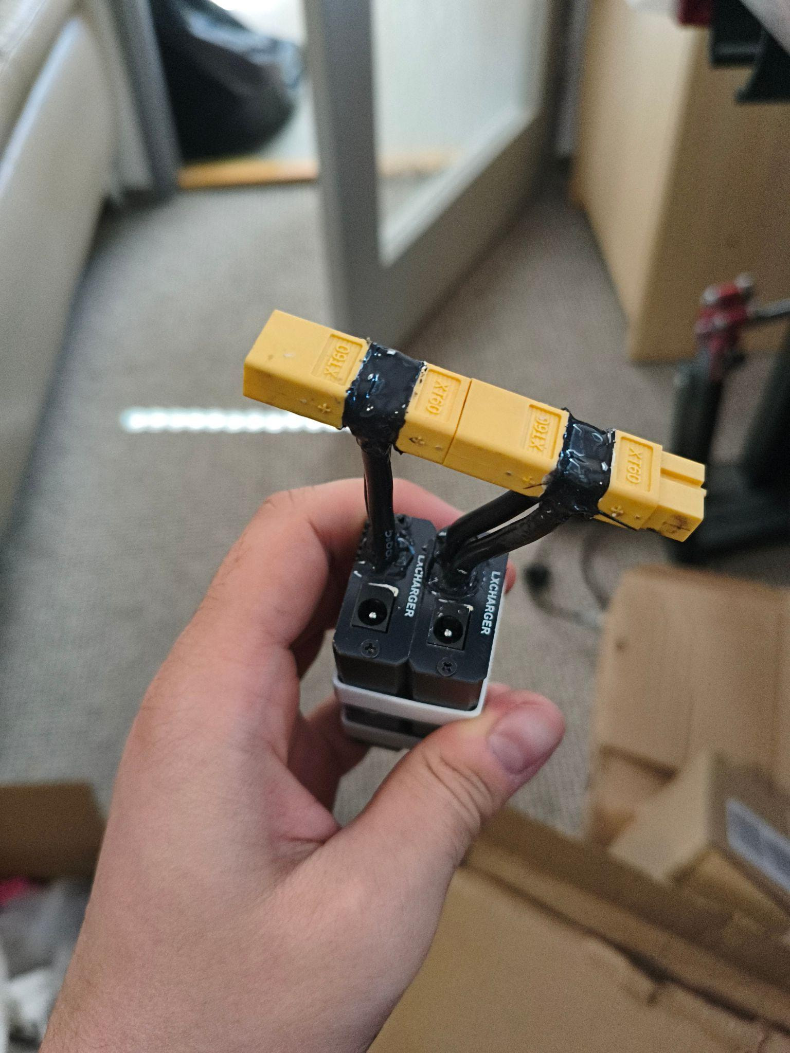

Charging electronics from the board
  • The Flux Motion board has connectors prepared for front and rear lights. I used the rear light connector and made a cable that I could connect at any time to voltage converters I bought on AliExpress - http://aliexpress.com/item/1005010250746178.html
  • The power connection was made with XT60 connectors wired in both directions, so they could also be used with the connector while the board itself was charging. It works great.

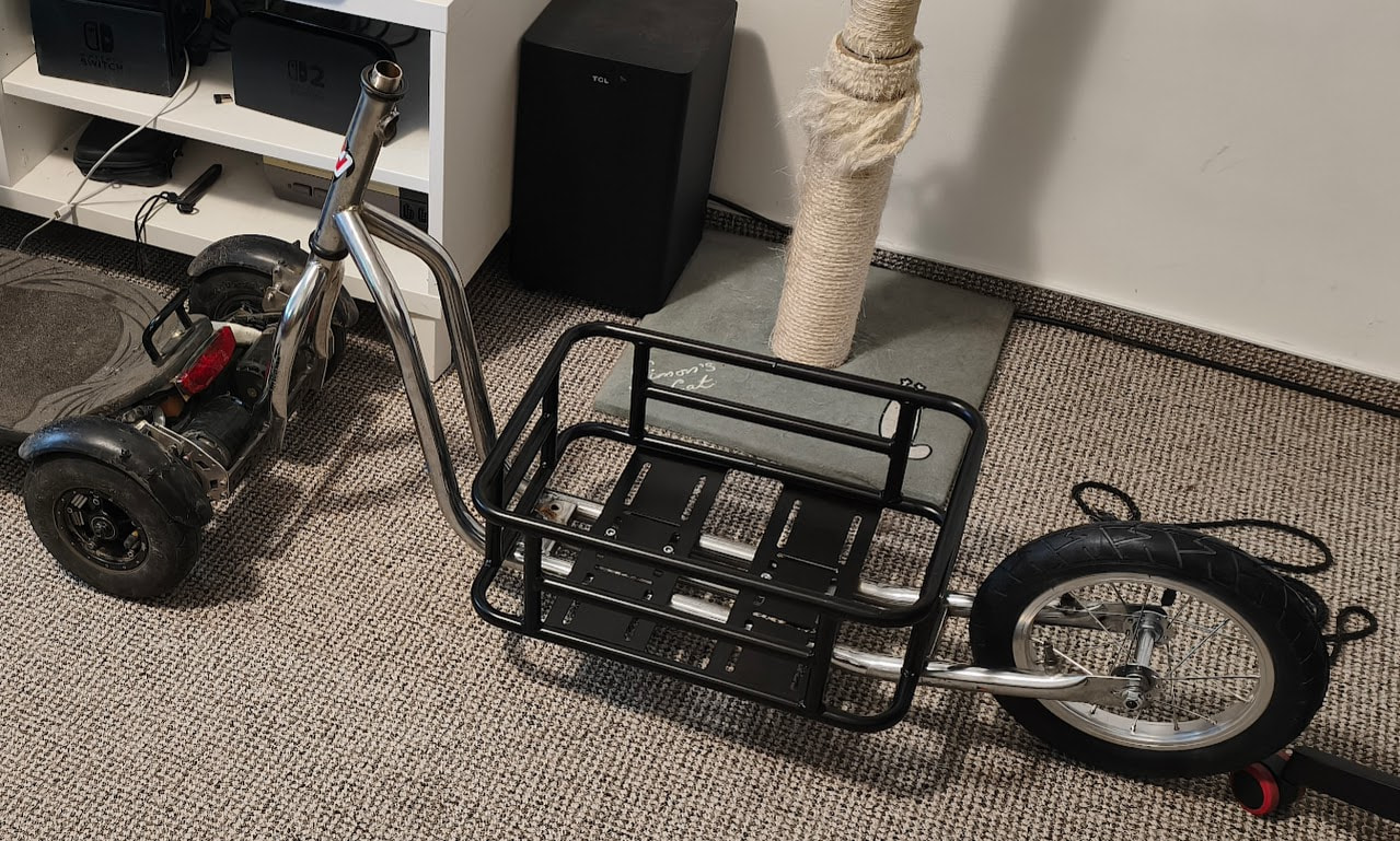

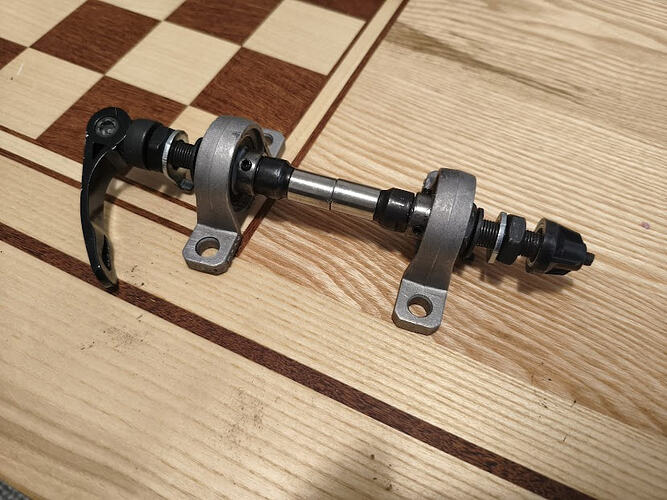

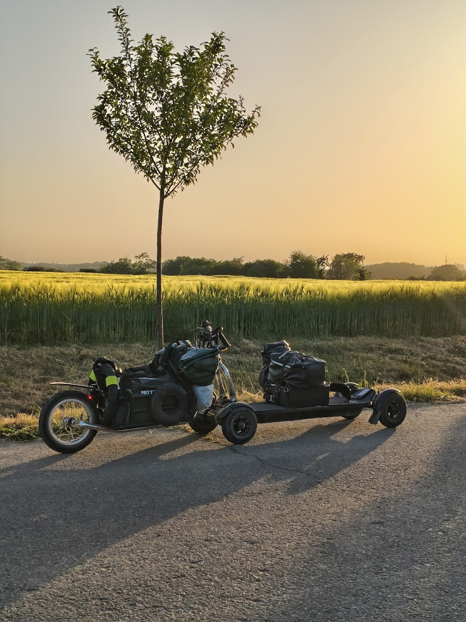

Single-wheel trailer
Since I needed a way to carry all my gear without wearing a backpack, I decided to build a trailer. I had seen people use trailers behind electric skateboards before, but almost always as two-wheel trailers. For the kind of speed and distance I was planning, that did not feel like the right solution. I wanted something narrower, more stable at higher speeds, and closer in behavior to the board itself.

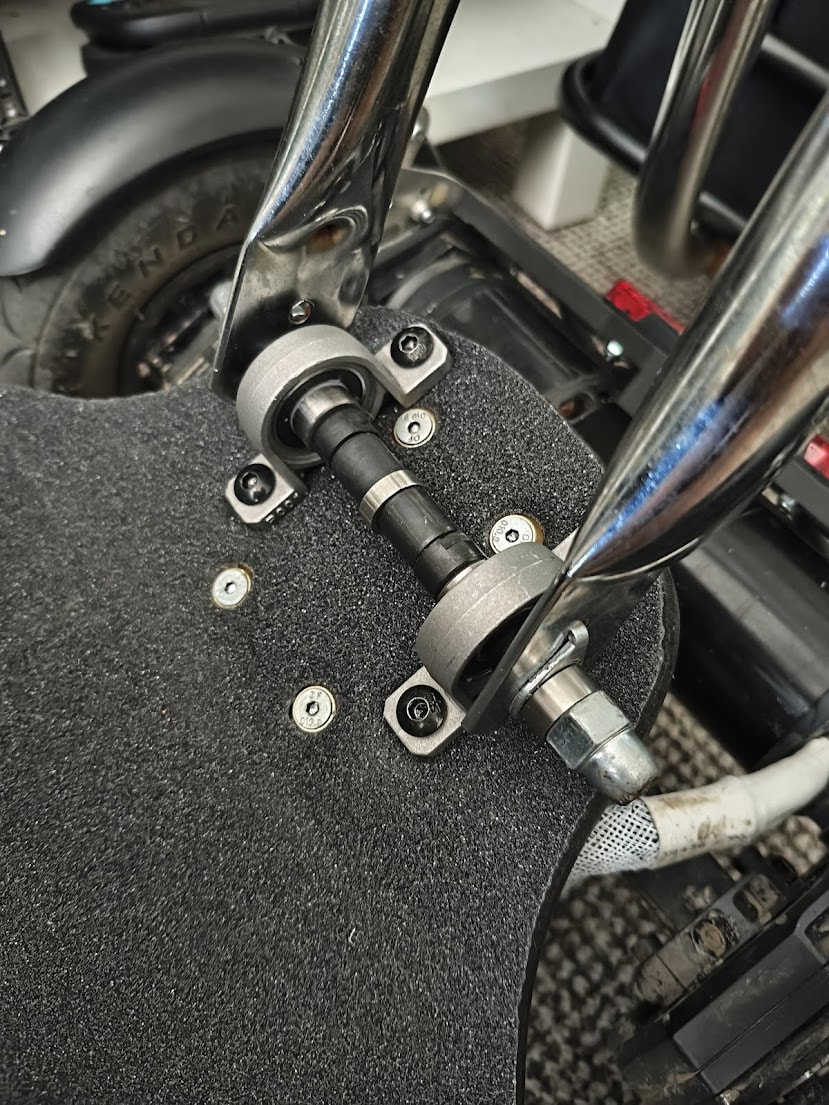

That led me to the idea of a single-wheel trailer. Instead of buying an expensive bicycle trailer for an idea I was not even sure would work, I used a second-hand children’s scooter for 10 dollars as the base. It already had a steering hinge, which gave it the movement I needed. I removed the handlebars and the original footboard, modified the frame, and mounted a metal cargo box on it. Inside the box I used a waterproof bag for all the gear.
I then made a custom mounting axle for the board, so the trailer could attach directly behind the deck. I also made a spare version of the axle in case the first one failed, but fortunately it survived the entire trip. The quick release visible in the photos was mostly there as a practical safety measure, to keep everything secured and to make sure I would not lose the mounting hardware when riding without the trailer.
Waterproof backpack inside the trailer - https://www.aliexpress.com/item/1005006580733164.html

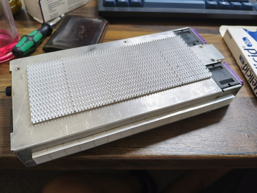

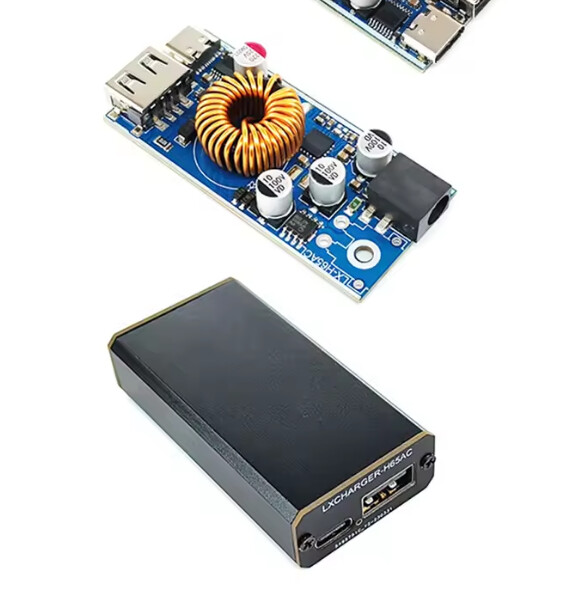

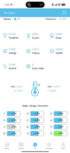

Battery and charging
I have two batteries mainly because of fast charging, not purely because of range. Not all cells can handle 50A charging at 12S without issues, and I also did not want to throw away the battery I already had when building my travel setup. So I connected the original Flux battery in parallel with my second battery. The original Flux battery officially allows a maximum charging current of 15A, although the BMS inside is rated for 30A. A friend and I replaced the internal wiring because the original cables would not handle more than 15A. This gave me two batteries that I can charge at the same time. They heat up less and also degrade less.
I added extra passive heatsinks to the sides and the top of the charger. I had already learned that when charging at 50A in outdoor temperatures above 30 degrees Celsius, the charger can overheat and shut down. I did not want to risk that, and fortunately it never happened during the entire trip.
Charger - https://www.aliexpress.com/item/1005006974558281.html
For charging from EV car chargers, I used this Metron adapter - [AC01] Type 2 to Type E / F (1 x 16A) - Metron Shop
It is the only adapter I found that can simulate the “Car connected” and “Car ready to charge” signals when plugged in. Some charging stations around Europe require those signals, and in this aspect the adapter worked every single time.

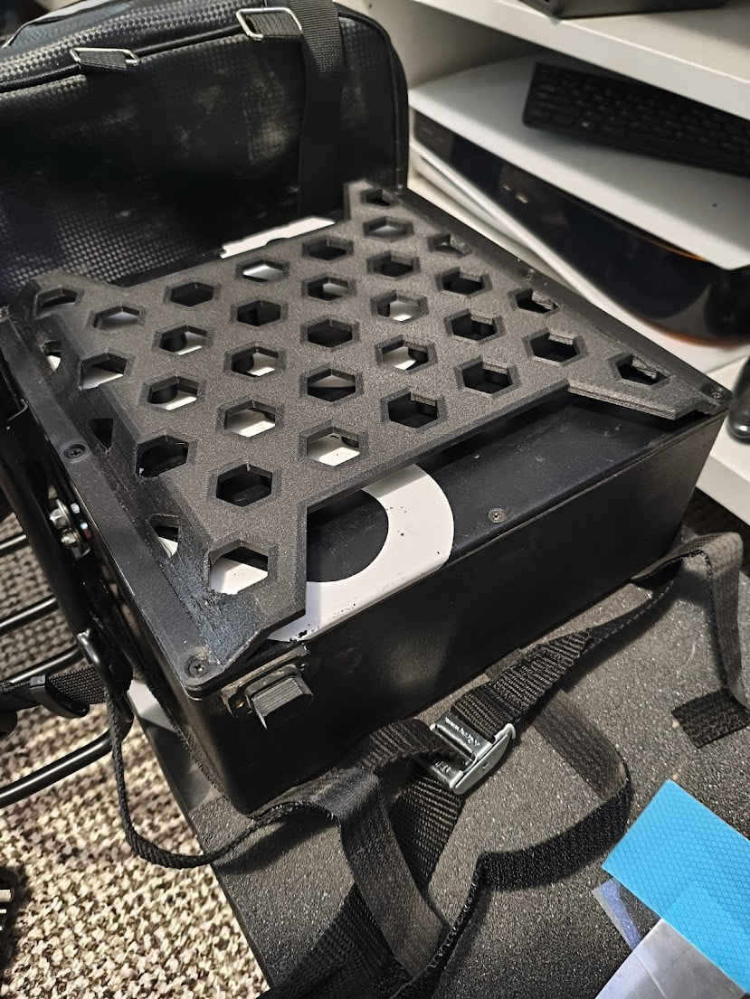

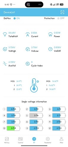

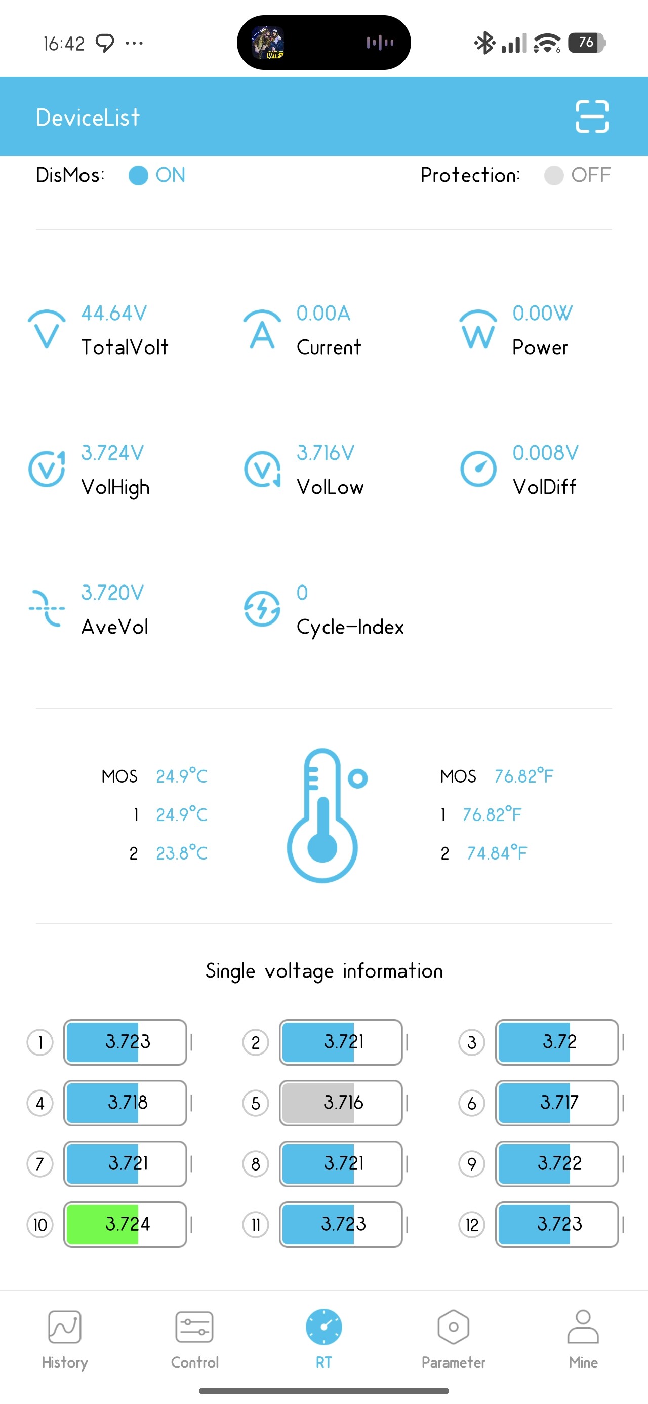

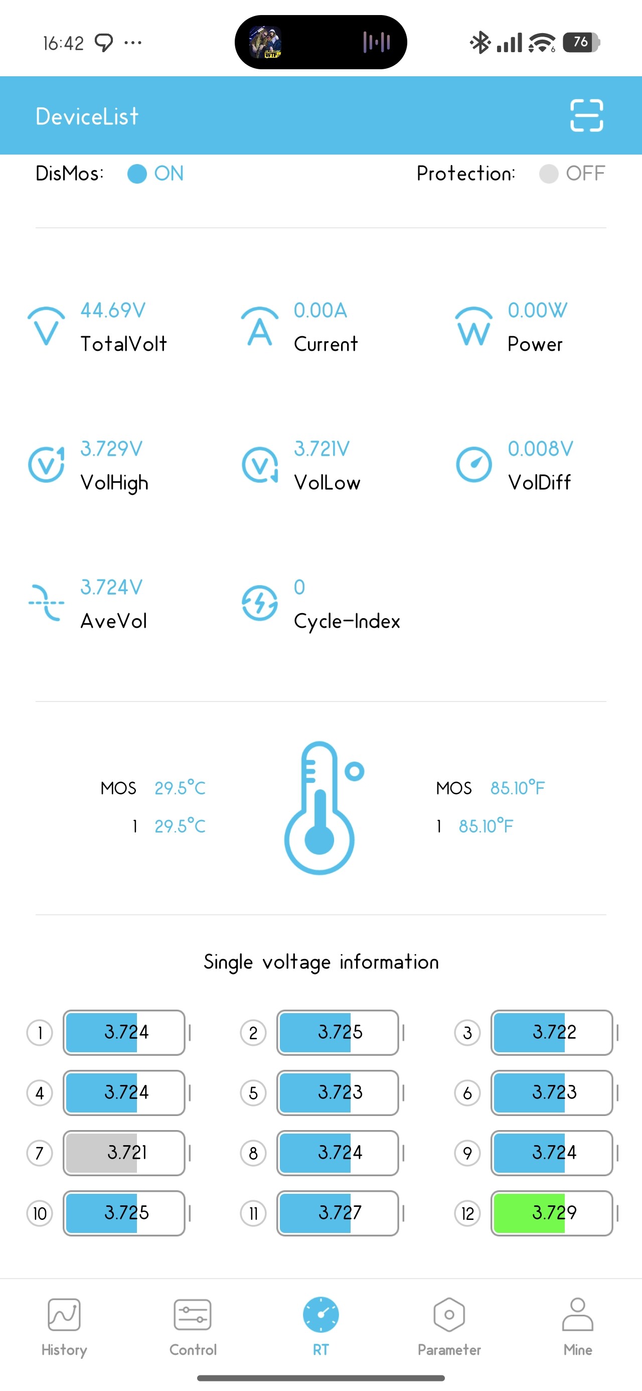

The upper battery inside the battery case is built so that the BMS is attached to the upper aluminum lid using thermal paste. From experience I already know that on hot days, and with repeated full 50A charging, the BMS gets extremely hot and also warms up the cells themselves. This solution may look a bit strange, but it works. For the same reason, I 3D-printed a spacer between the battery and the luggage placed on top of it. This allowed air to flow over the area where the BMS is mounted and cool it down while riding before the next charging stop. In this setup, the aluminum case acts as a heatsink.

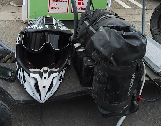

Protective gear
I never get on this board without protective gear, so I have a full setup.

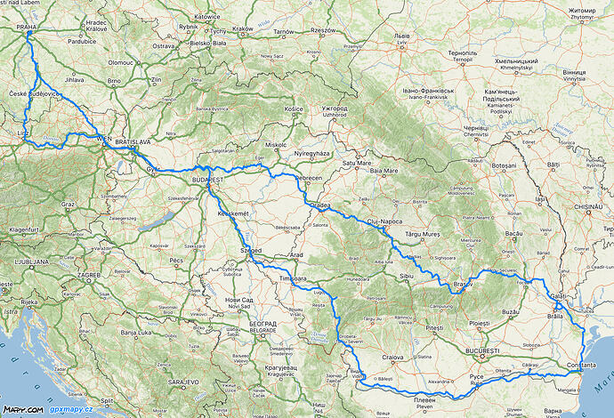

Route planning
I planned the route around EV charging stations using PlugShare.com. It has the largest number of car chargers from the widest range of operators, and it also includes real photos of the stations. Thanks to those photos, I could check whether a station had a Type 2 connector as a socket or as a cable. Since my kind of charging adapter cannot be used on EU stations with a fixed cable, I had to filter out only the stations with socket. Unfortunately, that detail is almost never clearly listed on charging maps.
I had a rough outline of the route in my head, so I looked for charging stations spaced about 100 km apart on average and planned the route around them. I saved each point using coordinates in several different formats so they could be used in different navigation apps if needed.
In the end I used only one navigation app: Ride with GPS. In that app you can select “Paved” as the surface type, and it genuinely works extremely well. If there is an exception along the route, the app warns you about it.
The process was simple: copy the coordinates of the next charging station, paste them into the app, start navigation, and ride.

The first casualties appeared on day one as well. Part of the rear fender broke off before the second charging stop. I quickly got used to the idea that fenders on this trip would die one by one, and that this was simply the price of the pace. At least the charging stop in Ceske Budejovice had a very human touch: the station attendant brought me a chair so I did not have to sit on the ground next to the board, and the local bike paths genuinely surprised me with how smooth they were and how well they were hidden away from the main traffic. In the evening I reached a campsite near Cesky Krumlov, pitched the tent, plugged the board into power, and assessed the damage for the first time.
