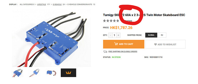

Hi Guys Randomly I found this.
Turnigy SK8 V2 60A x 2 3~12S Twin Motor Skateboard ESC | hobbyking
Have somebody any experiences with this unit?
@frame they’re back!
Specs:
Type: Turnigy SK8 V2 80A 3~12S Twin Motor Skateboard ESC
Input Voltage: 3~12S (11.1V~44.4V)
Continuous Current: 60A x 2

Thanx, Mostly i saw this info on HK web. But it looks like platic case. Or it is aluminium? Bought it and using it somebody from forum members?
added it to ESCs based on the VESC
aaaaaaaaaaaand they removed the vesc word on the shell :joy:
mine was still unique
this is how they used to look like if anyone doesn’t know
do search, how much u wanna bet the “dual” is just two single slap together that’s canbus linked, and who cares about v4 hardware anymore?
that one also seems to be VESC6 based whereas the dual one for sale now is 4.12
no way they can do 60a cont. period
some people doesn’t know how physics work, if u can’t do 60, u can’t do 80. its like saying running 140 cont. on unity on its own is possible, its not

Website actually claims 80A
