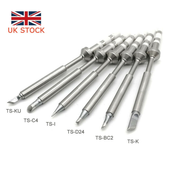

Good to know. Also got the TS-K here, hm
I tried using bc2 for xt90s and 10 awg. It didnt work well
c4 worked for me. Something bigger would be nicer, Ill bust out the calipers in a minute and compare sizes
nvm you can see the difference here
D16 with xt90 and 10awg for size ref
I wouldn’t go smaller than that
Pardon the silly question, but why isn’t 1 flat tip and 1 pointy tip enough for everything?
cause I can solder 100 pins in 20 seconds with a bevel tip that’s the width of 2-3 pins
there are use cases for every tip that make it better than any other tip
