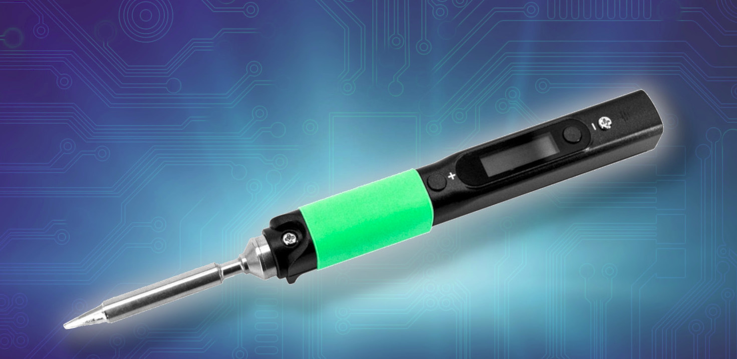

I’m convinced!
The ts100… but better
With shipping the Pinecil from their site was $37 to the states. Amazon has it now for $35, fyi

My one and only gripe about the Pinecil (and all the TS100-style irons that take the same tips) is that they don’t have a beefy chisel tip option. If you want beefy, your only real choice is the C4. I want a chisel bigger than the D24, something like a D4 or even D5.
Pinecil ($35) + 60W usb c pd charger ($27 w/ 2m cable) gives you a super sweet little setup.

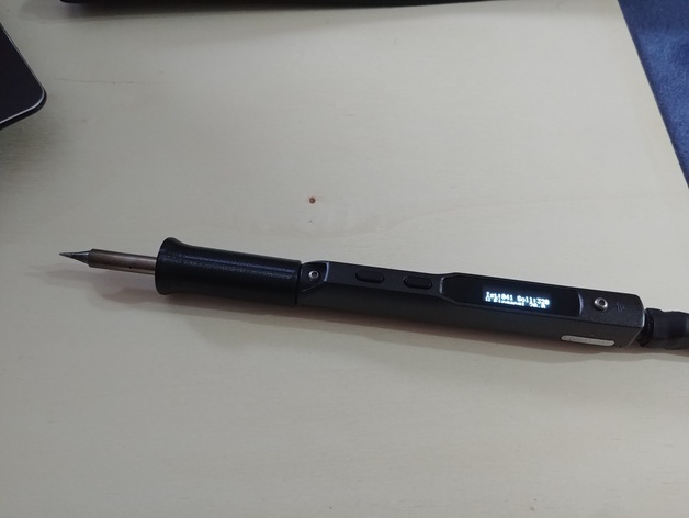

Can you send the STL file for this plz?
Here they are. But search for ts100 grip on thingiverse. There are other better designs now :slight_smile:

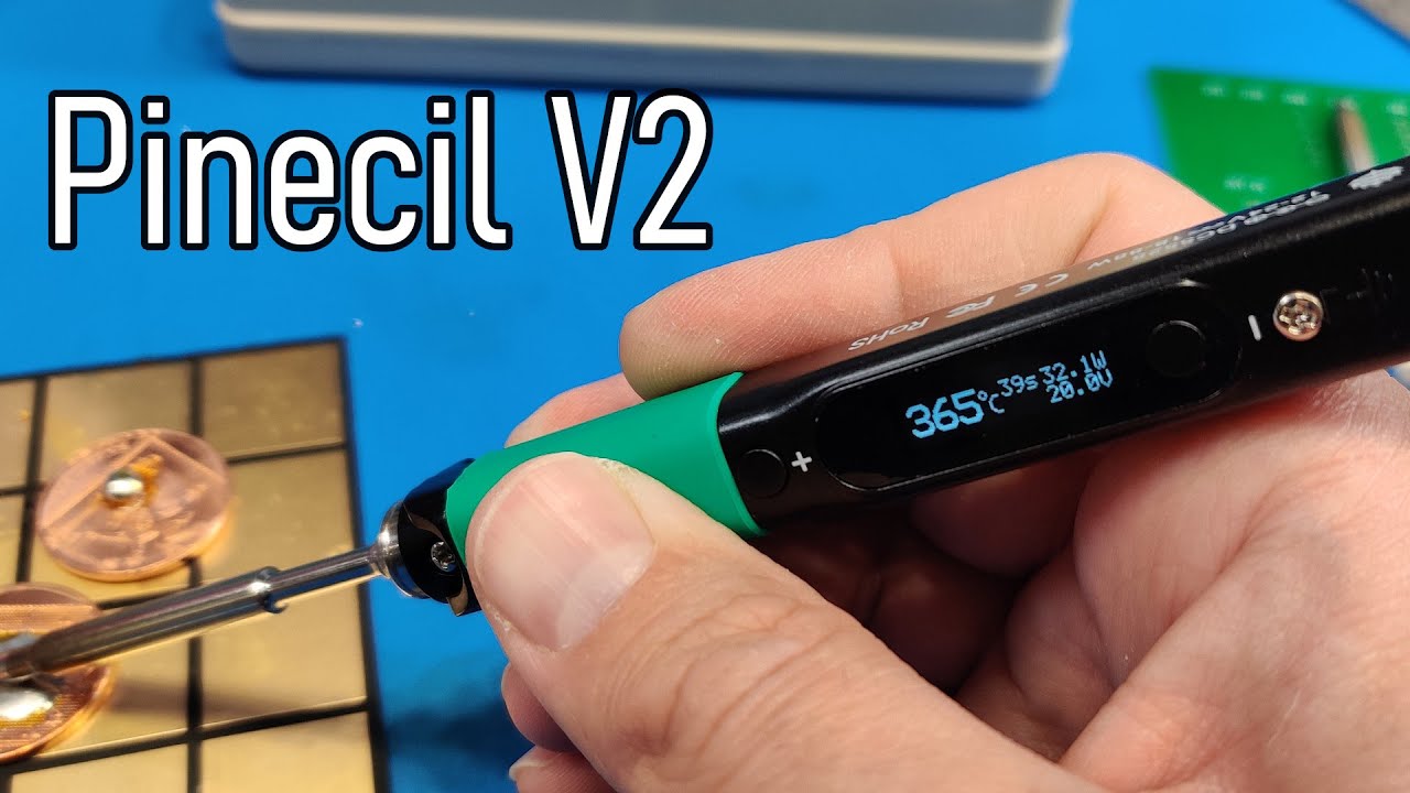

V2 coming soon?

Does the pinecil take ts100 tips?
Also, already owning a TS100 is there a good reason to switch over?
For a basic user, no.
it is just cheaper and better overall than ts100 or whatever they change the name to.
Same power but with open firmware.
I would be shocked if they had different connectors. (lol)
The TS100 just runs on IronOS which AFAIK is open.

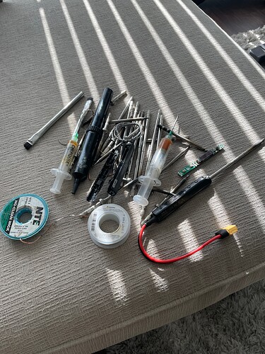

Not sure if it’s been covered here but T-12 cartridges work well for this as well. Much less expensive, just a few bucks each. Last year I bought a variety pack with 11 tips for $20.
Their length is a little awkward plus the flange on the dedicated ts100 tips offer more support but if your broke( like me) or you just want a variety of tips that you might need for infrequent use then you just can’t beat the T-12 tips.
If I’m at my bench I use my variable power supply to power the iron. I set as high as I can before auto shutdown. That’s about 28V. I see SIGNIFICANTLY more power than a 18V laptop power supply. Think I was seeing something like 80W in the power supply’s display while it heats up and while soldering large joints with lots of thermal mass. Can’t stress the difference it makes enough. Good thing is you won’t fry it from too much voltage so have fun.
One more thing. Those two small set screws are critical for electrical, mechanical and thermal stability. They need to be tightened each and every time you change the tip. My first one died because I failed to tighten the screws properly. Unfortunately, they are easy loose and or strip the hex head on them. I did the old Dremel trick to make a slot for a straight screwdriver. Also rummaged through my box of screws to find ones that fit.

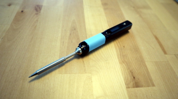

I could not use my ts100 with that length. As is I already constantly burn my ring finger on the very edge of the flange when using mine. Luckily the very base of the tips don’t get to the full temp so I only get a very slow forming first degree burn from that flared part.

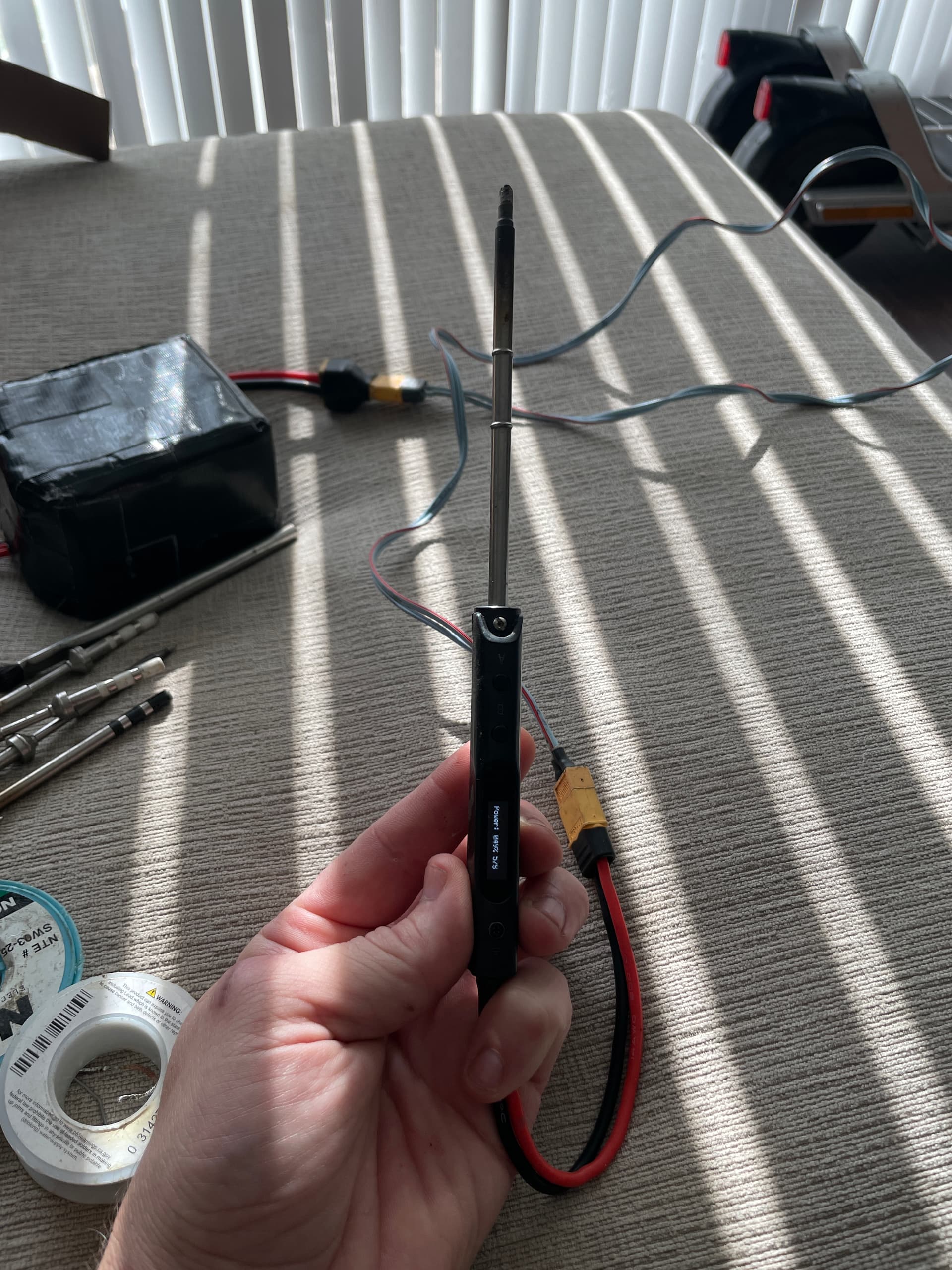

18V vs 24V might not seem like much of a difference but for this application it makes a huge difference, so much so that I even made a 7s1p pack out of extra 18650s.

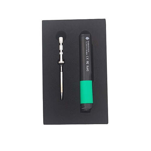

I didn’t really pay attention to the voltage but the listing does highlight the fact that it is an “upgraded” power supply:
