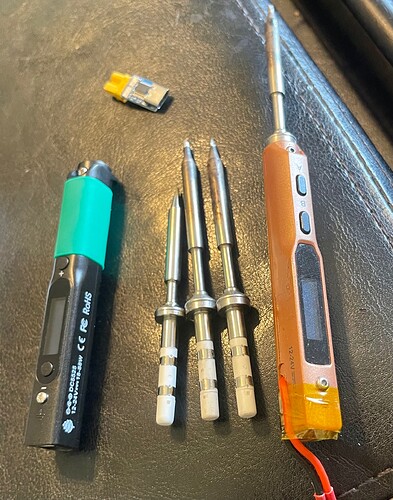

The Pinecil knockoff I tried earlier tonight only has a usb-c connector. USB PD is designed for power but of course a decent rated cable for a Mac Pro makes sense. The full length TS-100 tips works A-Ok in it & have a couple of short tips for the shorter cover that it also includes.
Only have a Nintendo switch power supply to hand but it whooshed straight up to 350c in seconds & has a ceiling of 450c.

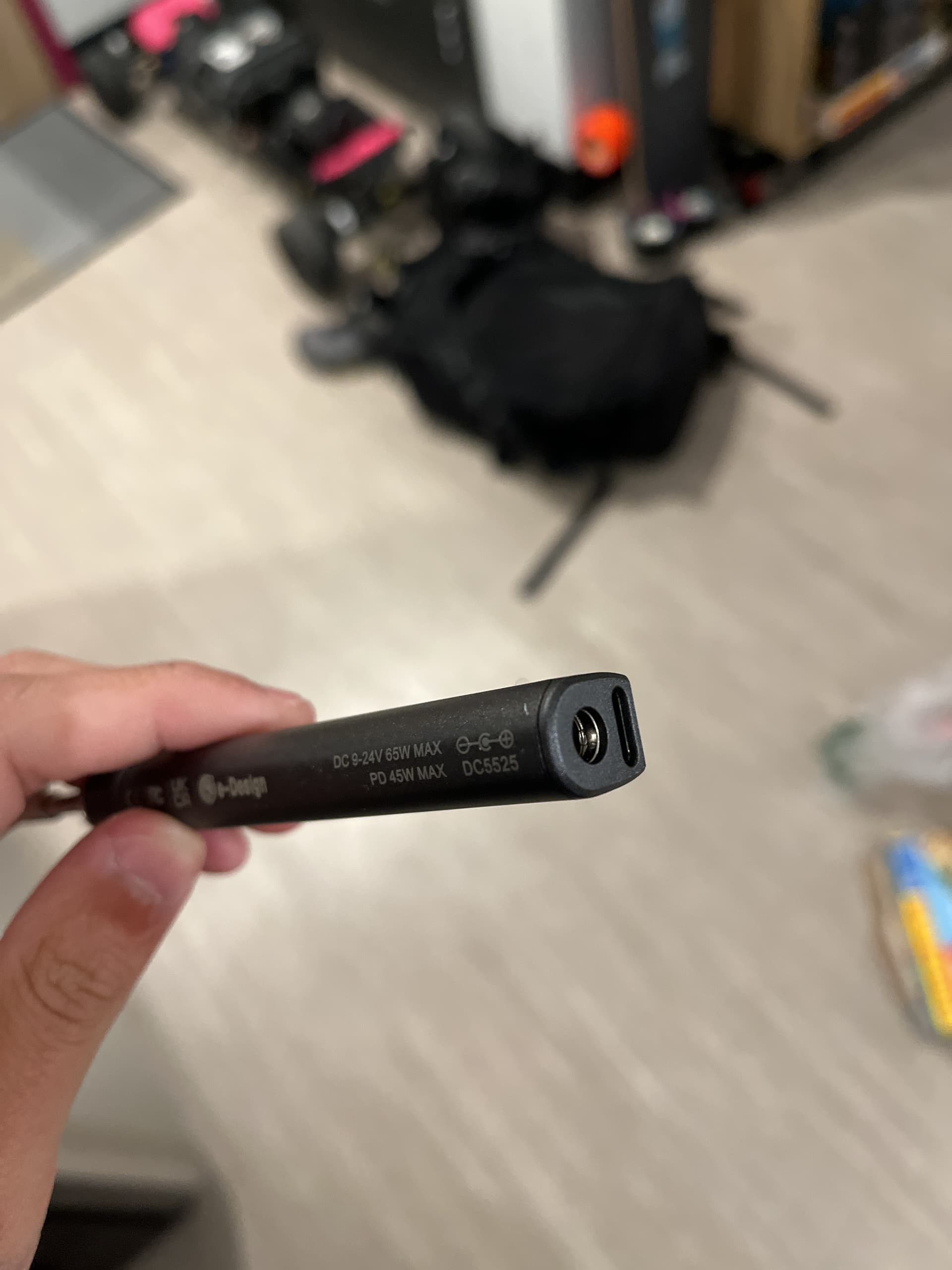

USB PD 45W or 65W DC jack

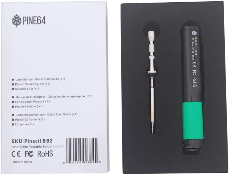

I did see a Pine64 iron for 40$ on amazon. It has dual input options.

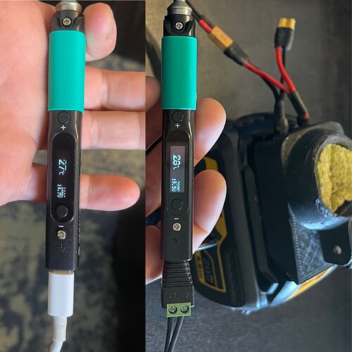

Here it is powered by a 100w MacBook usb c charger and a 20v dewalt batter, using both DC and USB jacks.
Here is a race, I installed same iron tips. Both running from same 20v dc batttery. I didn’t have the same target temp set, but they both hit 280c in 9 seconds.

I think the Pine64 is better, cheaper, neater. Doesn’t come stock with a full size chisel tip though.

I would get the Pinecil. I got the red version and it was a nice, quick deal.

Agreed, Pinecil is great. More or less the same as a TS100. You can run the same FW on the TS100
I run mine with the USB-C connection but you need a high power adapter like the one I use meant for a portable monitor.
