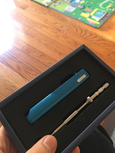

ordered this kit cause I was bored lol
could technically add the electronics to a board… just carry the handle to plug in lol
Not pressing hard at all, but the springs do seem kinda iffy
Got it in the mail today, feels really light and cheap but we’ll see how it performs
