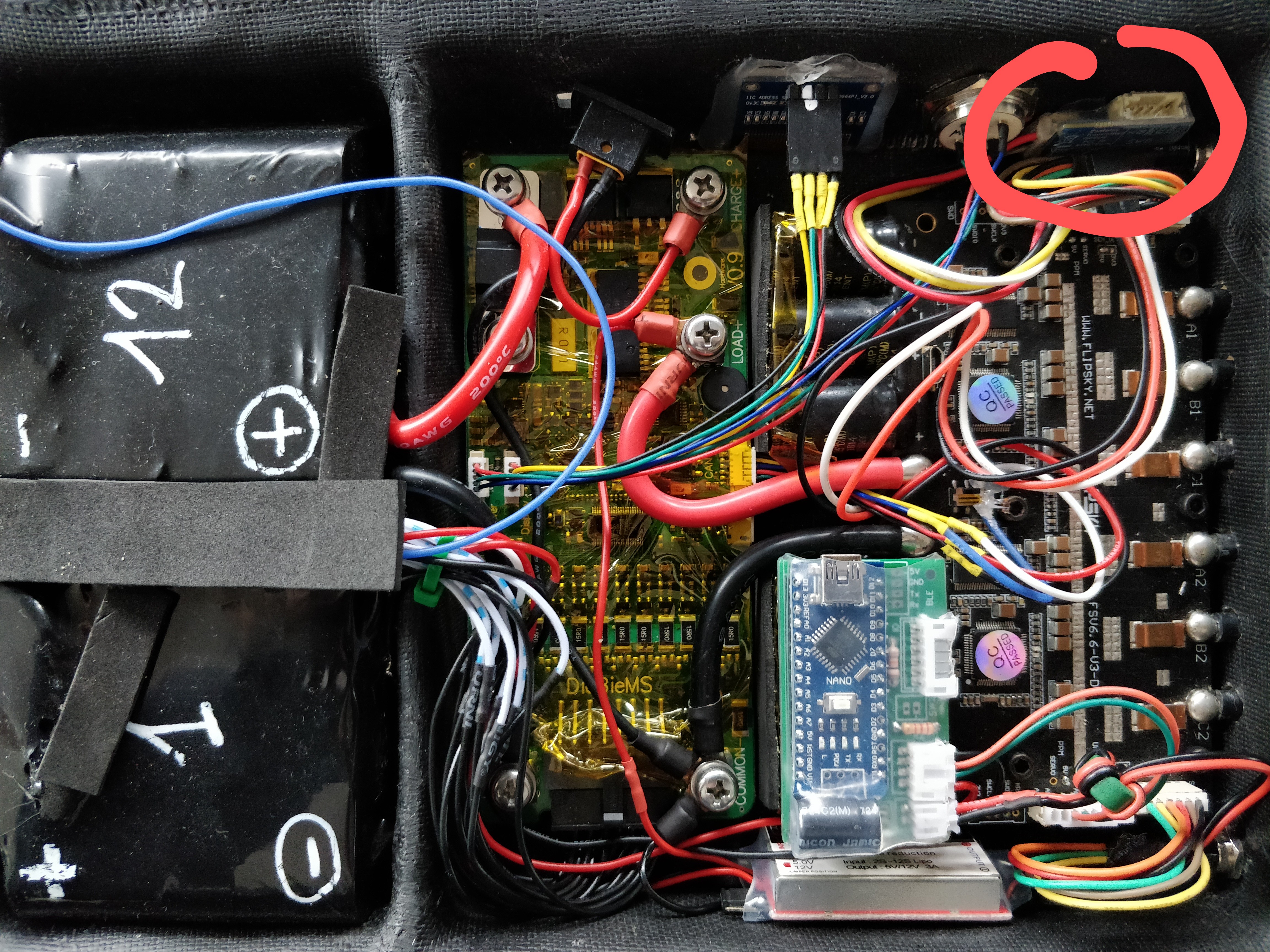

I retain this post as the most useful amongst other users feedebacks (and some others about receiver alternatives) :
  • Deck : Trampa Holypro
  • Enclosure : eBoard Peru (should be glass fiber, TBC)
  • Placement :
  • Nothing changed in the placement. , I removed all old hot glue from ESC and receiver, I added a stripe of foam on the ESC edge then re-glued ieveything at the same place.
  • I can test with a new set of batteries to clear that point. :+1:
What should be kept in mind is that I DID HAVE already jerky behaviours BEFORE servicing.
It didn’t become bad, it became worse.

That is not ideal placement wise. Next to the unshielded power stage and upright. Try to place it in a different location, edge of the enclosure but horizontally orientated.
I won’t rely my safety only on how is placed the receiver.
Nobody should.
Let’s make differencial diagnosis to isolate the root cause of these issues first.

You had the receiver diagonally opposite of the remote + receiver upright, which is the worst scenario you can create. Once you relocate the receiver, everything should work just fine.

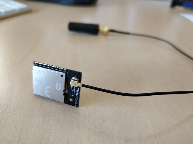

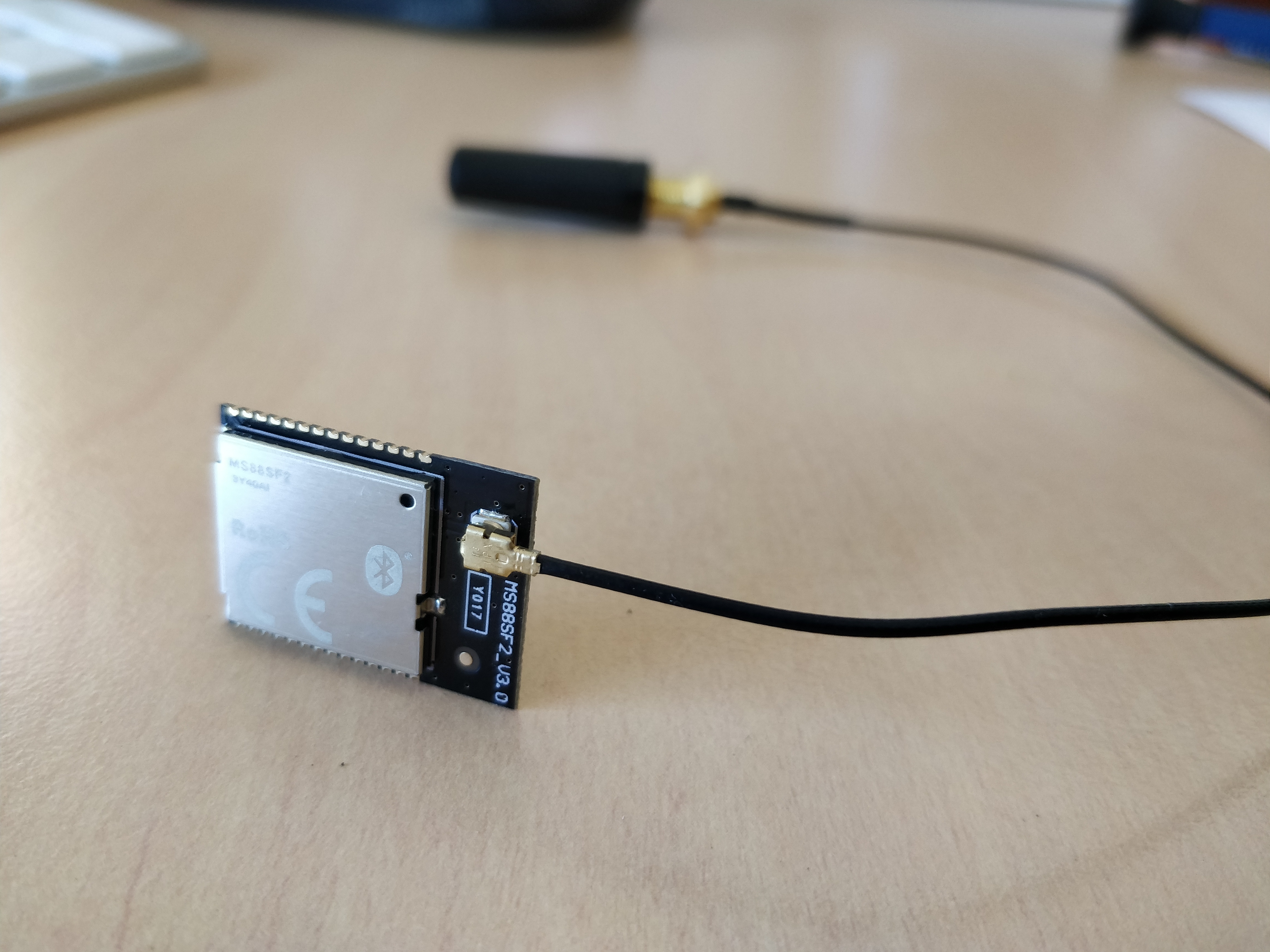

I’ll about to receive the module which will be used as RX alternative with external antenna.
It’s not “off-the-shelf” for now but I designed a simple host PCB to break out the desired pins.
If it works well, I’ll release the files for letting everyone building his own.
Your testing is very valuable to some of us. Keep it up! Link that other antenna module too :stuck_out_tongue_winking_eye:
Evrerything’s received !
Will play with this beauty when back from holidays.
