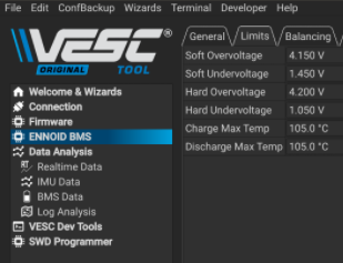

Other BMSs in the “smart CAN” category:
  • FlexiBMS - Affordable, 12s
  • Ennoid - 12s (6-12s) & 24s (13-24s)
  • DieBieMS

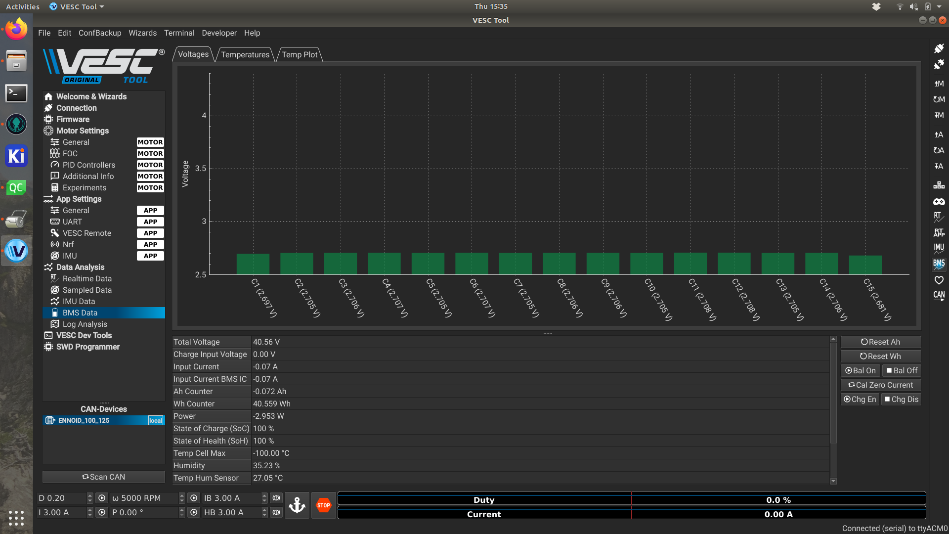

I think once the official firmware releases full BMS support, all CAN style BMSs will work with the VESC. Ennoid made some progress on that recently too.
I wonder if they’ll put it on “sale” then just permanently sell at a reduced price once 5.03 is released and other smart BMS will be able to communicate over CAN/UART

That’s ok, I will live with it. Just that I had to adapt DieBieMS to new VESC BMS commands and not the opposite. Some commands on the VESC for setting the allowed cell upper and lower voltage values are still missing afaik… So, VESC-BMS seems to be feature incomplete at the moment for a complete VESC & BMS integration despite what is claimed. I might be wrong, but I spent quite some time looking at both VESC & VESC-BMS firmware code in order to adapt my BMS firmware to works with VESC over CAN bus. I did as much as I could to integrate both, but I can’t decide on the implementation of those features on the VESC firmware…
