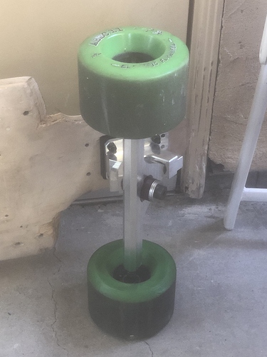

Dude, the only reason your having these problems is because it’s the first urethane wheel you have ridden. Do you want to try out my electric flywheels, I hear they have similar feel
Hey @torqueboards you should send me some pneumatics just a thought.
You haven’t tried the electric flywheels, the unobtainable ones, 74a 64mm contact patch
You see, I am the only one who has them in stock, hahahahah
How do they look like? Got any pics?
