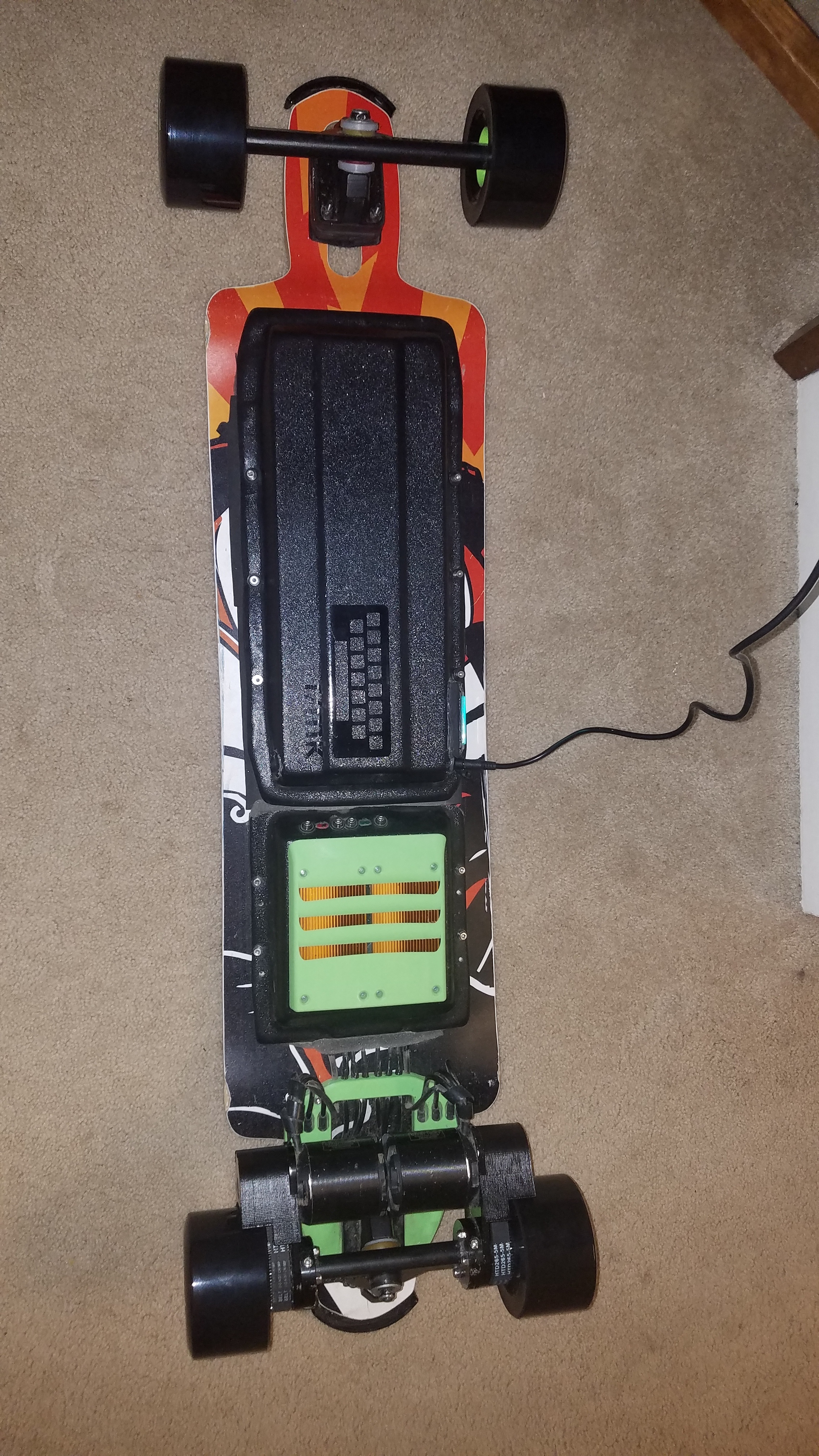

Are you using wide trucks?
You need to tighten your trucks it sounds like?
I have the same setup with no problems.
psychotiller 240, TB 110s but not a short deck 38 inches.
Stance is everything on TKPs, if you feel its not right then that is your problem no doubt.
Mabye, how long have you been riding your 110s?

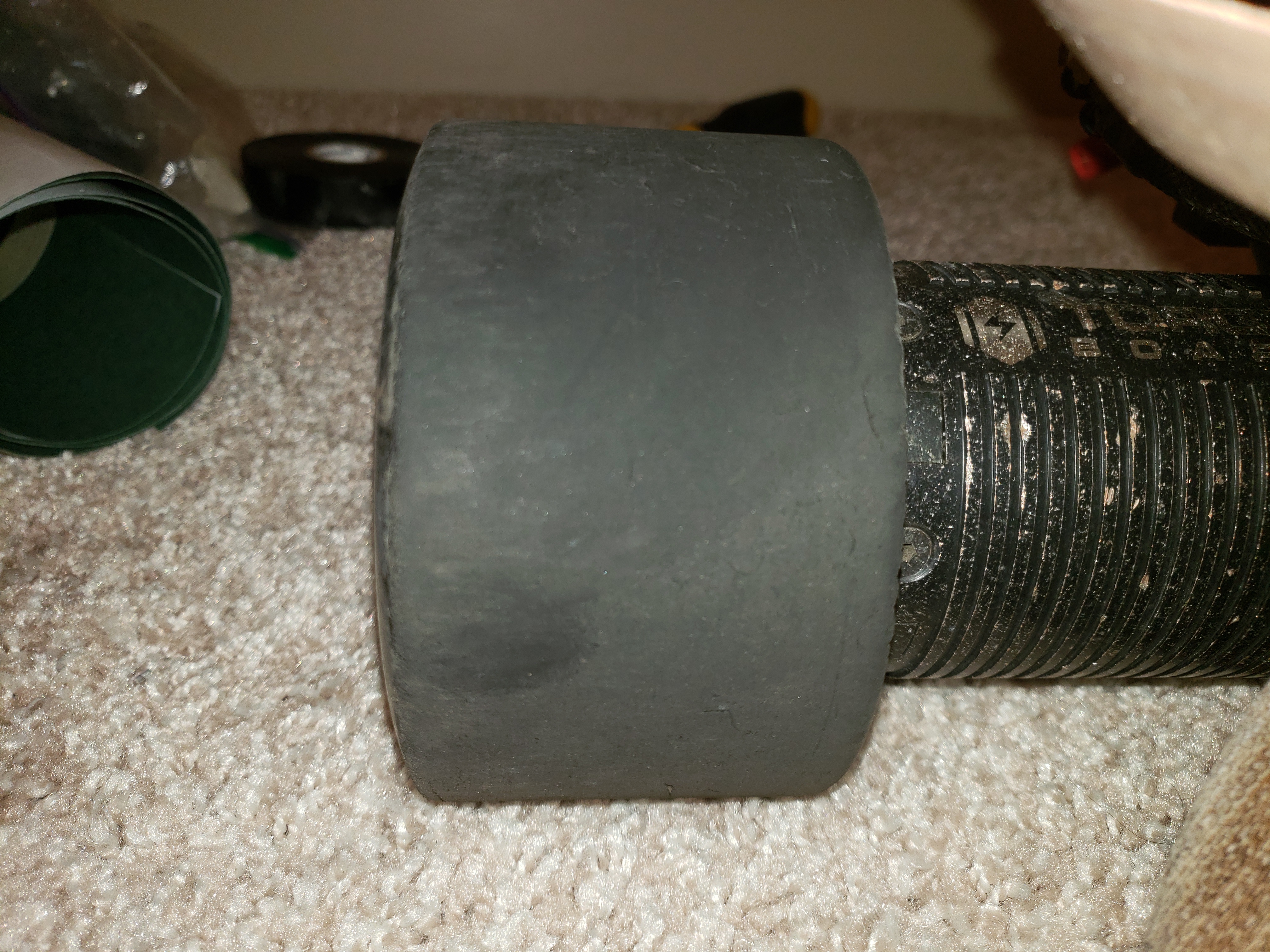

I mean Ive found they needed to be ridden a bunch before really gripping, but in sure @b264 had a better idea on whats wrong.
They definitely kick out more than ABECs, but they recover so well it doesn’t matter to me.
most longboard wheels to varying extents exhibit behavior like this when brand new or still being broken in.
My 107 fly’s did the same thing for the first few weeks… almost took some really bad falls during carving at speed due to slipping out. This is why a lot of longboard wheels come “stone ground” or pre-worn… predictability and no break in period.
Best suggestion I can give you is grind off the shiny layer as much as possible so it’s matte. Either slide the crap out of them for a good session or three, hard carve for a few days to weeks, or spin your wheels while rubbing them with some higher grit sand paper, swap wheels and repeat.
Let us know if you still have the slipping once they are ground down, maybe take pictures.
For example:
Very grippy no slippage
Super unpredictable and constant slippage
I am guessing the shiny layer is slippery because of the mold release? Gotta get rid of that shiny layer!
Polyurethane once cured is generally not toxic, you shouldn’t have to worry about the dust.
With that said, using the wet-method is never a bad idea… maybe a damp cloth with the sand paper between damp cloth and wheels with the cloth extending past the sand paper to catch the dust.
