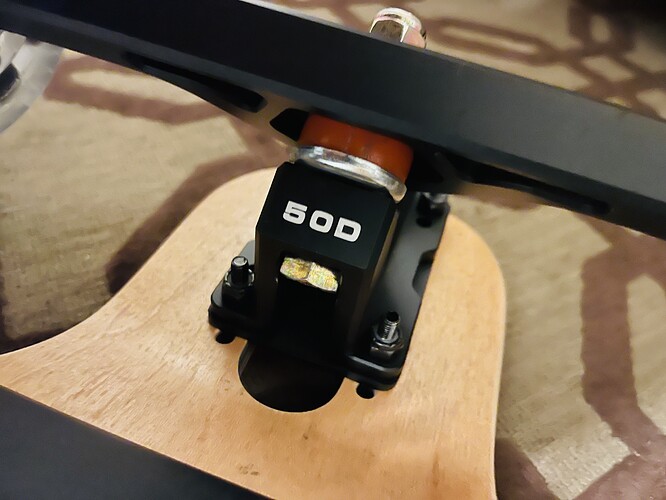

so i got some new ABEC adapters. For some reason on one side, it locks up the motor when i tighten the screws of the adapter even a slight bit. Any pointers?
@Edness - Could be tightness on the bearing. You can add m4 washers between the adapter + motor to get it to clear.

Thanks Dex, that worked.
Another question, both kingpin bolt “clicks” while going side to side. Anyway to stop that and have the kingpin stay in place?
@Edness you need to tighten the kingpin nut to your liking. Sounds like it’s loose.

when i tighten it to the point where the kingpin clicking stops, the bushings are completely compressed and the board can not turn.
I’m referring to the boundmotor DD.
You got a pic of that?

https://imgur.com/a/UQs1mHz
