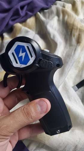

Just out of curiosity, when you turn it on, its supposed to stay a solid red color, right?
Why does it blink when I touch the on/off switch? Could this be the issue?

Yes, unless the battery is low
Yes, the weakest part of the Mini is the power switch.
I use my fingernail and gently slide it on and off. Like that, they seem to never break. Using your finger and jamming it on or off, they seem to break in no time. It’s an art, for sure.
There are tons of Mini mods out there though, if the switch is bad
Okay, I can surely say that it might be the switch. That’s probably bad since I’m very heavy handed and have to constantly turn off the mini due to it just randomly activating my board (I’m that clumsy and will forget its on since I’m so used to thumb wheels) :slight_smile:
are you afraid of opening up the mini… and when it’s flashing do a voltage check across the switch?

also look around at the battery compartments and assorted solder joints while you’re in there
Nah, not afraid. I just don’t have the materials to make it better. I wish I did. I’ll take your advice on the material.
I’ll see if i can fix that switch problem. And at least now I know that if it blinks rapidly, it’s a battery thing.
Hopefully I can avoid this problem again… for the 5th time. I had to rebuild my board with a new deck. I should be fine now.
Oh yes, I think this mod would be great for me.

Edit: this actually fixed the issue… @torqueboards please add a thumb switch on it. It fixes it so well.
Checked the wires as well. It’s good despite being dropped twice.
