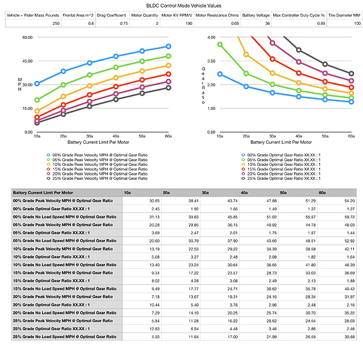

Here is a good graph from @Pedrodemio

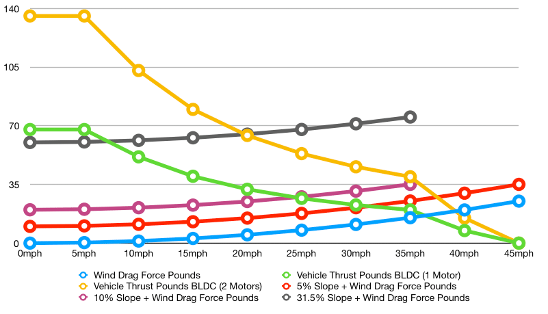

you trade one for the other… in a particular case, this chart shows the difference in thrust between 100mm and 120mm tires:
^the 120mm with higher top speed has less thrust / acceleration

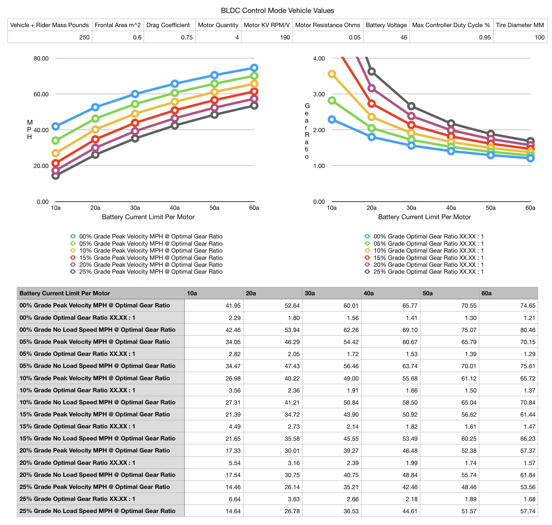

@Pedrodemio @professor_shartsis i have added that in
Can we get this for 10s? I get that its just more amps, but a graph would sure be nice =’)

10S, 2WD:
12S, 4WD:
