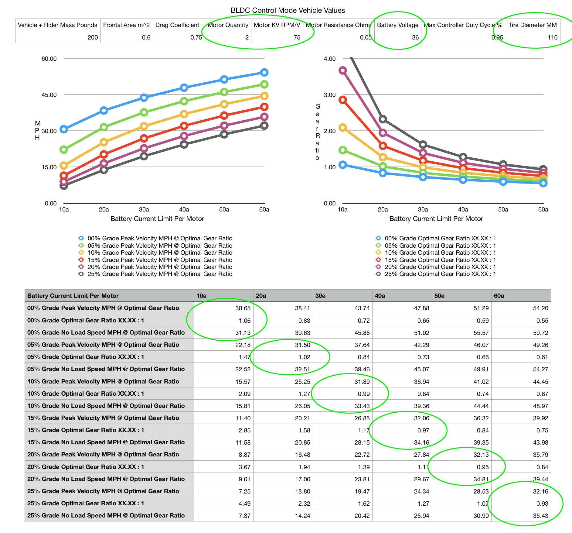

35mph on 20% slope w/ 60a battery limit per motor:

Is there a way for me to play around with this? If not could you show me a 10s, 75Kv, 2wd TB DD w/ 110’s. I know it’s such a small thing to change thats why I ask… Thanks!
^ if the gear ratio number is greater than 1, a smaller tire is optimum-- for example if it’s 1.06 then 110mm / 1.06 = 103mm optimal
if the gear ratio number is less than 1, a larger tire is optimum-- for example if it’s 0.93 then 110mm / 0.93 = 118.2mm optimal
Does anyone know the source of this graph? @professor_shartsis
Would like to plug in 13S, 170Kv, 2WD, 110" please.

Thank you, I was fishing to see if anyone else knows the source. Maybe there is an alternative calculator that is similar?
he uses a custom 10th dimension sheet/script he wrote himself. I doubt anyone can make graphs as nice as these…

Well if you want both then go low kV motors on a 20S setup, geared for the speed you want on your final drive train. I think mostly the limits so far have been the Amp output on Li-Ion battery packs.
Wow how times change. Reread the thread… Who uses 10s anymore lmao.
So the gearing examples are a bit whack now.
But the summary stays the same, to have best of both worlds, you need big motors and a high voltage battery nowdays. This adds a lot of weight though and your board will exceed 25kg very quickly.
