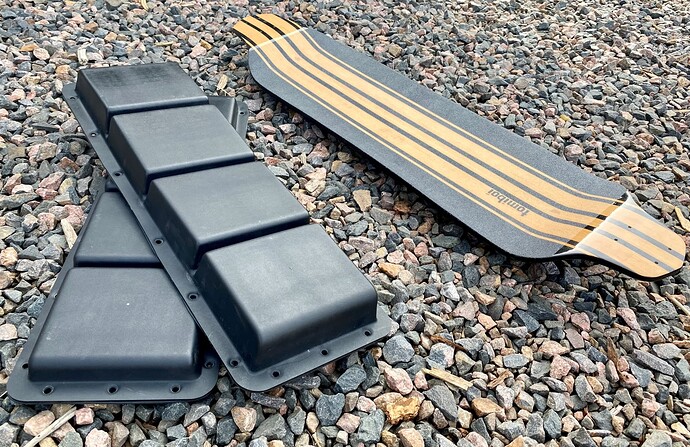

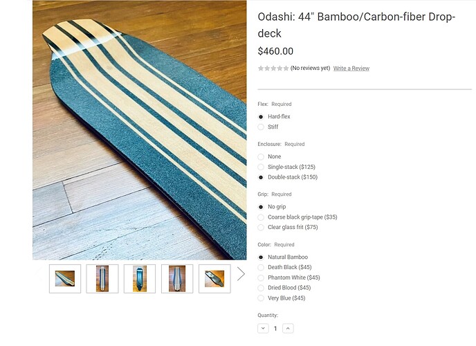

i Want use Ubox V2 and Maximum Cells 21700 withe 16S is 3P or 4P or 5P ?
If you use the double-stack enclosure, you can Do 16s4p with the UBox and BMS inside of the enclosure. There will be a lot of additional room. Also, you might have clearance issues because the double-stack enclosure is thick and the Odashi has a 1 3/4’ drop. You would need 8" wheels.
If you do the single stack, you can do 16s4p in the enclosure, BUT you will have to put the Ubox and BMS in a heatsink box on top of the tail. This will give you and extra inch of clearance. You will be able to use 6.5" wheels.
I hope that helps :slightly_smiling_face:

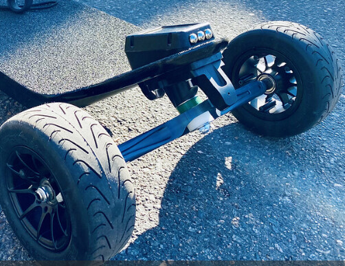

And the Trucks wath is this fore Model ?
Who makes those trucks?
@moon makes them.
Yes, those are Luna 350s from Moon Eskate.
What’s the clearance with 8 inch wheels on the odashi and double stack??,
About 2 1/4”.
Ah ok so it’s still gonna go over speed bumps n such, was worried it’d be surfing the sidewalk on it’s belly if I went 12s8 with it
