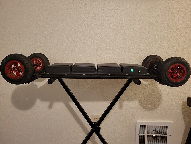

190-200lbs. It definitely feels stiff but it’s so dam long it gets a good bounce. Deflects about 50-70mm when i give it a good jump so I’ll probably get close to bottoming out going off curbs with the double stack, but im good with that.

but for reference, ideally I wanted a similar flex to what you’ve got, maaaybe a tad stiffer so I can fly at 40 with more confidence. and I’m ~210lbs
I feel like this flex is just right for me. Just wish my drive kit would ship but at least i can get the battery and electronics sorted now while i try to act like I’m patient. I need to finish my kids pintail first anyway, i love how carvey it is on urethane.
Yes, that one is 8-ply with carbon-fiber and fiberglass. It should be pretty stiff… if you weigh 175. At 200 if should have some flex to it.
The extra layer of fiberglass that I put on yours looks like it did the trick. Bouncy but not rubbery.

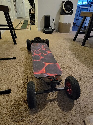

Got the Odashi up and running, it’s dubbed the DogeGT :laughing:
She lives! Just love how easily the @tomiboi stuff comes together. Now just to figure out the truck angles. Thing won’t turn at all right now…
Also a bit concerned about the motor cans making contact with the baseplate adjustment. I remember having this issue when I first started my Evo build and the angles had to be very specific. Hoping I don’t need new trucks.
Any suggestions for what truck angles to run on a tomiboi MTB? I believe it’s a 30 degree angle for each side on the deck
You want to make your rear drive trains kingpin at a roughly 20-30 degree angle for max stability and front like 40

POM for sure would not, the Oil Filled nylon in these will :smirk: this one been around for a while, 3Ds stopped making this particular GD in 2020 lol almost 3 years old? :crazy_face::crazy_face::crazy_face:
But yeah all you need is the adjustable bases from BN and you should be set :sunglasses:
I’ve got the adj. baseplates thankfully, just need to try the angles you suggested. Should be ok for this deck?
I’m not sure how much adjustment there is in those bases, but I think they have enough to make it rideable atleast
