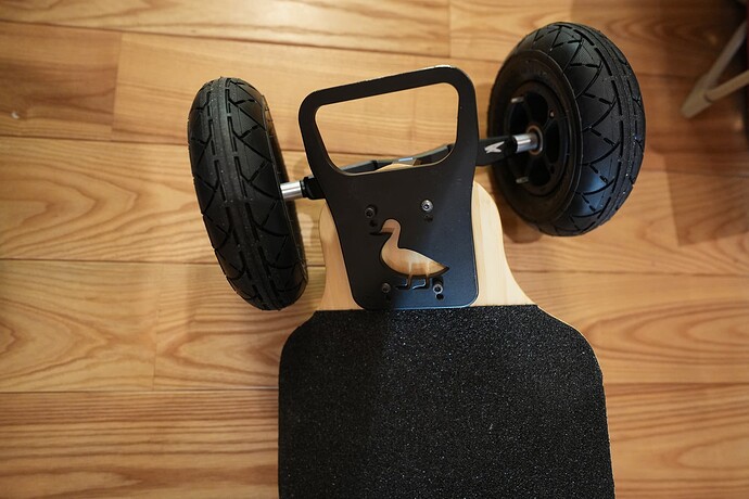

Hey folks! Thought I’d share a sneak-peak of an upcoming build I’m doing based off the Tomiboi 35" MTB deck!
TL;DR: you’re going to need wide trucks to run pneumatics on these decks!
My thought process was that if I reposition my RKP trucks far enough away from the center of the board, I should be able to lean without getting any wheel-bite. To achieve this, I reverse-mounted my trucks thanks to some Bowery Surf adjustable baseplates that allow for negative angles, so that I could still get an asymmetric split. I tried this with my 200mm Surf Rodz RKPs, and here are the results!
As you can see, even with 8" wheels, the adjustable baseplates stick down quite a bit, and I believe that with the enclosure on I’d have like 1cm of ground clearance :sweat_smile:
I also tried my special narrow Luna 290mm hangers (with the baseplates oriented normal), but those got some wheelbite with 6" wheels. So Luna 320mm it is!
Edit: actually, maybe I’m being too critical on the 290mm trucks. Guess I’ll reassemble the board with those and actually stand on it to check. Maybe I can make it work…
Edit 2: Nope, unless you’re used to riding Lacroix boards that don’t turn, 290 hangers are a no-go with this deck.
30 degrees though (so baseplate at 0) does work actually, so if someone likes a 30/30 split then go for it. I’m personally just gonna get the longer hangers though. Tried with an additional 15mm spacer and it makes all the difference.
P.S. These dual duck handles are really nice for carrying the board actually :thinking:
With the Luna 350s and Moon’s 15 degree baseplates you can run 8” tires on that deck. I like using the furthest trucks holes for that set-up.
I ran into the same problem with my BN270s. I grabbed a pair of Luna 350s that should work great.
I’m glad to hear that! Means all the 8" tires I bought recently won’t have been a waste of money :sweat_smile:
