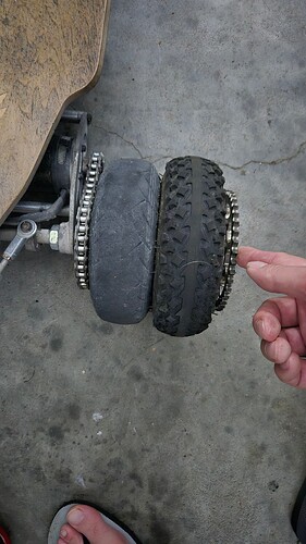

Did you ever do this? Or know if there is one out there?
I wanna stretch my knobby 200x50s more to try on the Llama!!!
How wide are you trying to go?
Nothing crazy dude. Maybe 5 more mm…
They already stretch the knobbies pretty well…
I just want Moar…
