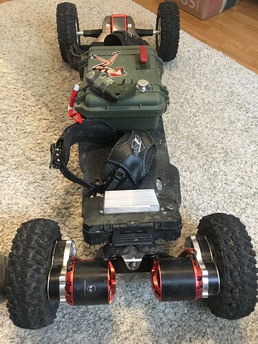

may i ask which motors youre running on 16s?
im planning a 16s build too and right now im looking for nice motors for my mountainboard build
KR and thx very much
I was originally going to use Maytech 6880 180kv motors, because I figured that a 33% speed increase would be fine (they used to have a 210kv model I believe), especially if I set my max duty cycle current limit start to a low value for safety. But then I heard good things about some upcoming motors, and planned my build around 8mm shafts instead. Still waiting for them to be released so I can buy a pair…

im going to make a 16s mountainboard build with the ubox and to be on the safe side regarding the motors ill go for APS 8085s 130KV (maybe ill go higher) which are rated for 15s (etoxx 1:5 gear drive)
so i think to be on the save side for now bigger motors are a good way to go on higher Volt setups.
Maybe future motors will handle those high voltage setups better
Totally agree with you i also dont wanna swap out motors frequently because they cant handle the amps and get too hot.
For me the point why i want to do a 16s4P setup is tht i get mass of torque and still can run this thing up to nearly 60kmh (228 mudplugger wheels)

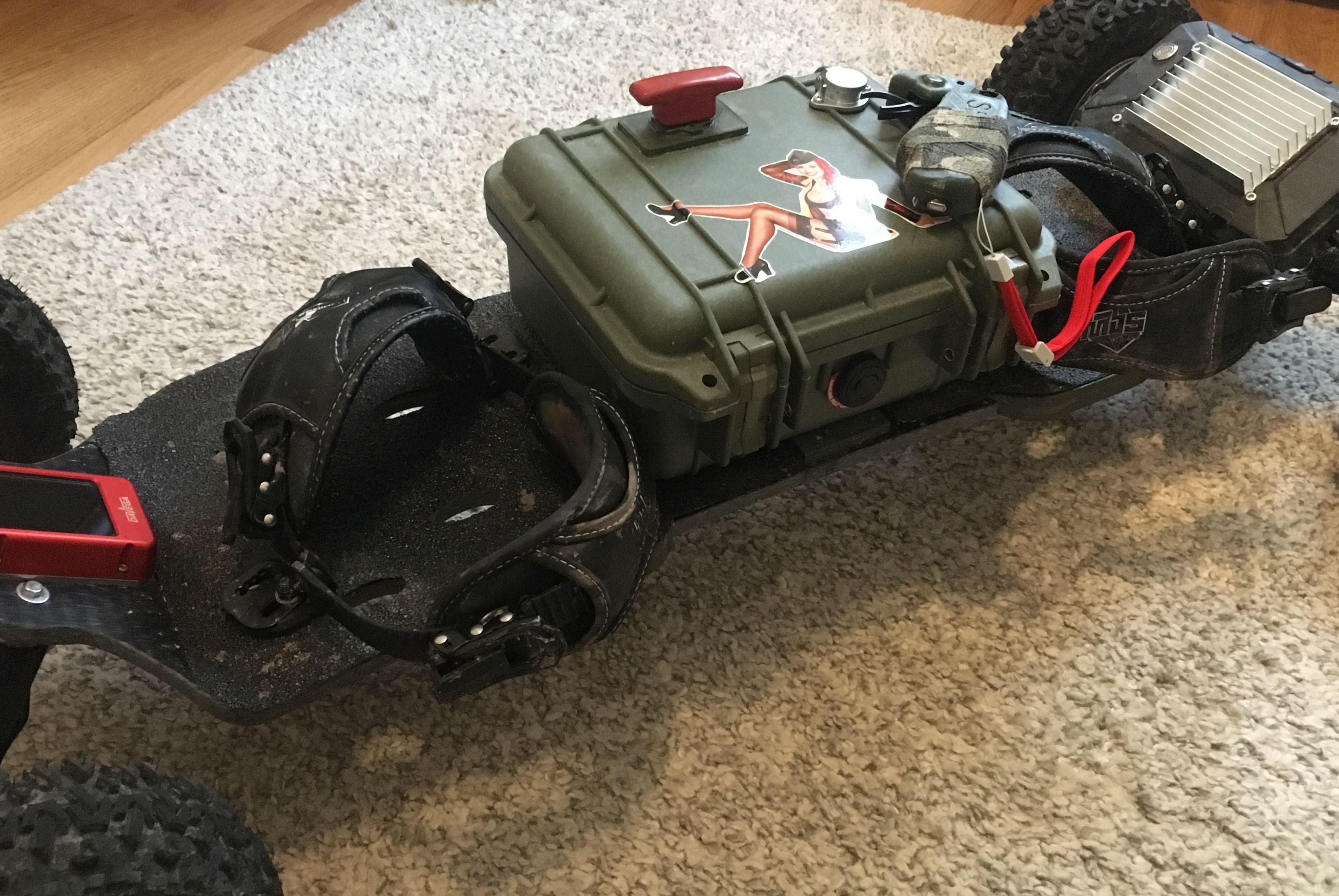

did you do you build ?
Yepp its done
I finished it last week and now im fine tuning it
The 16s setup is really nice i have lots of torque and can go up to 60kmh (i never did)
Right now i need to balance my wheels and add a stiffer setup in the back as im getting wobbles at 40kmh
