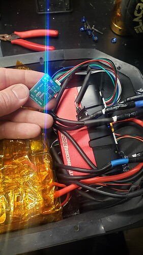

I built the battery in 3 lumps, 2 x 6S and 1 x 4S, this allows me to test the spintend at 10S, 12S and 16S. Ill probably charge these individual packs on my hobby charger for now even though I do have a 16S BMS and charger. I think this will be my test board going forward so I like having the options available for different battery configs

I have the drivetrain ready and 16S battery just needs some leads to attach to the UBOX.
