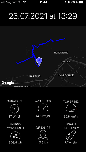

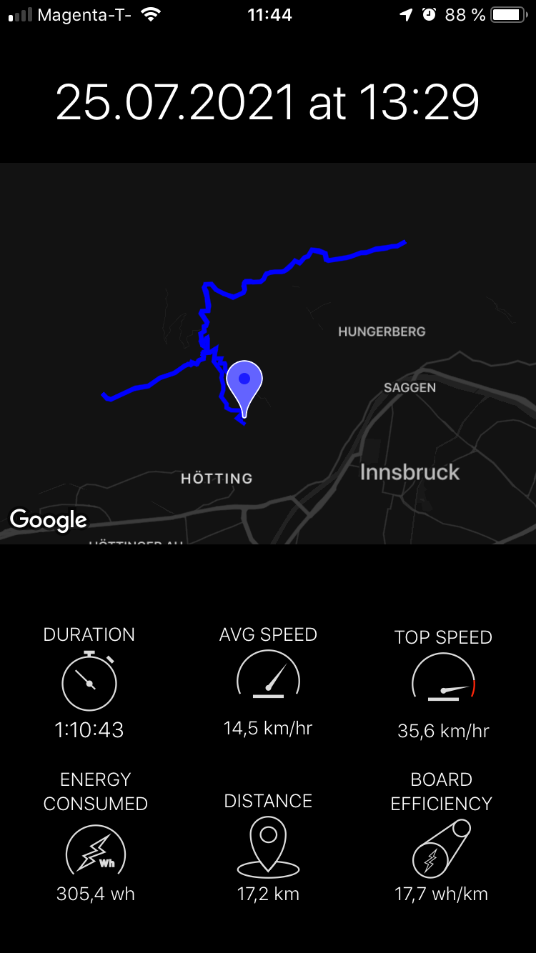

I only have this tracking right now
We made a uphill tour in a mountain here in austria
The motors were just slightly warm and ubox had 37degree as far as i can remember from the real life data of the app (it was not a hot day) the heat sink seems to work well
I think you need to double the wh because the bluetooth dongle only records one side of the ubox

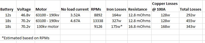

Here is something interesting I saw on the bench today:
I measured this with an external shunt type meter at the battery. Same ESC
95% duty cycle, no load current on a 63100 190kv motor from Torque Boards.
12s 190kv - 3.52A @ 46.8v = 164w
18s 190kv - 4.67A @ 70.2v = 327w
So it takes 163w in waste heat just for the privilege to run 190kv on 18s at full RPMs due to iron losses.
What about copper losses? High Kv motors have lower resistance so have less copper losses at the same current. If we assume that iron losses match RPMs when the motor is the same size, and we choose a motor that reaches the same RPMs at 18s as a 12s 190kv motor, then we end up at 130kv.
Using the resistance values from the Lacroix motors, we can calculate copper losses at 100A
So if two dual motor boards were geared for 40mph top speed, and both drawing 100A at full speed, the 18s 130kv setup would be putting down ((455-343)x2=) 224 additional watts to the wheels compared to an 18s 190kv setup. The 18s 190kv setup would be pumping 224 more watts into heating the motors vs the 18s 130kv.
I don’t have a dyno to test all of this in the real world, but I think it’s why companies who do have some sort of dyno choose 130kv for 18s and 190kv for 12s. Longer range, less motor heat and more power to the wheels… however this is all at full power and full RPMs. I wonder if running 18s 190kv at 50% duty and 20A would be more efficient than 18s 130kv at 50% duty and 20A.
Need someone smarter than me to double check all this lol @Dinnye @Pedrodemio
EDIT: Wait… if you used the ā€œExperimentsā€ feature in the VESC tool, and checked iron losses at say 5% duty cycle steps for various motors, factored in the winding resistance, then figured out how many mechanical watts are needed to overcome the rolling resistance, wind resistance and hill resistance, factoring in gearing for torque, you would basically have the esk8 equivalent of the Grin motor simulator.

Those looks about right
Makes no sense running a 190 Kv motor at 18S, for them to be efficient at that point you have to run them at a power level far above what can dissipate
The dyno part is kinda yes kinda no but I haven’t got to the point of building one yet, while those analytical calculations get close, everything changes in real life, copper resistance increases quite a bit with the motor at boiling point, which isn’t uncommon with some riders that really push it, you can add 50% more resistance at least, magnet flux goes down, so your motor Kv is actually changing all the time and so on
But the biggest twin a dyno allows is to make a thermal model, with that you can really predict quite well what will happen, like the trip simulator from Grin do, you can even input our motors there with just the measurements you took, it’s just the thermal model that is lacking, but you can also approximate from some data they have on eskate hub motors and real life rides, put a path you know and have logs and compare
https://ebikes.ca/tools/trip-simulator.html
comparing the output power to make it fair the 18s 190kv is 46% faster rpm. That’s 46% more power with only 32% more losses making it more efficient than the slower setup at that high power output
Even at lower power output the faster motor can be more efficient. The only time i think will end up less efficient is at low power output and high speed.
Torque to heat is the same for all motors of a certain design as long as the same amount of copper regardless of kv. High kv is low resistance but low kt and low torque and it all balances in the end.
I think the big variable in the comparison is when the 130 kv magnetically saturates first, which it will. Assuming it saturated at 68 amps and the 190kv at 100 amps…ultimately u have the same (efficient) max torque output there and the high kv motor has more rpm to convert to torque and can produce higher max torque or power
