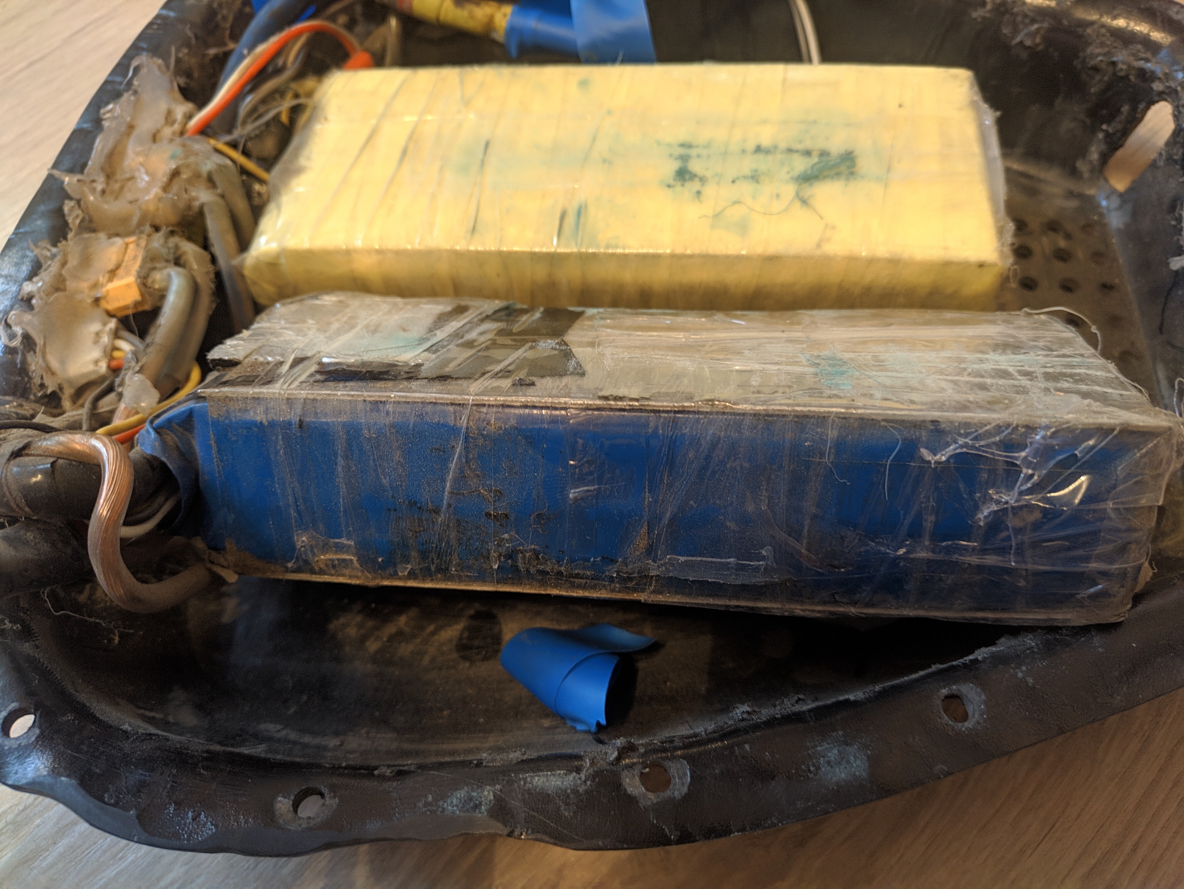

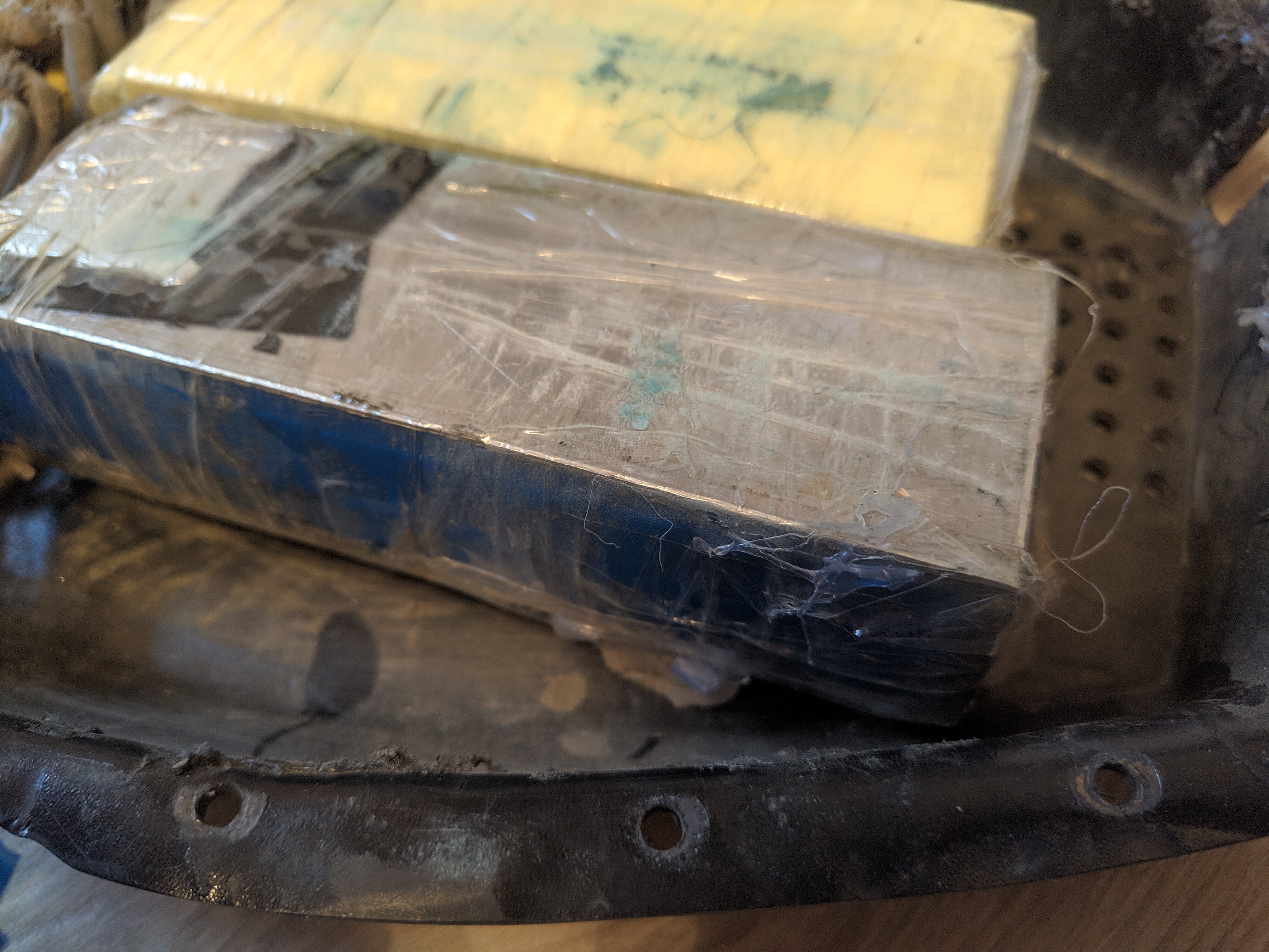

Sure, here is photos:
Measured lipos dimensions, ordered plates (its really cheap) and tighten it with duct tape for packaging
