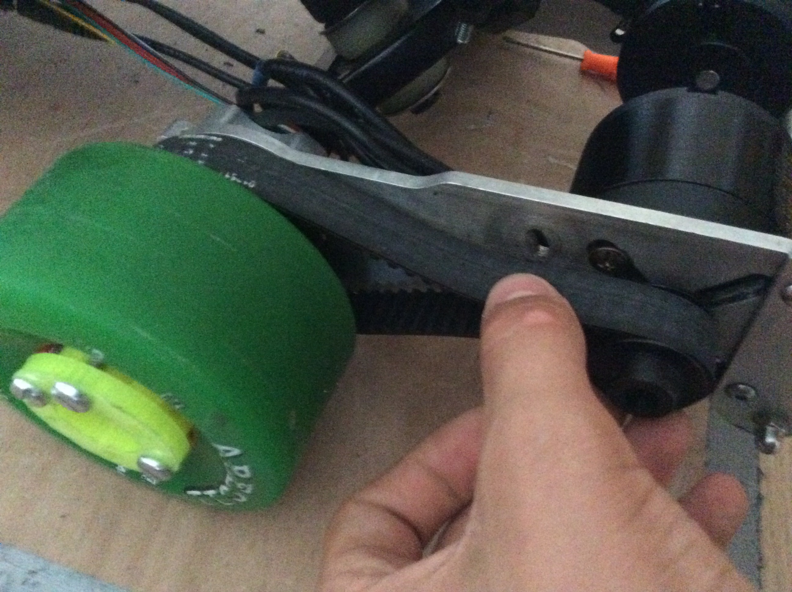

He’s using 60t wheel pulleys and you have 40t.
Can’t tell but it also looked like you’re using one idler on each mounts not two.
Here are pictures

Why aren’t you using both idlers?
Cause he recommended with 1 idler to use 400mm belts with my pulleys
I will try with two idlers now and see how it goes

I wouldn’t do that on those mounts.
Your idlers on those mounts are your only form of adjusting belt tension.
This is an idler versus a non idler mount.
Notice how the non idler allows the motor itself to be moved up and down the mount.
I would go down to like a 380 belt size and also where is one of your motor screws?
It looks like your belt size might work with dual idlers. Might be worth a try before buying more shit.
But yeah you want the belt to slightly deflect when you push on it as hard as you can, any more slack than that is to much IMO, i know you can get away with a bit more on idler mounts.
Next question, how did you not realize that your “weak braking and acceleration” is literally because the belts aren’t engaging the motor and wheel teeth?

i realised something was wrong with the belt but when I bought this kit the guy was insistent that 400mm was the right size for this mount
The thing is though is if you did a decent amount of research about esk8 you would have realized the moment you put it on there something was wrong.
Your belt is comically loose.
Really looks like the second idler would fix things tho

Those are some super long motor mounts! I think you definitely need the 2nd idler, because otherwise there’s too much space for the belt to slack, meaning it’ll either skip teeth if the belt is too long, or be too tight for a smooth free-roll experience if the belt is short.
Belt skipping can easily eat off teeth from your belt (i.e., ruining it, causing you to buy a new one), and also damage pulleys if they’re not made from strong material like steel. Definitely don’t ride your board around with it making sound, will just end up costing you more.
