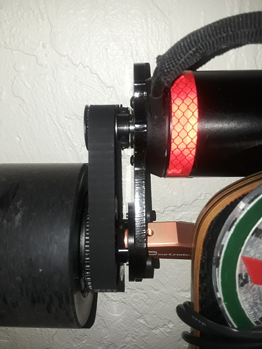

How are you getting on? In those photos your motor cables are far too tight and your wheel pulley retainer is looking a little funky? You also need to insulate the motor bullet connections, heat shrink after connecting them.

So I just tried it round my area and everything was smooth except the braking which is loud And weak still
Settings were changed but it is still not strong enough also the noise is loud and sounds like the belt I should skipping lots of the teeth
Is it worth trying it using 2 idler pulleys instead of one
Anyone know how to help

Your belts are huge, your tensioning is completely off, you definitely need to fix that
so I am running 400mm would should I go down to
Take a picture of the idler/mount how many teeth are your wheel pulley and motor pulley
400 is something you would use for a mountain board, you definitely have the wrong belt size
so it is a janux mount which is probably meant for a mountain board but I am using it as a street board
it is 40t and 15t pulleys with a single idler
the guy I bought it from recommended this size

Try 320,325,330,345
i don’t have the money to buy so many belts
eitherway it is a near fit so it is probably a 395 or 390
I asked for a picture because it is obviously not a close fit. I want to see your belt setup
will send when i get home
Get a piece of string, wrap it around the pulleys, measure it with a ruler, compare the offset to a known belt. Perfect belt length aquired
